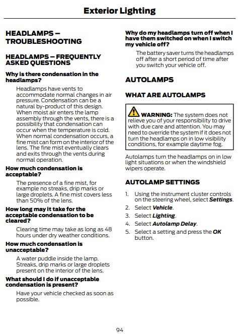

It is more like a fine mist instead of a puddle so I guess this is just a feature not a defect :giggle: .
Which reminds me that I haven't yet driven it at night so headlight have never been turned on since I've taken deliver of it 2 weeks ago.
Still can't hurt to run it by the dealer and have the service department take a look at it, I'm just saying
