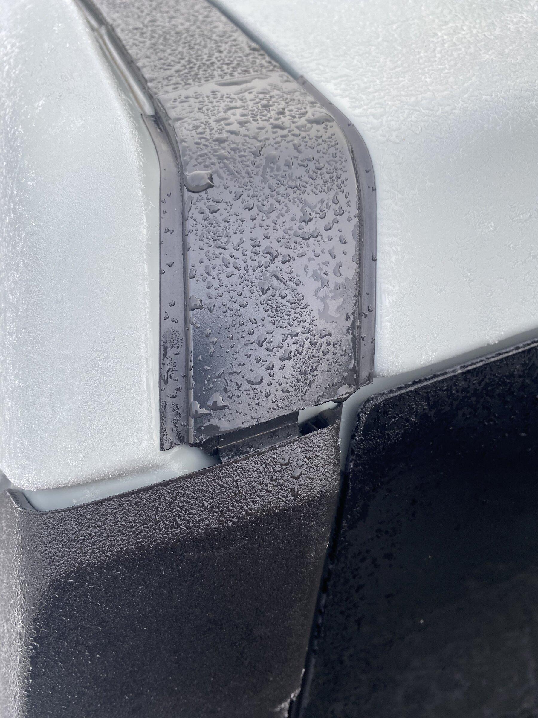

So, I could go to my local dealer to have this addressed, but I’ll be moving soon so I don’t need the timing stress. On the top of the passenger side cab are two little strips of weather stripping which just randomly terminate. One of them is just kinda flapping in the wind.
What would you recommend here? Is there an adhesive you would recommend as an interim fix?

There's got to be an adhesive or something behind the ones staying in place
Old Ranchero
Apr 1, 2021
2,587
3,511
CO
my Go-To is Permatex Black Adhesive Sealant Silicone RTV #81158. Got mine at Wal-Mart for like $6.00. Other auto places carry it as well. (y)

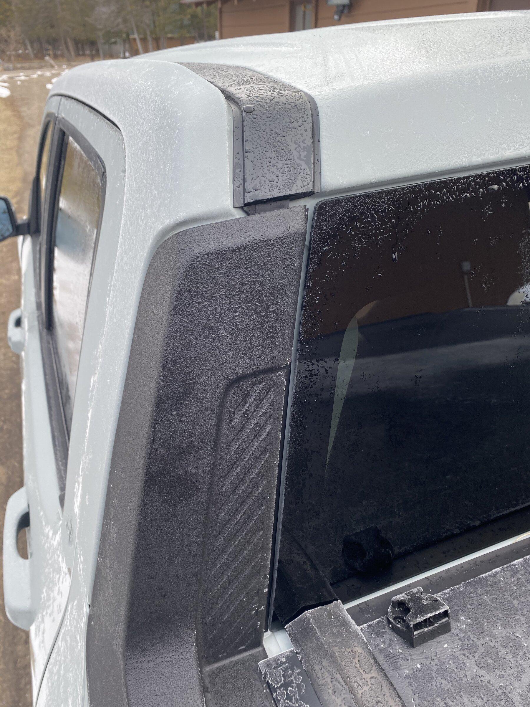

I experienced a similar issue with the drivers side. I just got back from having it fixed at the dealer. The part was delivered in 2 days. It took about 45 minutes to replace the molding.

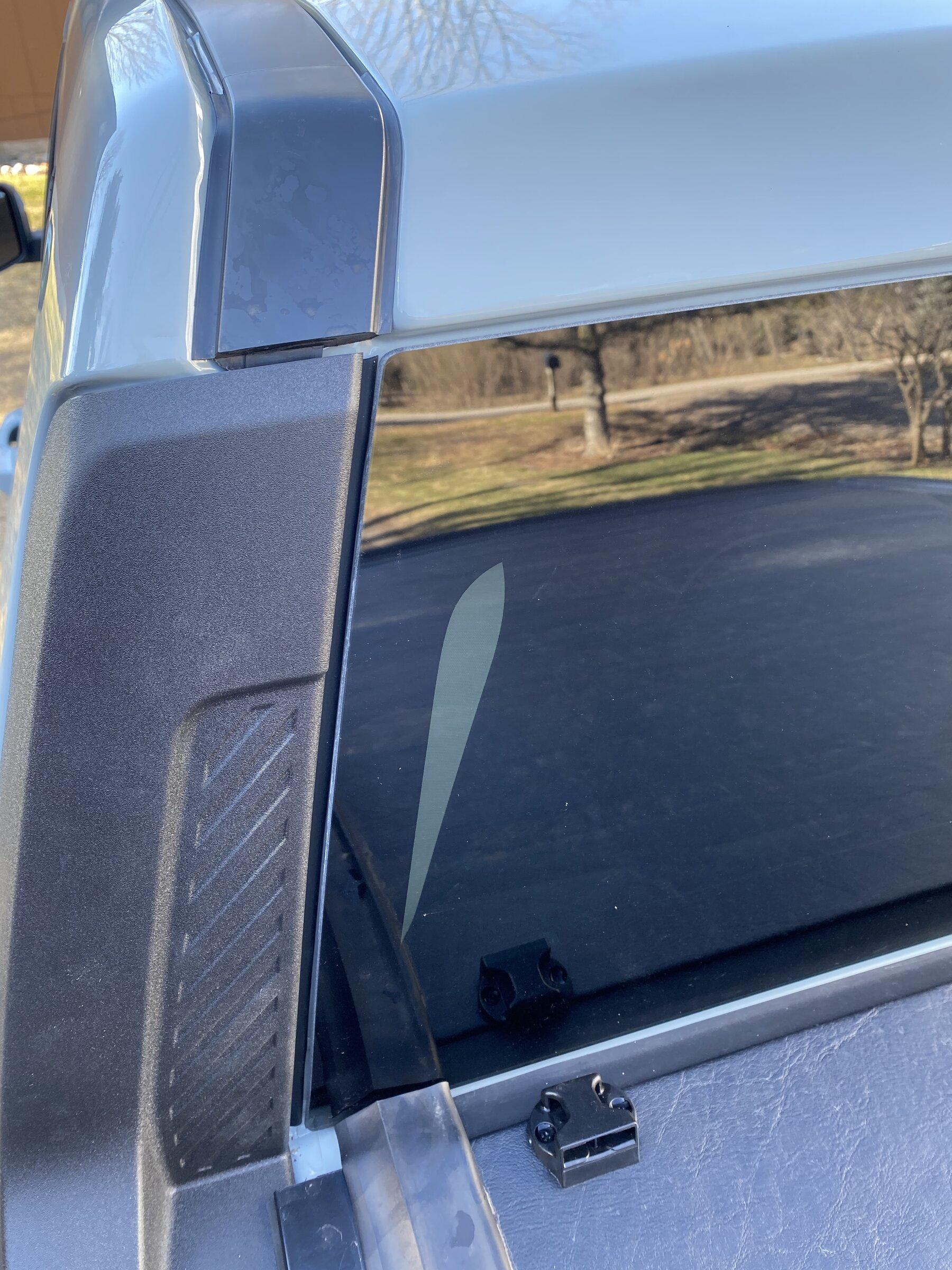

Fixed 👇🏼

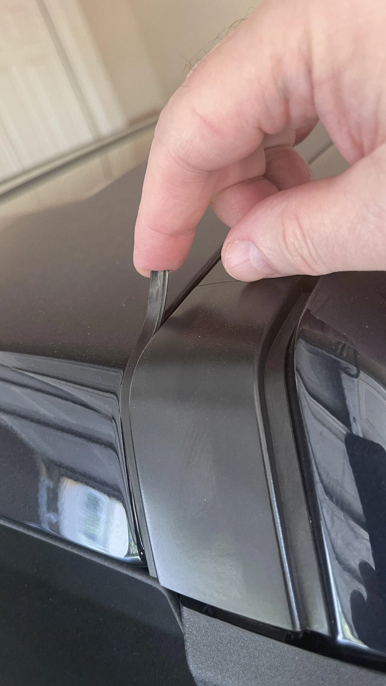

I wound up using just a drop of Permatex Black Adhesive Sealant Silicone in the interim and it solved the problem for now.
