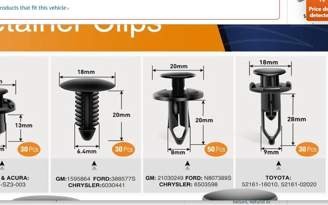

I have quite a bit of trouble finding specific part numbers for my Maverick and now my go-to site seems to have gone down.
Anyway, I broke a couple of wheel well liner plastic rivets when putting aftermarket mud flaps on so I'd like to get some more. You guys know a part number for these?
Pic just as an example. While we're on the topic, where do you go to look up parts?

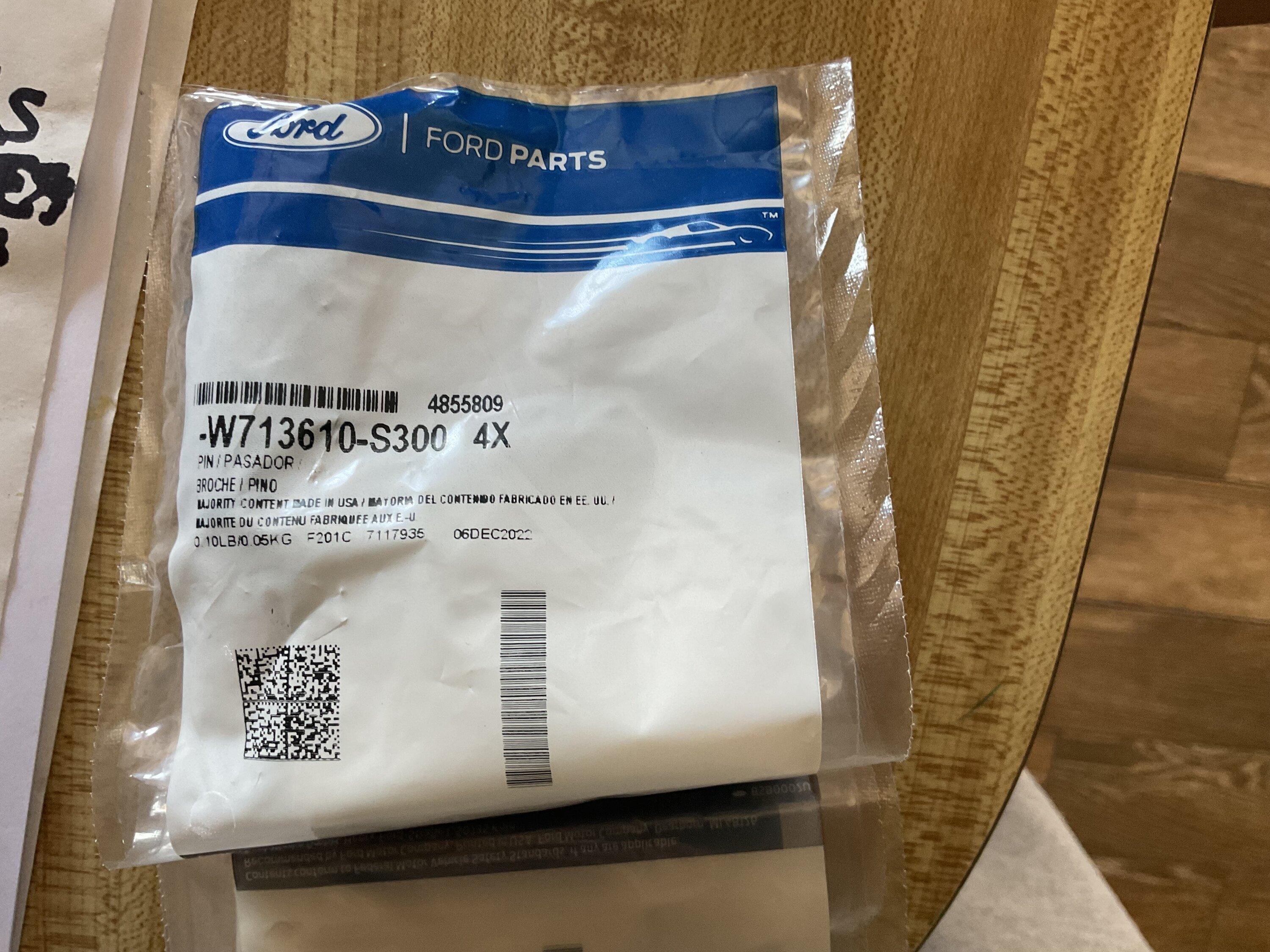

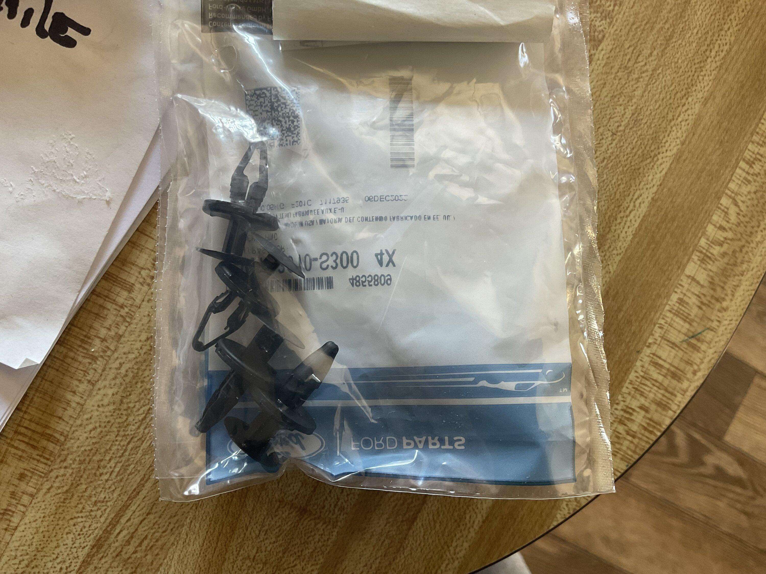

Here is factory stuff for one of my rebuilds
12 for like 19.30$ so better to find the box of Amazon mix for 20$
Thanks for the photo. I googled the part # W713610s300 and found some on ebay at $7/100.
Not to be a debbie downer, but I just pulled one of these off the wheel well, and measured the hole, which is .325" or 8.25mm. The ones you linked appear to fit a smaller hole.
HRG
Not sure what you mean, since my post didn't link to anything specific (couldn't separate my personal info from the item). The one's I found (try item # 223585869421) look identical to the ones I pulled from the mud flaps, they claim to be 8.5 mm wide (although another ref says they fit an 8mm hole) by 21.4mm long. I ordered some, so we'll see.

You won't have any problems getting the 8.50mm ones (flexible plastic) into an 8.25mm hole (metal).
0.25mm is only .011"
Thanks for the ebay item number. I thought you Googled the Ford part number in your posting, which appears to be for a 6mm hole.
