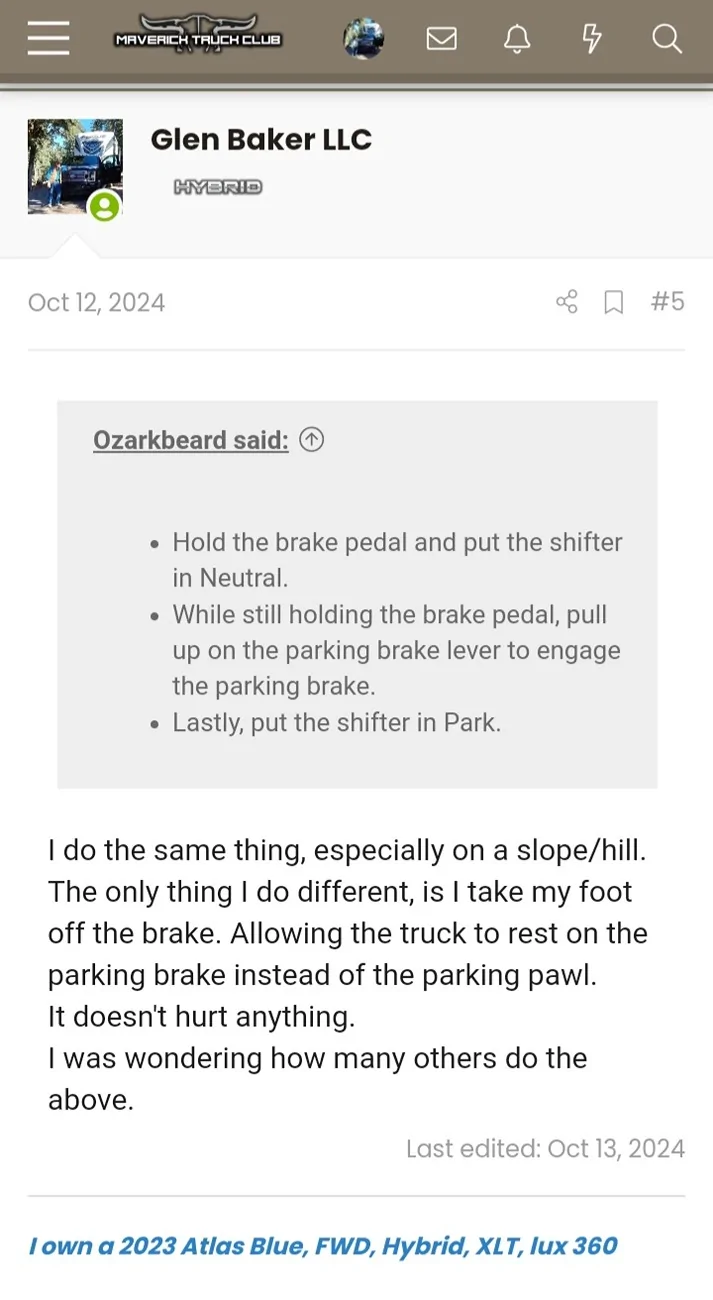

Mine is early 2025 AWD Hybrid, & I don't recall EPB engaging automatically on a slope. I did have the Park Recall done. Advice from Ford, always engage the EPB first, especially prior to having the software recall completed. Procedure, after stopping, still ON, foot on brake pedal, shift into neutral, engage Parking Brake (yes you can hear it), release brake pedal & verify Parking Brake keeps truck from moving, then press brake pedal, shift to Park, turn switch off.
Ken,
I posted about doing this same procedure that you posted about back in 2024 👍
