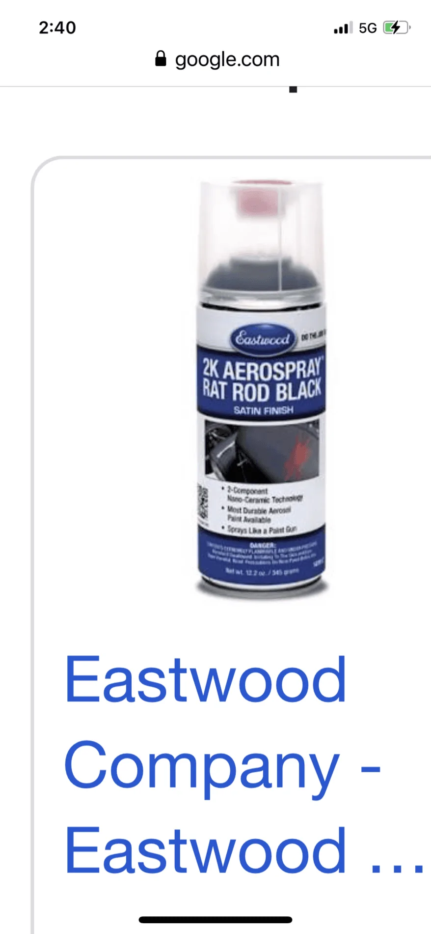

Powder c is your best option but you can used 2k paint which is a rattle can paint with the hardener in it you will get a pro finish and durability and a lot cheaper than pc.
Ford Maverick Painting XLT Wheels Black? C1747320-0678-4483-A4D4-6E420B62774C
