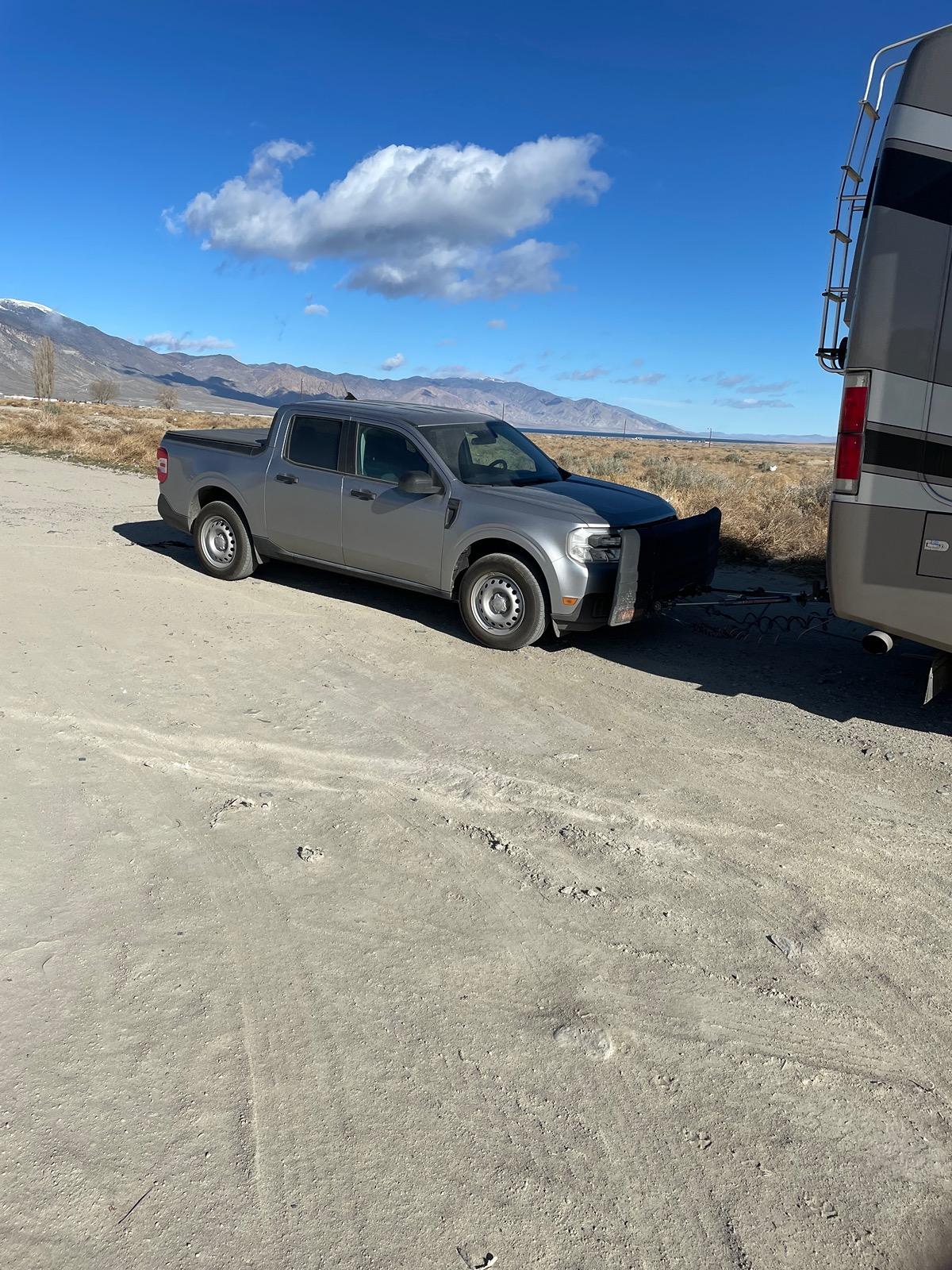

Many
I use a Roadmaster rock guard that attaches to both my trucks haven’t had a chip yet in 4 years.
