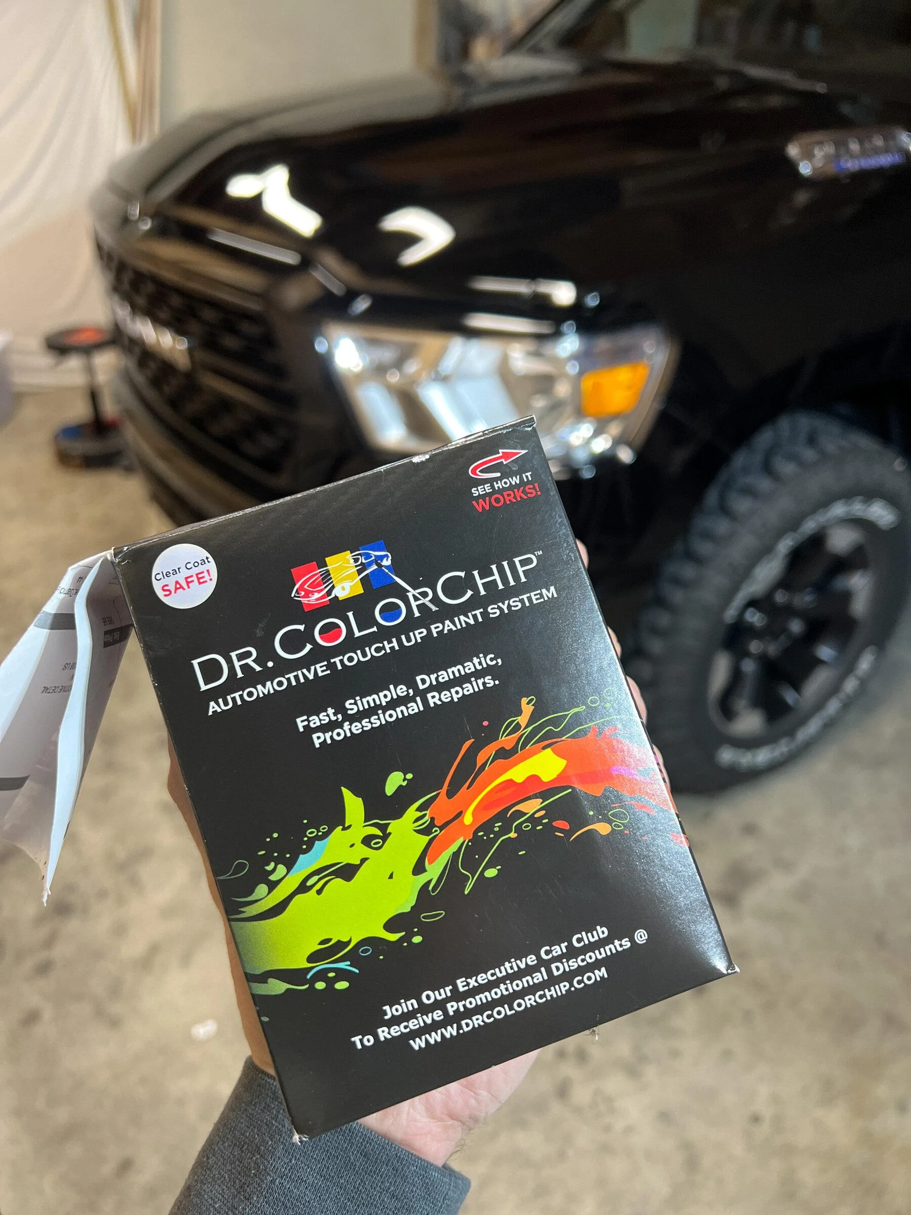

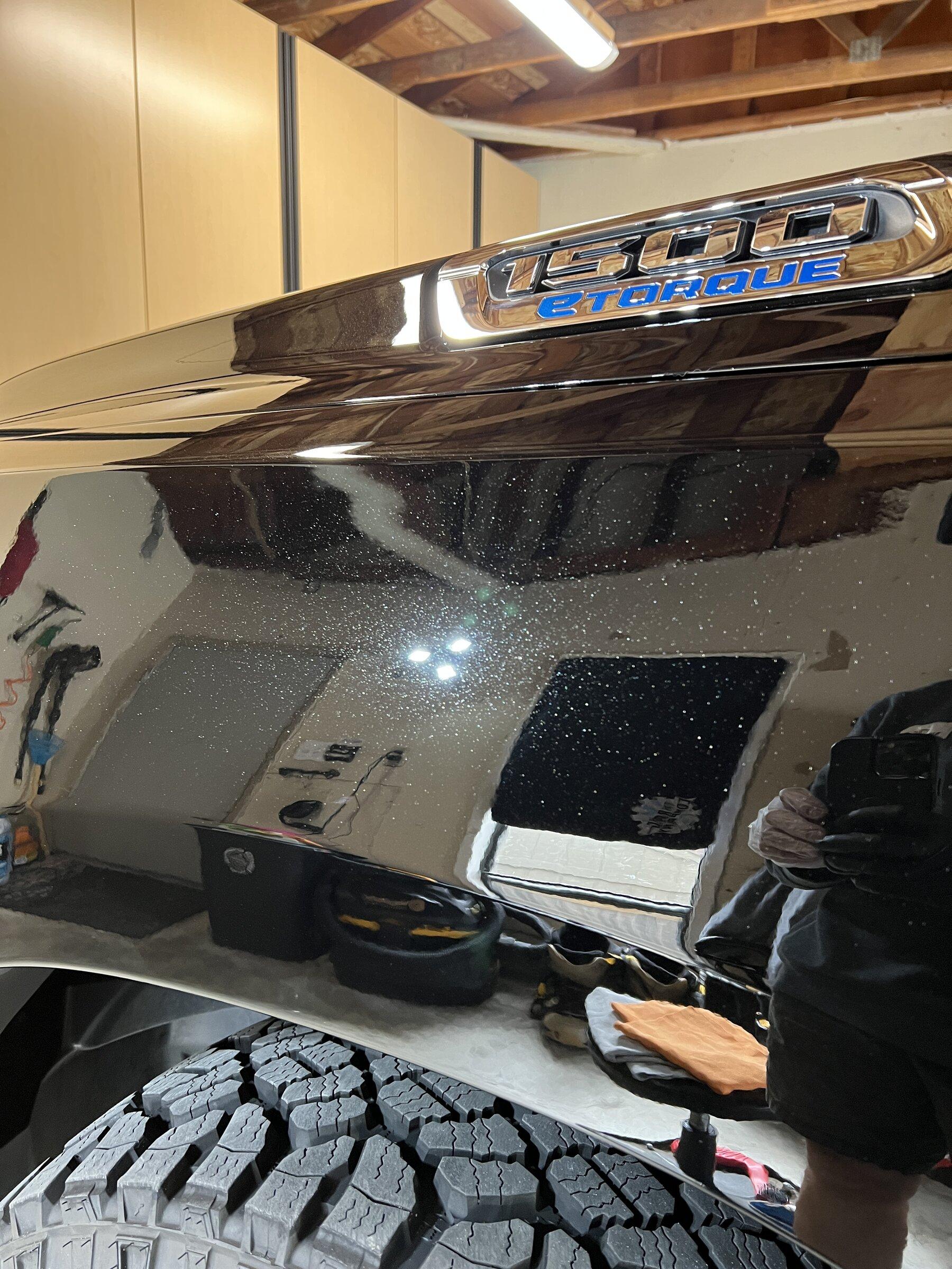

I might be biased being a trained technician but I only repair rock chips with Dr. Colorchip. I’ve tried OEM paint pens in the past and have had really mixed results.
Find your paint code or type in year make and model and they will do the rest.
Paint is OEM, made to match, with the clear already mixed in. Plenty of different packages to fit your price range but I recommend getting the Squirt and Squeegee Plus so you have the tools for future jobs.
(This Dodge Was Diamond Black Crystal and the touch up had beautiful diamond metallic crystals in it. Was a perfect match)

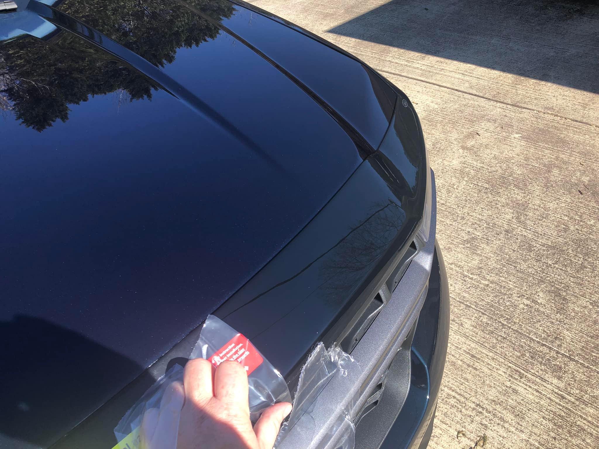

I took a trip from Alabama to North Dakota and back, highway driving. I had 5 chips to repair on the front edge of the hood. I covered the chips with touch up paint and also bought the hood protector, which I haven't put on yet. I figure I will deal with the chips with paint until I'm ready to install the protector someday. The protector is form fitted to the contour, so in my opinion it probably won't do much as deflecting rather than just covering up. What I might do it wait for a company to produce the upright version of the deflector for the Mav. There is a company that makes one for the Ranger that's mounted upright.
Check out AVS Bugdeflector II Bugshield. Realtruck sells them. Seems to comer the edge of the fenders too. Very few pictures online. A couple in the forum have them, but hard to find. Pictures are only from the front.

Thanks for the tip. I just ordered. Get my truck Friday so the timing on this is great!
