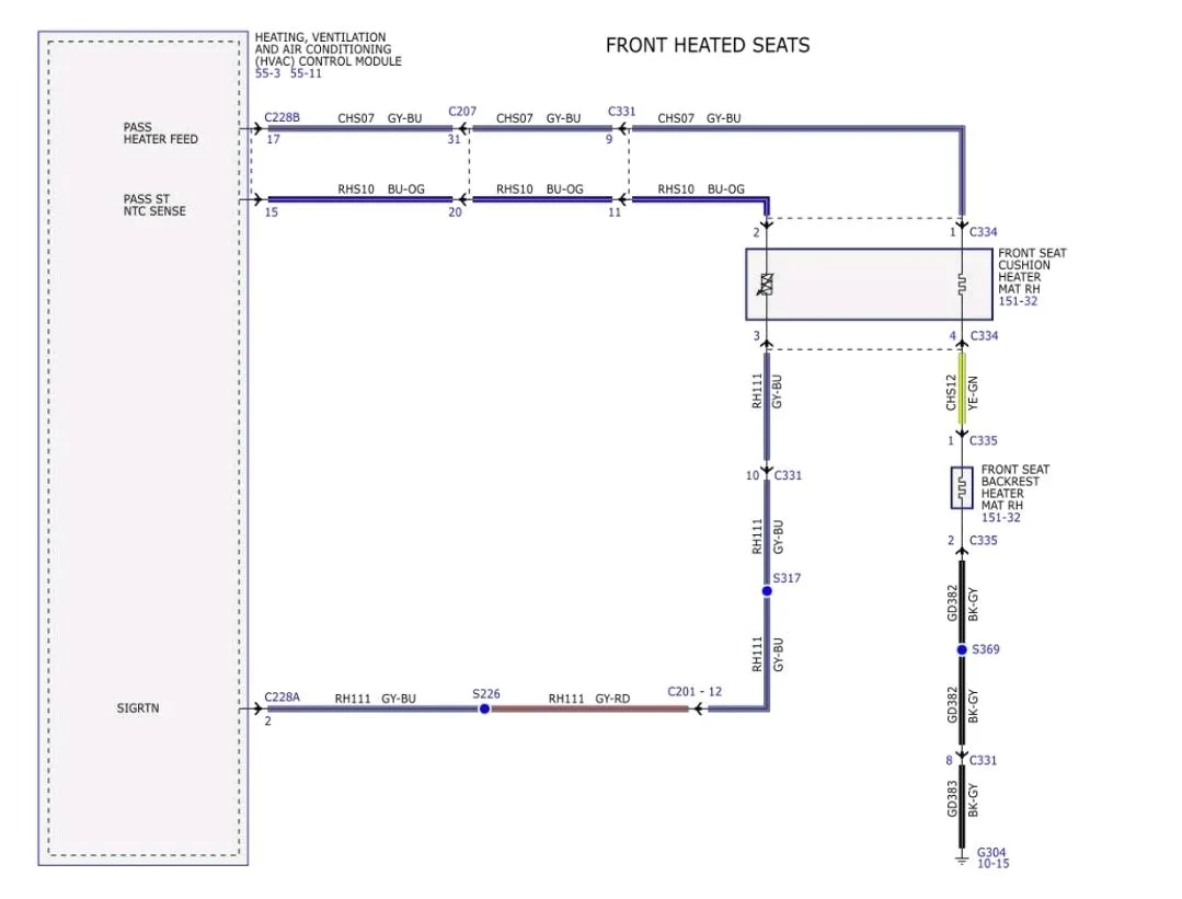

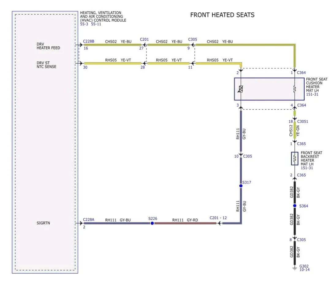

I've managed to find a wiring diagram that is supposedly for the Maverick, that indicates pin 16 (drivers side) and pin 17 (passenger side) power the heated seats, and that there are also 2 other pins for a sensor on each seat to monitor seat temp (presumably a thermistor).

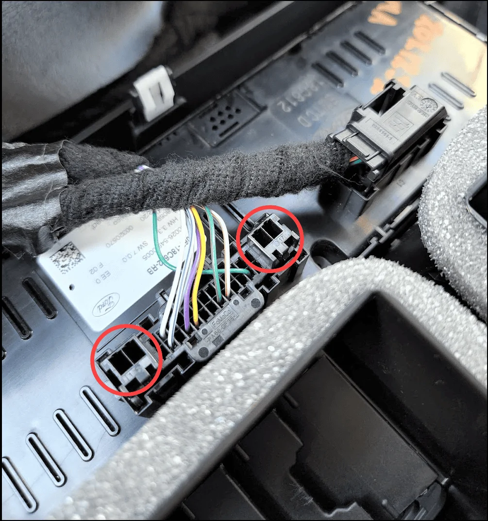

Zooming in on the picture of the climate control module wiring harness posted by @mesajoejoe , it would appear that the two large pairs of pins are labeled pins 16 (on the left of the pic/connector) and 17 (on the right of the pic/connector).
Once my new climate control module arrives, I'll be curious to know if I can get any kind of power coming from pins 16 and/or 17 when I press the heated seat buttons....
