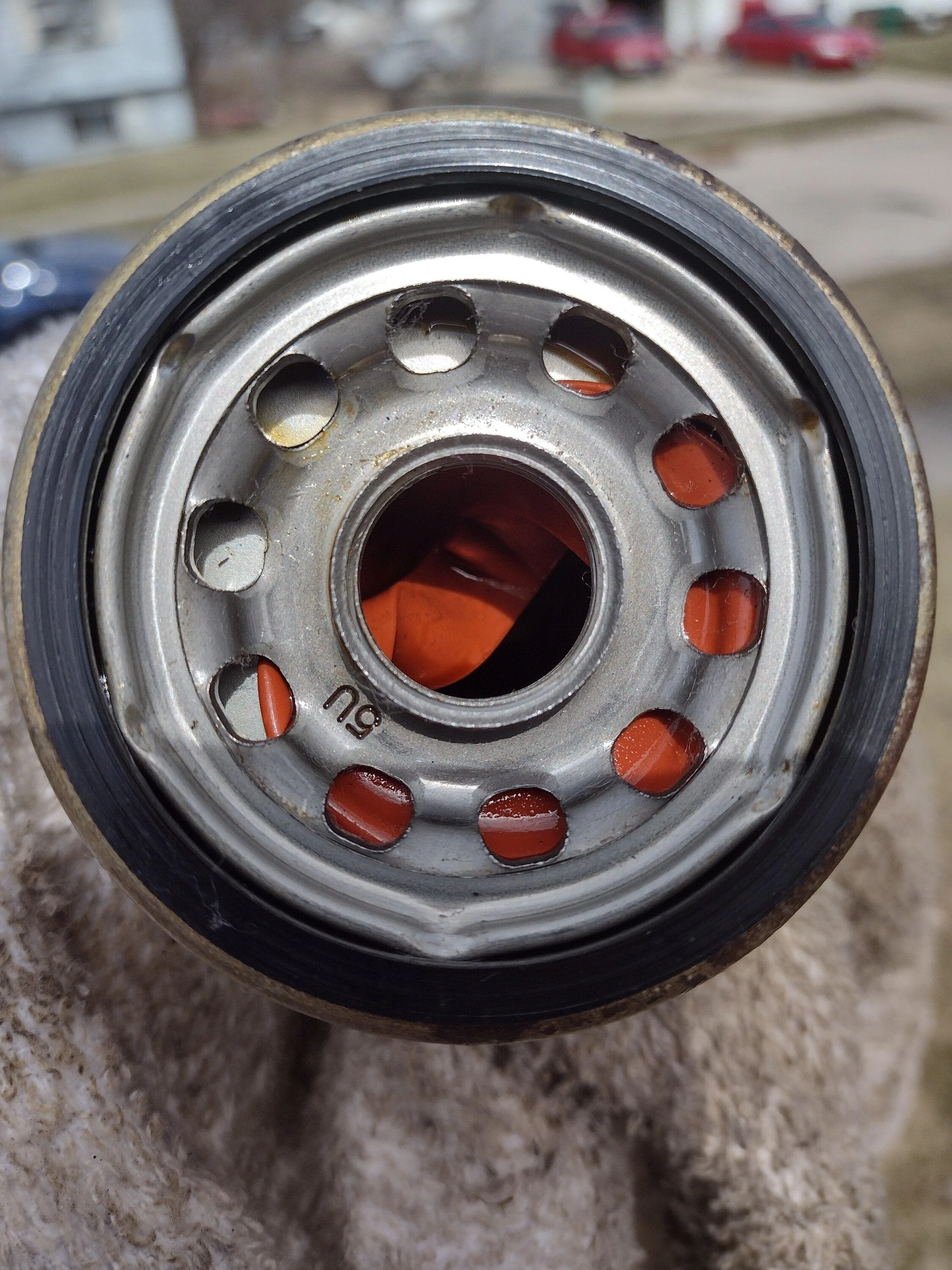

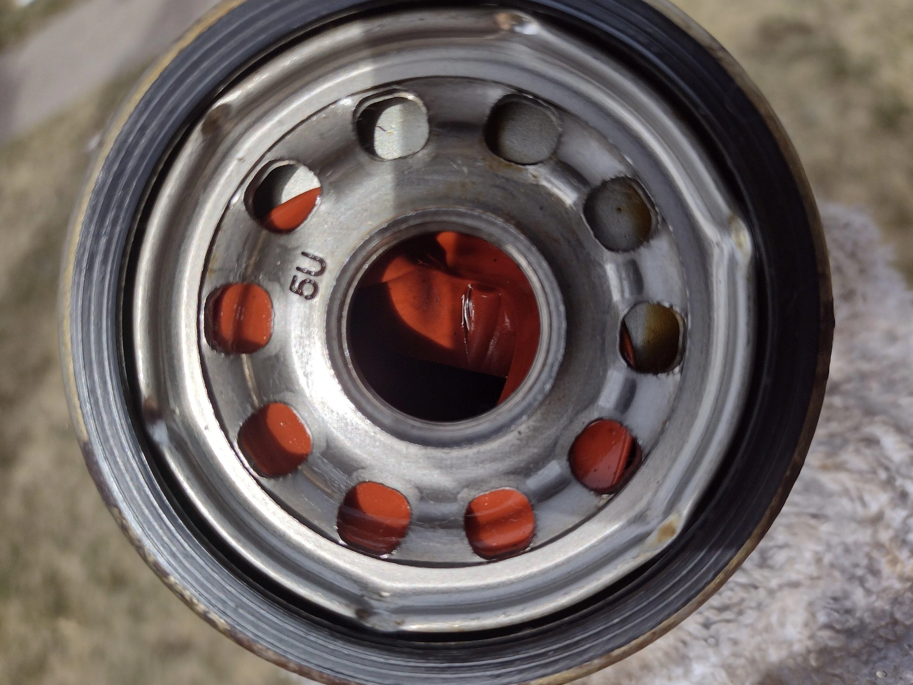

There was a guy on Bobistheoilguy that had the ADBV from his Fram filter sucked into his his Mazda engine, which destroyed it. I had a close call myself. I was a faithful user up to that point.
Ford Maverick Oil filter for 2.0? IMG_20220320_132040711_HDR
Ford Maverick Oil filter for 2.0? IMG_20220320_132014261_HDR
