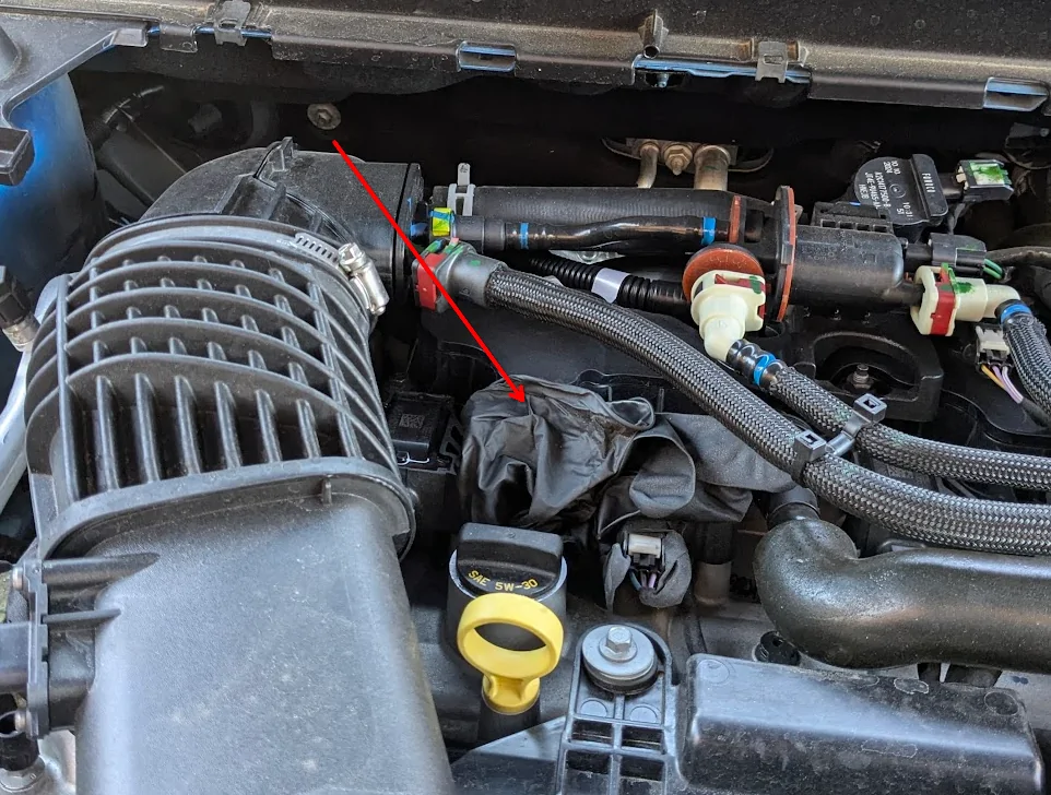

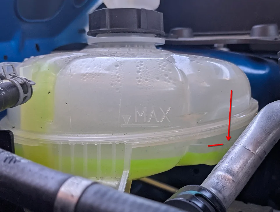

Checked my oil level, looks fine (midway in the hatch marks, between Min and Max).
Looked like oil, smelled like oil.
Removed the oil fill cap, smelled it, smells about like what I'd expect, no Obvious or Strong Gasoline smell to me.
Other than finding a latex glove sitting on top of my engine at the oil fill cap...it looked pretty normal.
No idea how long that glove had been sitting there, probably since the Radiator change.
I was mostly checking my coolant level, and still find that when its Cold, its slightly below the MIN mark.
I brought my vehicle into Service a few weeks ago to ask about it, and they didn't do anything at that time other than unscrew the cap and release the pressure, and observed that in doing so it brought it up to the MAX fill line at that time.
I checked my Oil and the cap Today the Level was the same as Yours on the Dipstick and smelled fine. And the Oil cap smelled like Yours with no Obvious Gas Smell.
