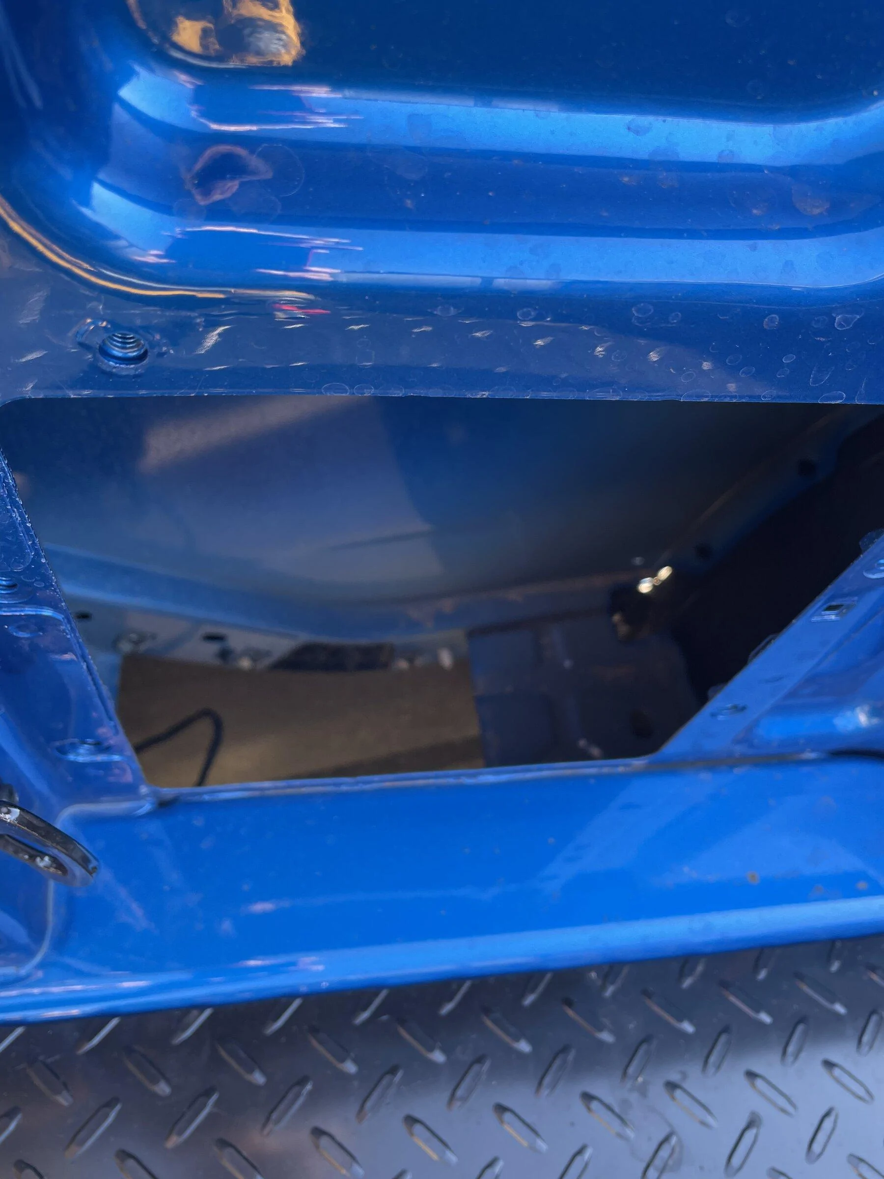

Question, what was in that space instead? I have an XL model but the hard drop in bedliner is covering the hole where the cubby goes and I have no idea whats underneath.

Its just like the open fenderwell. Plus some wiring. Covered by a plastic plate.

My buddy has the cubby, its like.. the same bolts far as I can see. the same ones that hold on the plastic plate.

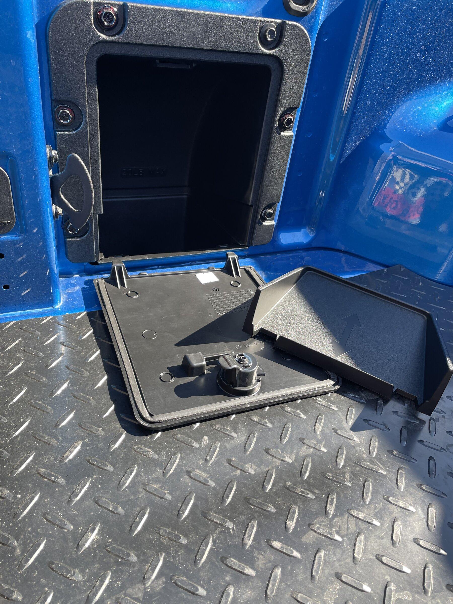

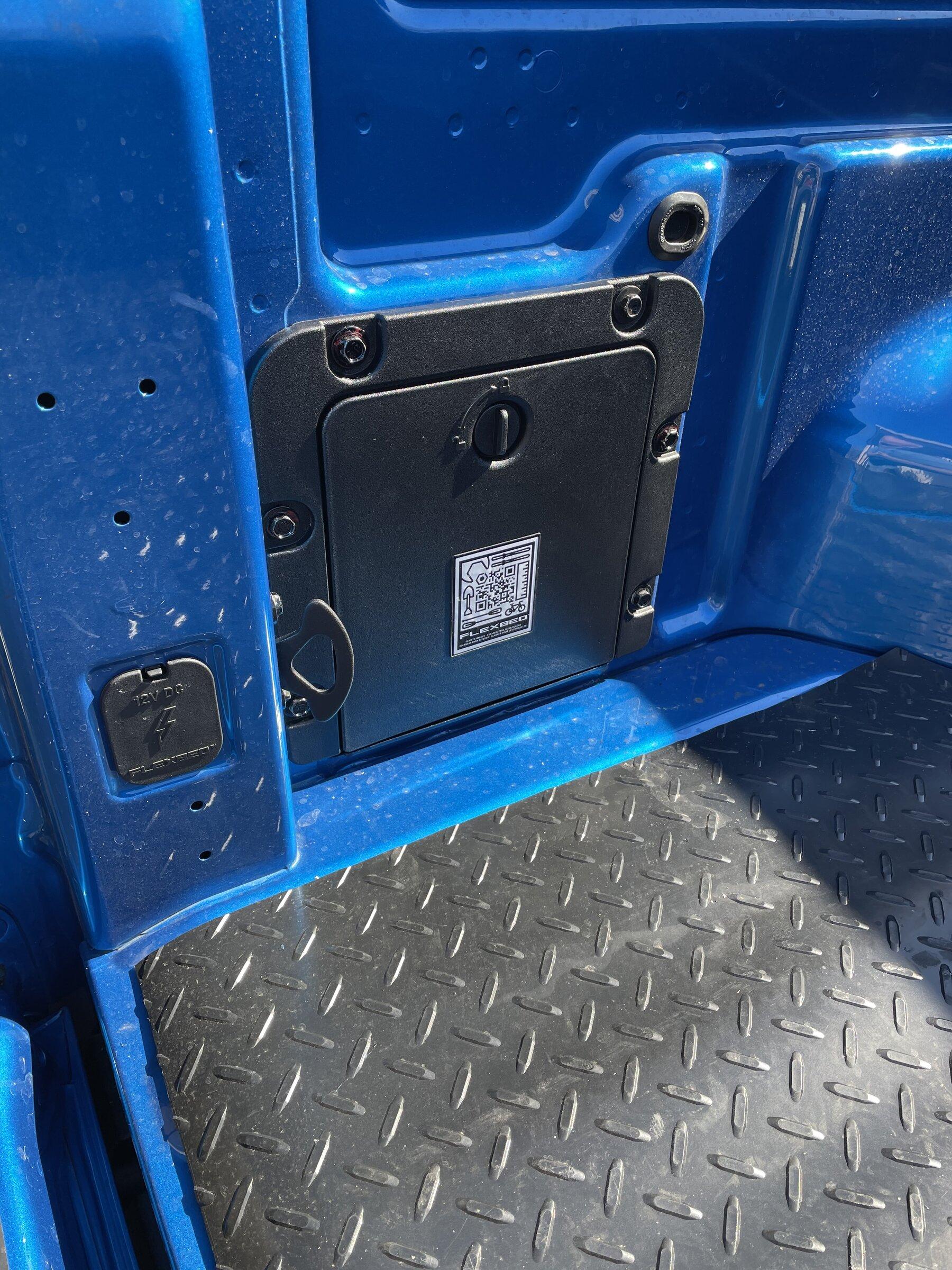

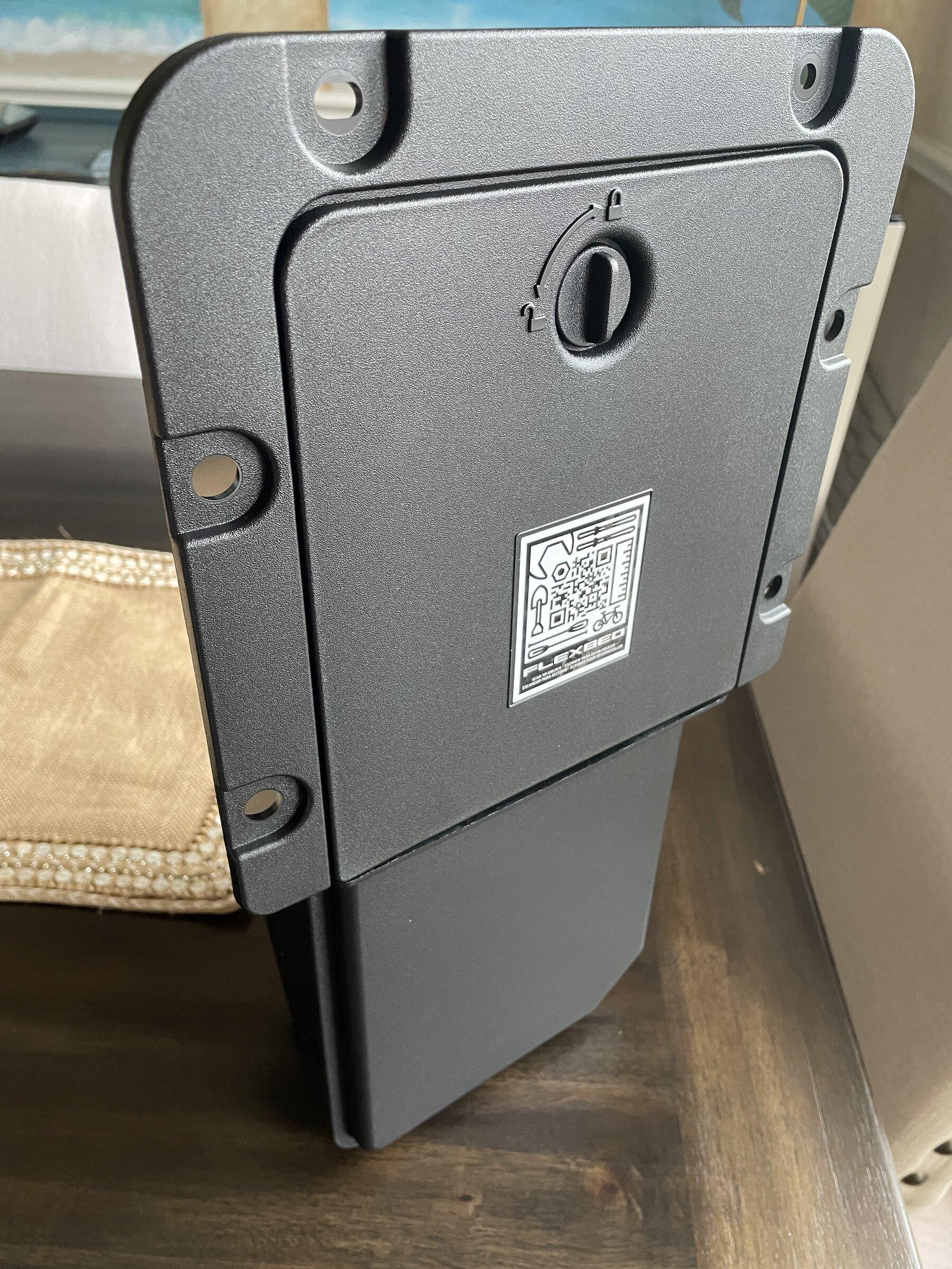

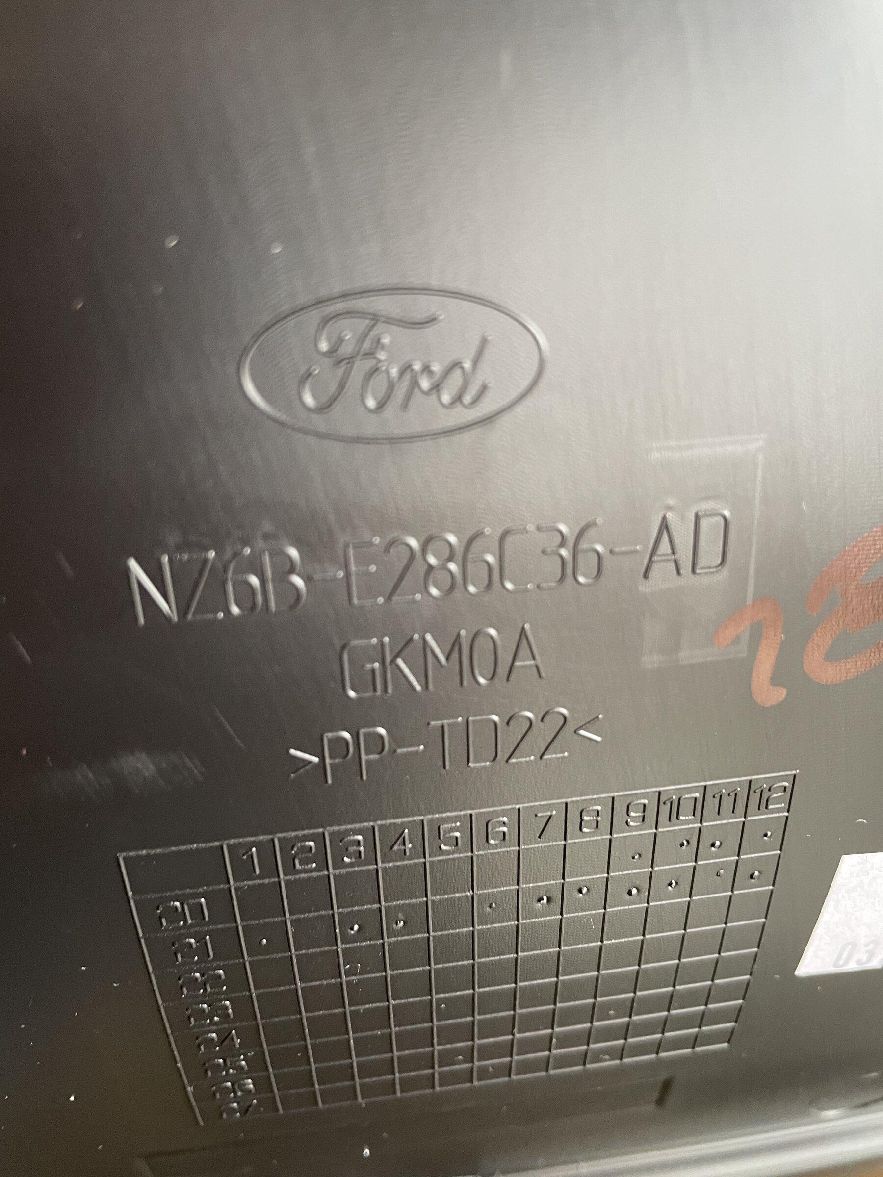

Well I finally got the bed cubby in for my lx, but it will work for any of the maverick left or right side same part #, is a 20 min job if you can turn a bolt that’s all the skill level you need lol. The cubby came completely assembled with all the parts needed except for bolts you will need 2 extra bolts if you intend to used the existing ones. Directions unbolt cover bolt cubby :)

So I read in a post somewhere (can't recall) that the underside of the cubby on the driver side is exposed to the elements whereas the passenger side cubby is enclosed on the underside.... Doubt it will be a big issue but just thought you should be aware
Correct but is a very well built cubby all plastic nothing to worry about
Can you verify that there is no issue with the driver's side install and the exhaust being close to the bottom? Just don't want any melting or anything.
Is the driver's side one exposed and the passenger side one is enclosed/protected from underneath?
I want to put jumper cables on one side and some tools on the other side.

The Lariat models have the same cubby in the driver's side from the factory so I doubt it's an issue. If you're that concerned, spend ten bucks on some stick on heat shield and apply it to the cubby before installing it.

Is this an extra one, or did your Mav not come with any cubby? My XLT only came with one, im wondering if I could order this and install it on the side without a cubby (driver's side).
The xl don’t come with one you can order a second one for the driver side on the xlt
