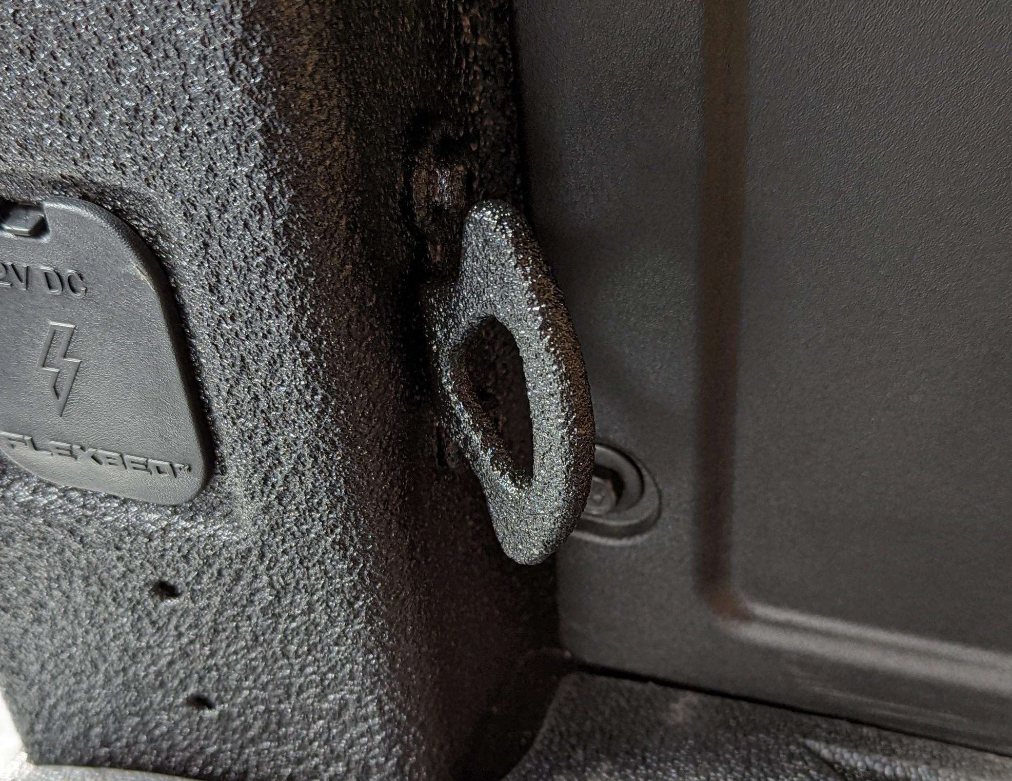

I just got a second bed cubby for my xlt. The install should be strait forward. My only issue is when the spray in liner was installed they sprayed over the tie downs... How can I take out the tie down without ruining the spray in liner?
Update....

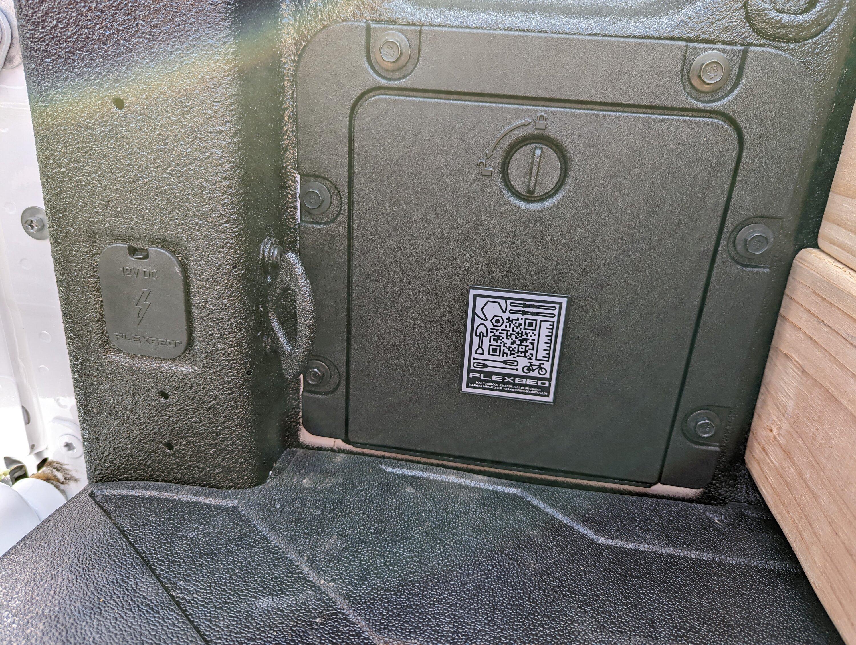

Cubby installed!! Used a razor and cut around the bolts on the tie down. The spray in popped off the top of them. I then cut around the tie down and was able to unscrew and pull it off without causing much damage to the spray in! You can tell they didn't remove the original blank cover when they in stalled the spray in.
