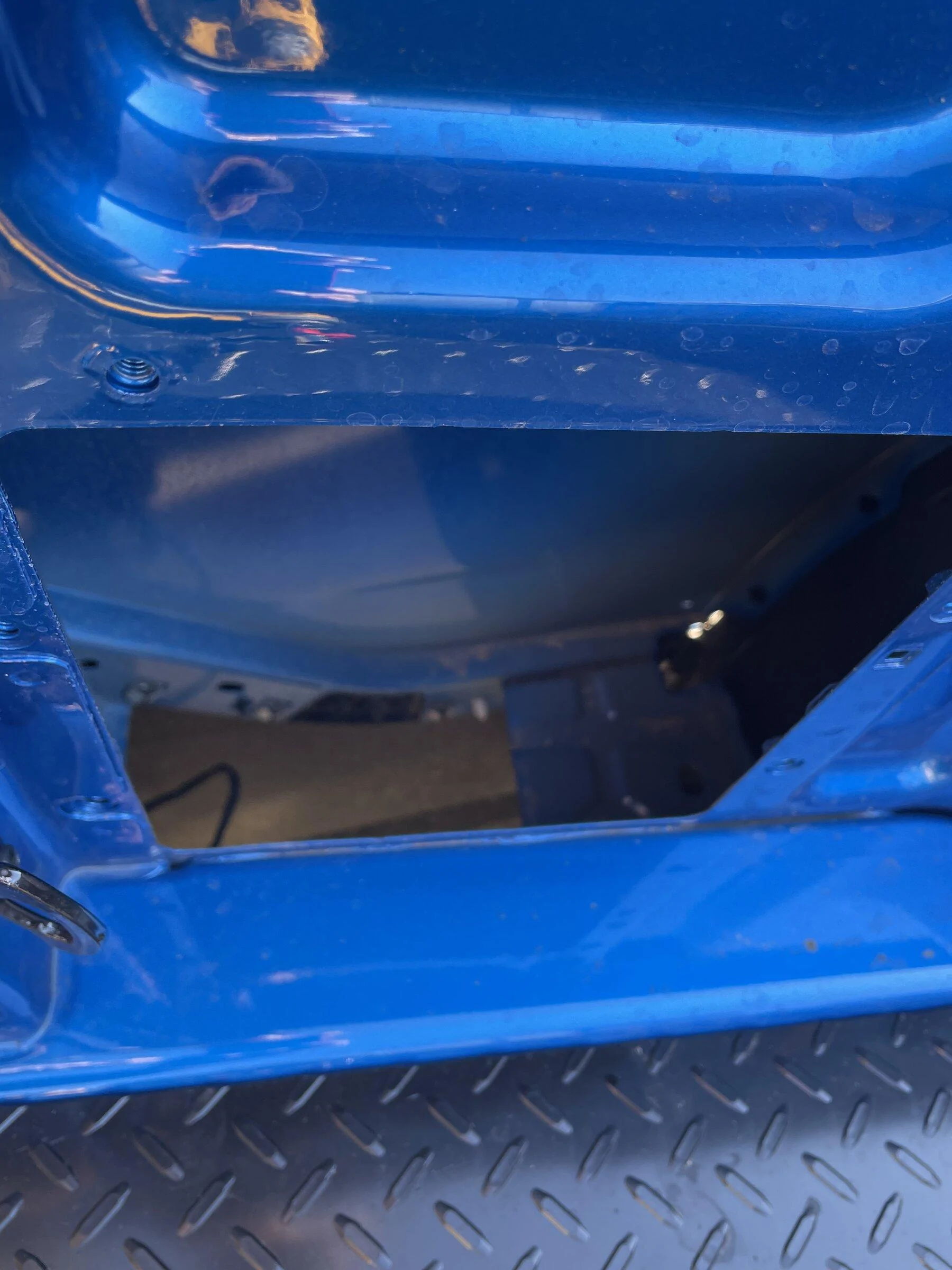

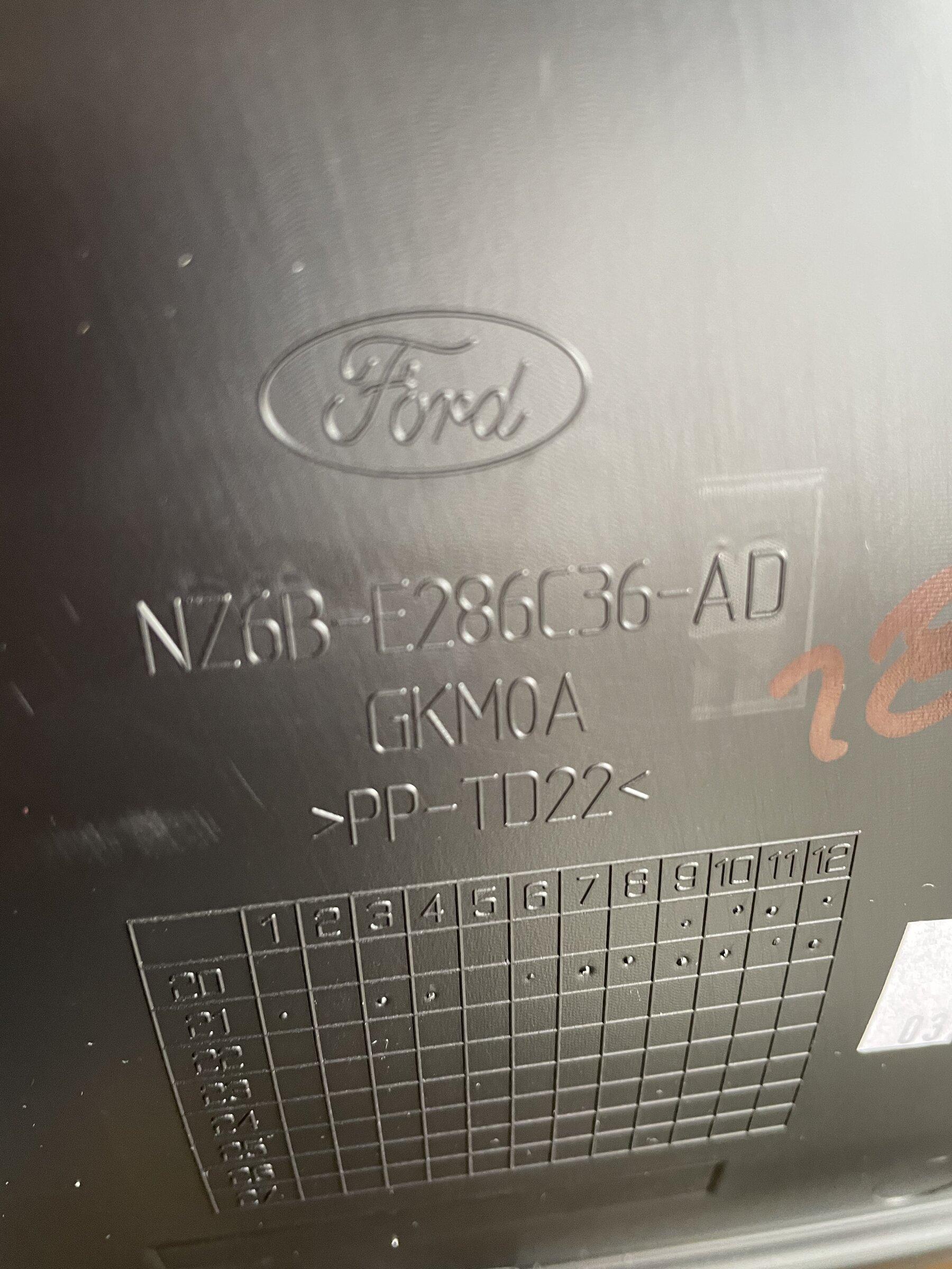

I order the cubby for the bed last month,and it’s finally here I will install it later but here’s some pics and part # not bad for 45 buck.

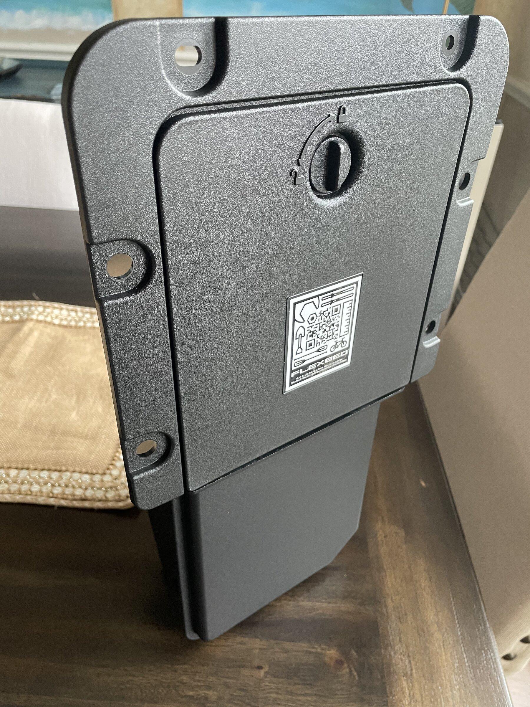

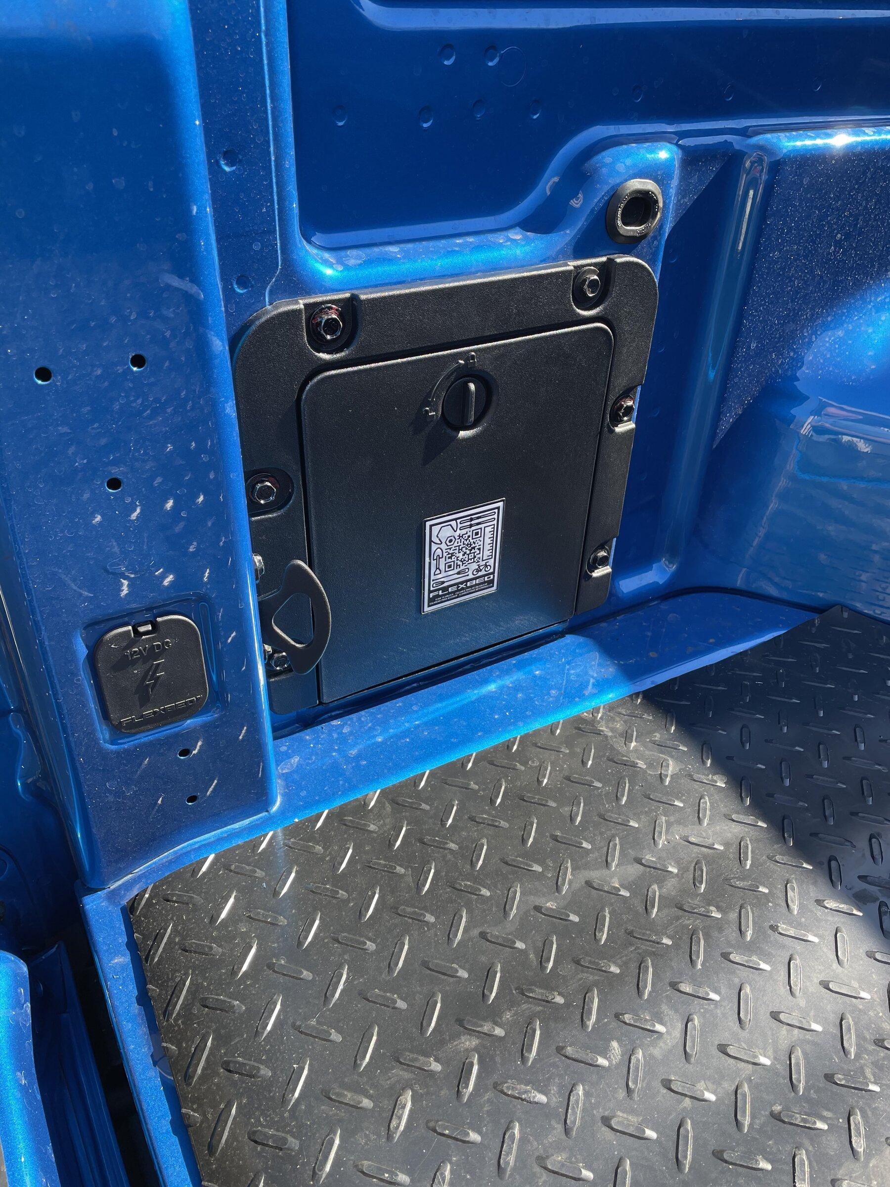

Well I finally got the bed cubby in for my lx, but it will work for any of the maverick left or right side same part #, is a 20 min job if you can turn a bolt that’s all the skill level you need lol. The cubby came completely assembled with all the parts needed except for bolts you will need 2 extra bolts if you intend to used the existing ones. Directions unbolt cover bolt cubby
