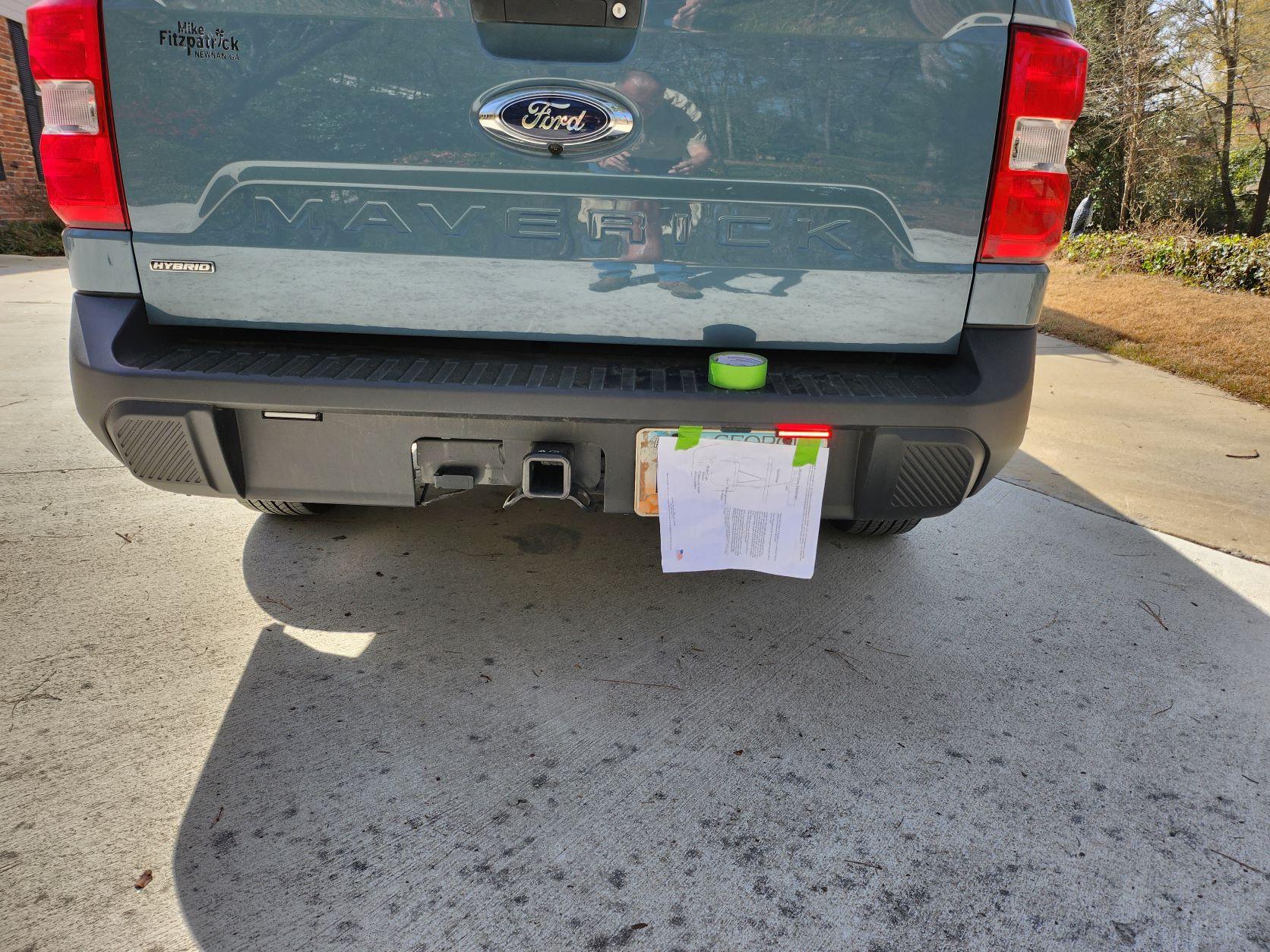

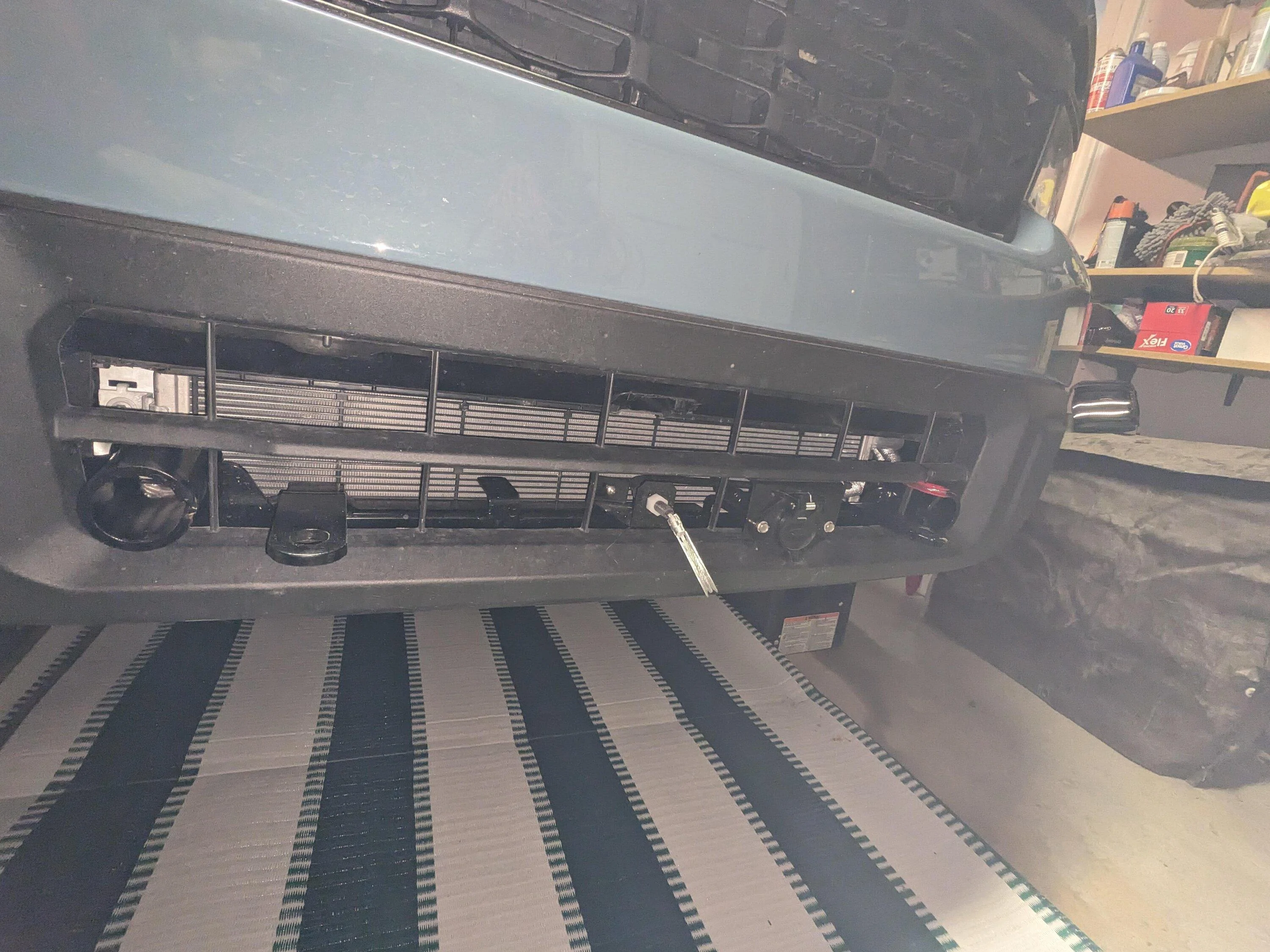

Here is what they look like installed. The right turn light is on in the pic. I drilled a hole in the bumper cover and ran the wires behind the bumper, pretty simple to do, the only thing that annoyed me was the wire gauge was pretty tiny coming from the light and it had to join a 16Ga wire so I was not comfortable with the crimped connector. I had go get some of the low temp solder connectors for the first time, an old dog learning a new trick.
Is that the stock length or did you cut them back?
Grmpy
Sep 1, 2022
Atlanta
Buick
The lights are stock. out of the box and stuck to the bumper.

I like your mounting bracket better than mine for the cable. Did you buy it or simply bend a piece of metal.
If it is something you purchased, where?
If is something you bent, what gauge is it?
Where your rubber plugs go into the baseplate give the tubes a light coating of grease. Between the vibration of towing and the plugs when not a little rust started to show, so I used a little white lithium.

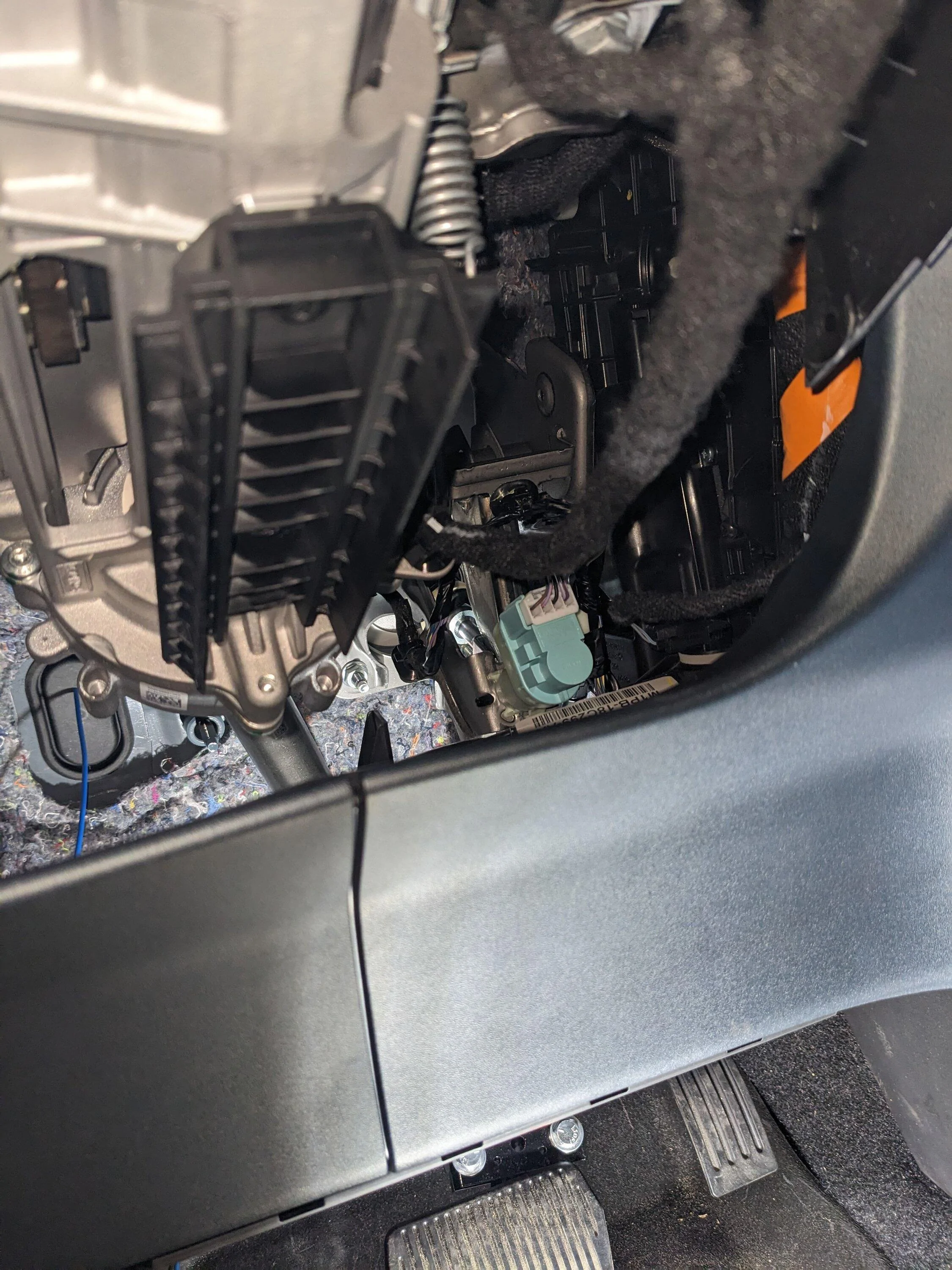

So now the only things left to do are put in the brake light relay and the light on the dash of the RV that shows the brake is on.
I bought the whole NSA towing kit. It includes a LED to put in the dash of the RV with 2 wire run for the toad and the RV, with a separate 2 wire umbilical. I'm going to use their LED, but I have a 6-pin plug that has the blue wire unused so I'm using that to run the signal to the LED. There is the blue wire and a ground running through the 6-pin connector and umbilical, so I don't see a need to add another 2 wires.
The brake light relay is needed because this braking system pulls the brake pedal which sends a signal to the tail lights, plus the RV is sending signals to those lights. This causes the Mav signal to override the RV blinker signal. So the Mav won't show brake lights and blink at the same time. The relay interrupts the Mav's brake signal so it will brake and blink at the same time.
NSA's relay is set up as normally closed, so it doesn't do anything until it is powered, then it will open and interrupt the brake signal. They want it powered with a 12v outlet. That won't work on the Mav because the 12v shuts off with the engine. I looked at Roadmaster's relay and theirs is set up as normally open and they power it by tapping into an ignition on fuse, which allows the Mav to do its thing when the ignition is on. Since 4-down towing is done with the ignition off, Roadmaster's version will be my way to go.
I almost did the connections yesterday. I figured out how to get more space to be able to find the brake signal switch. Following this I removed the lower covering on the steering wheel, which doesn't give a lot of space, but makes it so I don't have to be a contortionist to get to the brake signal switch. Following Roadmaster and etrailer's wisdom and my circuit tester, I found the purple/white wires on the right side are the ones I want to tap into. Then I went to remove the brake signal fuse because I don't want to be tapping into those signal wires and mess up some computer thing with hot wires. The owners manual says the fuse is #23 in the engine bay. The way to get into that fuse box is very strange. Have to remove the lid, then manual says to open two levers, pull the covers off, then pull the whole fuse box off and turn it upside down and the fuses will be there. I tried the levers and the Mav started talking to me with its ET clicks and I decided it was not the day to do this job. More research is needed. So again, I put my Mav back together to be worked on another day.
I struck out on Mav engine fuse box, but found info on 2020 Escape hybrid fuse box. This shows how to get into it. The Mav owners manual seems to be lacking.
I've attached a picture of the brake signal switch with the bottom steering wheel cowling removed. It's that light blue thing. The pin on the right has 2 purple/white wires going into it. They show 12v when the brake pedal is pressed. That is the one I'm going to tap into.
