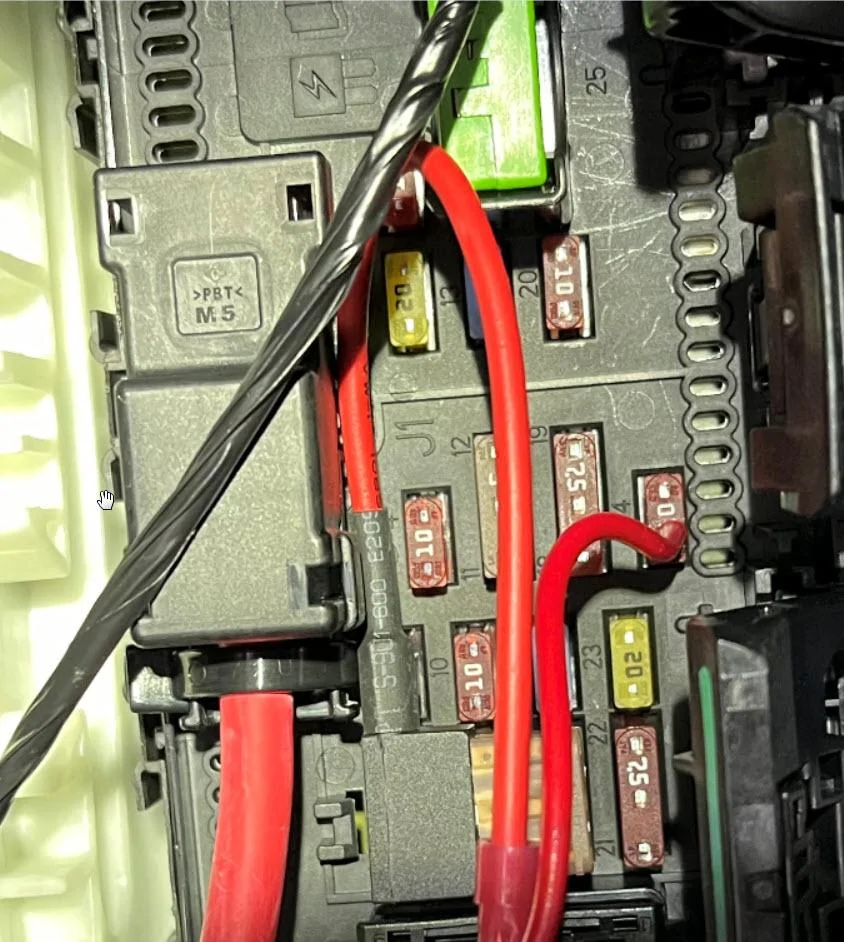

I'm attempting to wire in a subwoofer and I've seen other say they use Fuse 6 for the Turn-On Wire. I purchased some fuse taps to do the same thing, but the problem I'm running into is that due to the angle of the Fuse Tap it won't fit. Both sides of the fuse have something that prevents the fuse tap to make contact. I can't find any that don't have a 90 degree angle. Does anyone have any suggestions?

Solder a pigtail directly to the fuse test point on top.

Or just use Fuse 3.
Fuse 6 is technically better since it functions on the retained power circuit (stays powered after key off until door opened) like the radio, but the location is not ideal unless you use a soldered style fuse piggyback with an in-line.
