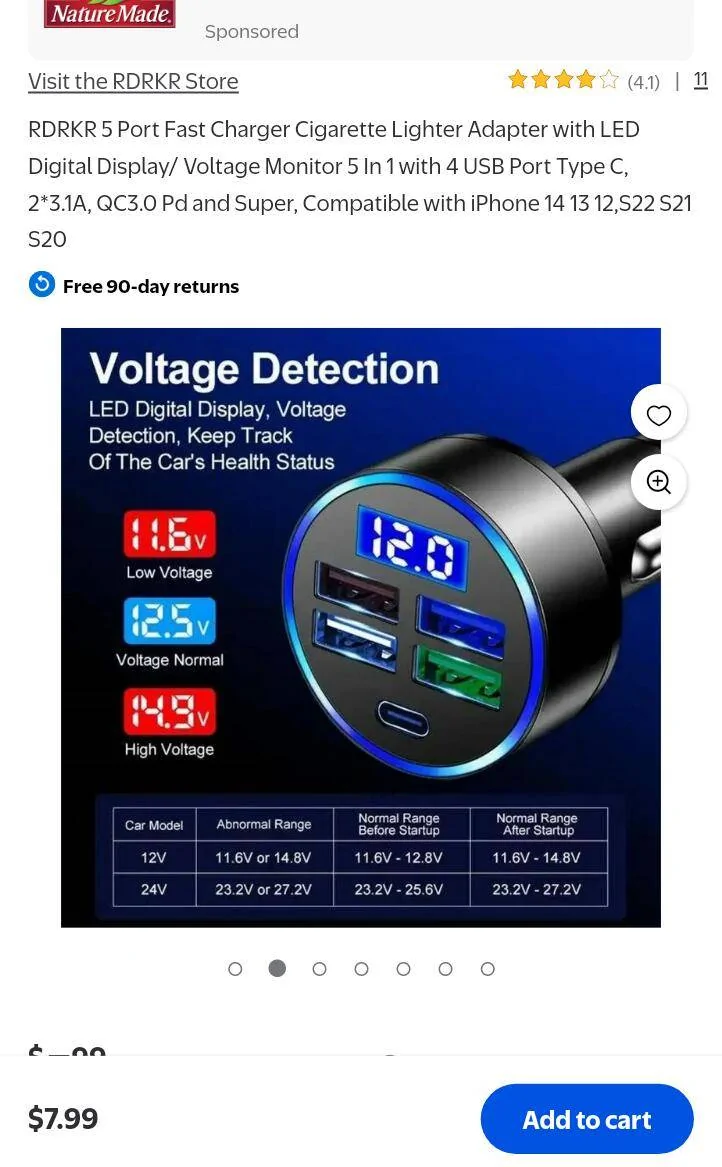

Yea, I bought one of those adapters also. I'm gonna use it for my dash cam and ambient lighting that will turn off with the truck off. The power point stays on with the key off for 4500 seconds, and I don't have Forscan to reset the time.
I also want to run some Raptor lights, I am going to power them on with the key on, from the in cab fuse panel. I just do not want to cut the marker light harness , plus I want them on with the DRL's and headlights.
I only found 1 listing online for the tap with 2 wires, its ordered, from sherco-auto.com. We shall see how it all turns out.

The only issue with the cig lighter/power point adapter, is that the power point stays on for 4500 seconds(1hr 15 min), after key off, unless you set the time down with Forscan.
I had a Ford tech try to adjust mine with the Ford software, he couldn't figure out how to change it.
