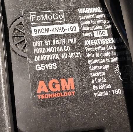

AGM battery: Part Number is... BAGM-48H6-760
Ford Maverick NHTSA Recall AGM-Battery_Pups
This is how MY Battery is labeled. Which is the correct ( AGM-type) one..

numerous threads related to this. short answer, "The suspect 12V
batteries were introduced into production on February 5, 2020, and removed from
production on October 20, 2022." Also, depends on the battery manufacturer in the parts bin when the vehicle was built. In much older post, its been noted that some ICE MY22's even came from factory with agm batteries (obviously whatever was on hand at the time).
These attachments were copied/saved from a previous thread/post as additional info. Hope that helps some.
