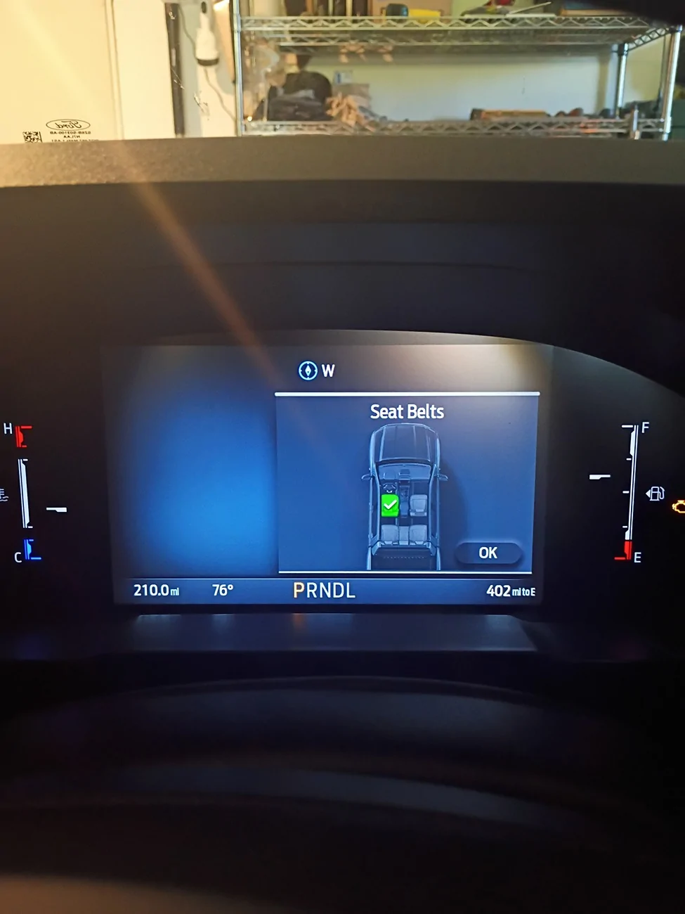

For disabling the seatbelt nanny screen and doing other mods check this out.
I disabled the screen but kept the chime, I also added the speed sign in the cluster.

Thank you, I saved that in my bookmarks. But did you read this whole thread? My skills are a comic tragedy. I absolutely despise the nanny safety dictates in this vehicle, so I'll have to fix it soon.

The process is very easy. I would read the documentation and watch some videos on youtube. essentially find the options and activate them. I would be sure to create a back up first.

I disabled the seat belt screen using
720-13-01
720-13-02
720-14-01
720-14-02
by changing to all zeros but I could not do the Forscan sheet values to keep the chime which I would like to do. I always make sure everyone is buckled but the chime would be good.
