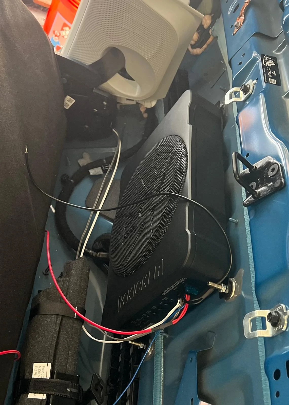

Installed my new system today. Amazing difference in sound, clarity & power over the crap Ford put in the truck from factory. Rockford Fosgate R1T-S tweeters, Kicker 43DSC6704 door speakers, Kicker 46CSC44 in the rear pillars, went with a Kicker Key 200.4 mounted up under the passenger side of the dash and an 46HS10 I mounted on the back wall of the cab using furniture leveling guide that I JB Welded on after removing the factory sub mount. Plug & Play makes an harness that really makes the install pretty easy (Thanks Joe). I ordered all the speakers from Crutchfield since they included the installation hardware and instructions. The only speakers I had the cut & splice were the tweezers. It’s a big job but if you’re up for the challenge you’ll be rewarded with an awesome sounding system that won’t brake the bank.

I see a blue remote power-on signal wire going into your HS10. I assume that means you're using remote power-in and not signal sensing on both the HS10 and Key 200.4?
Rob217
Rob
Jul 30, 2023
Miami, FL
If you use the harness from Plug & Play you don’t need to run the remote wire. Just make sure the Auto Turn On is switched to +12v on the 46GS10 so it doesn’t have constant power.
