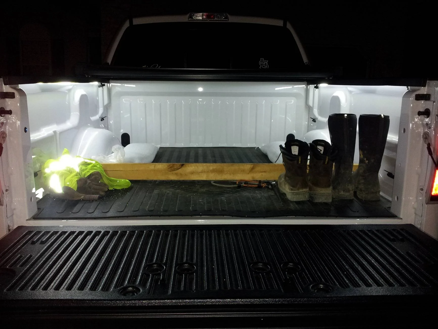

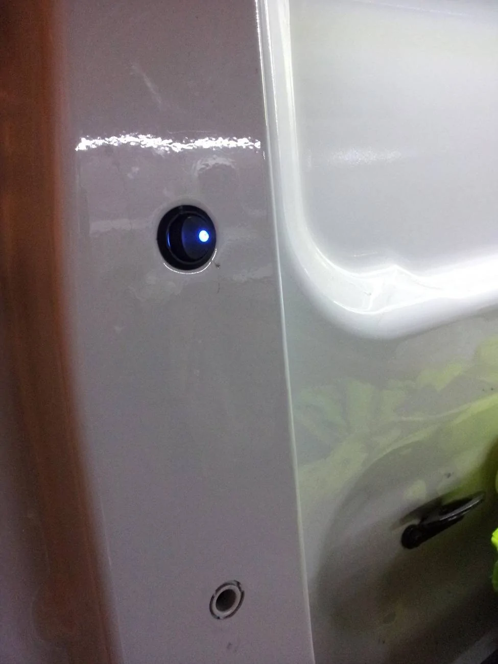

Looks great @tcw8848. I did the same thing to 12' F-150 when new, as they didn't have any bed lighting then. Added a switch to the OEM bed extender hole, which fit perfectly.
Been debating doing the same to the maverick, as the one oem led bedlight doesn't cut it.
Ford Maverick New Bed LED strip lighting. Cheap and easy mod! 20130406_011114
Ford Maverick New Bed LED strip lighting. Cheap and easy mod! 20130406_012433
