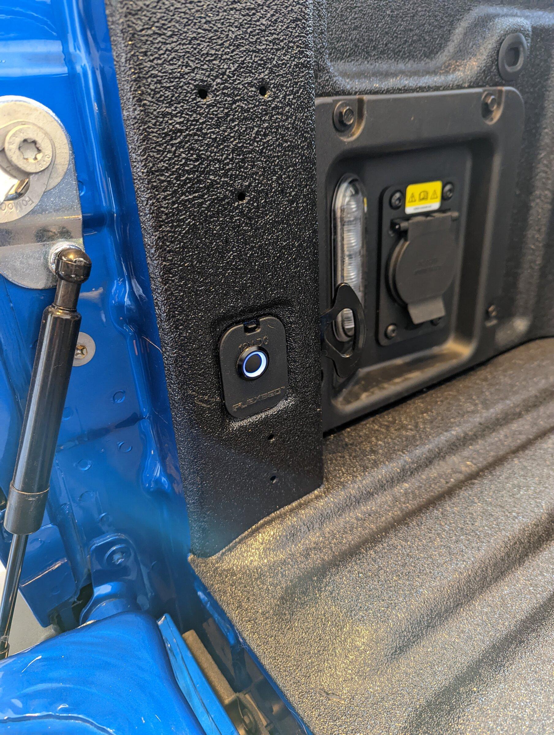

My plan is to just add an LED strip to the light circuit in the rear of the bed that goes on whenever that existing LED light comes on...either by the manual switch or automatic with the cargo lights. Maybe about a 2 foot length mounted to the cleat rail.
I took the rails and bedliner out to get to the 4 bolts holding in the LED and Inverter plug cover (because you can't get at the bolts with the modular panel installed). When I had it apart, I popped the LED light fixture out into the bed area and ran a wire up through the top for the LED strip. Then I put it back together as I wait for wire taps to arrive. Funny, there is a black wire and a black wire with a white stripe going to the existing LED. The white stripe wire was the negative.
I completed mine yesterday and they look great, functioning with the switch on the LED light in the bed (note: not all mavericks have this). I did make a video and will post soon, but in the meantime, here is one that is fairly close to the method I used:

I did likewise for my LED bed light strip, but then I bought a motion detection switch to take the place of the Ford OEM switch (Lariat). Have yet to install . . . bigger fish to fry at the present, but doing these little mods on the Maverick is not only fun, but therapeutic as well.

I ended up using these. I believe they are in the green holes I pictured above. Another thought might be to use a drywall screw anchor that expands in the hole.
Nylon Push Mount Cable Zip Tie, 8.3" Heavy Duty Nylon Push Mount Self Locking Assortment for Indoor Wire Tying- Black 8.3x0.2inch 40 Pack https://a.co/d/fRjjctm
What size holes will these work in? There are 2 sizes holes along that area.

Finally got my video posted. My computer was giving me grief when trying to save the edited version but I finally got it done. Here is the link:

I also installed a magnetic switch so when bed opens, the lights come on. Not working exactly as i would have hoped and I may re-do that switch or disconnect. I am interested in the motion detection option you previously mentioned. Do you have link to that item on amazon or something?

Mercury switch inside tailgate. Run wires in with backup camera wires

I got around to editing and posting the video about adding a Magnetic switch to the bed lighting.
I purchased on Amazon: Amazon.com: Directed Electronics 8600 Micro Magnetic Switch : Industrial & Scientific
Here is the install video:
