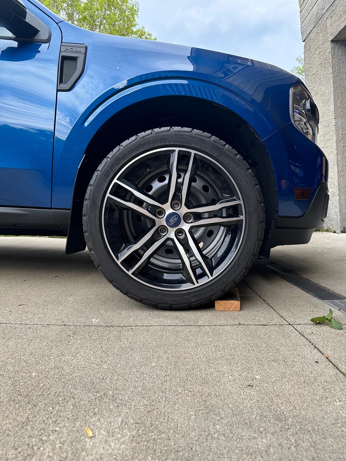

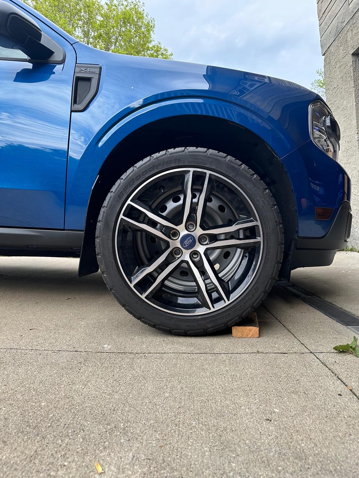

I have a 2024 XL Ecoboost with the steelies. I want to add OEM Focus ST wheels I have to My Maverick. I need help choosing between 225 60 18 or 235 60 18 or 245 55 18 tire size. I want a look similar to the OEM tire options. I am worried about rubbing on the inside but I also don't want a tire that looks bad (too thin). I really want to avoid running spacers as well.. There was another thread where a Maverick owner installed Focus ST wheels with 245 55 18s but I believe the person had rubbing issues when towing and I do NOT want that..The wheel specs and pictures are listed below.
OEM Steelies
17x7 225 65 17
38mm offset
Focus ST Wheels
18x8 225 60 18 OR 235 60 18 OR 245 55 18
55mm Offset
Ford Maverick Need Help choosing Tire Size for New Wheels IMG_3343
Ford Maverick Need Help choosing Tire Size for New Wheels IMG_3344

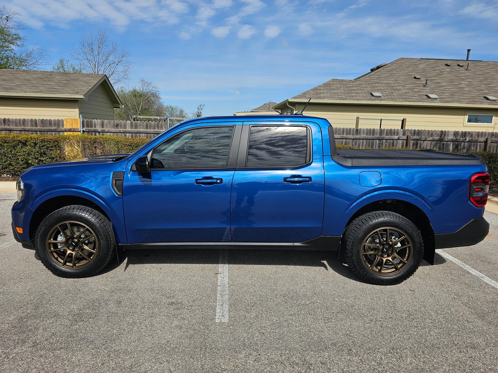

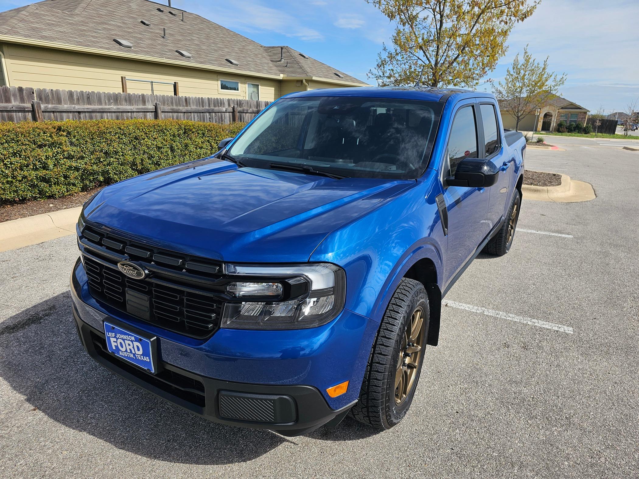

United States
2024 Ford Maverick XL
Thanks for the info everyone. Im going to go with 235 60 18. I like the way it looks on the these members Maverick's and im 99% sure they will fit without any rub. Also, 235 60 has way more options for tires than 245 55. I will post pictures when I get them mounted.
