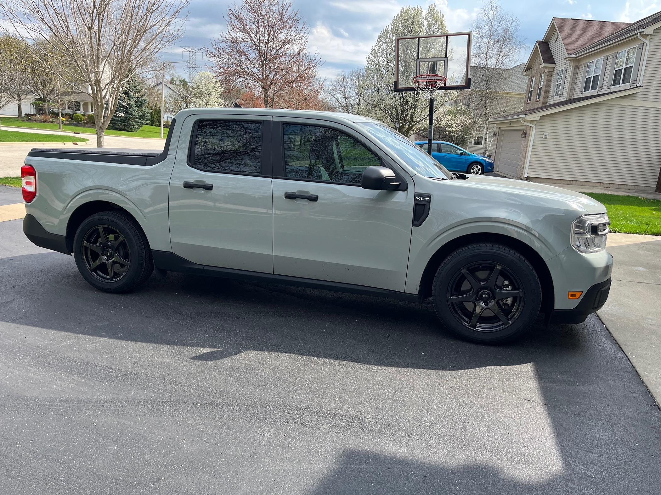

Ended up with 235/55/18. Look pretty good and ride is comfortable. Will probably get some coilovers to lower more
Ford Maverick new wheels and 245/55/18 tire size, any rub IMG_9559
