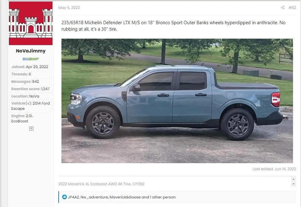

Hello, and congrats on getting your build date.
A member here (NoVaJimmy) put 235/65 R18s on outer banks wheels and says he has no issues with rubbing.
He also hyperdipped the wheels in anthracite and I think they look great. Someone else here, I can't remember who it was, posted an amazon link to vinyl decals that cover the polished face of the OB wheels, making them appear solid black. Also a really nice look.

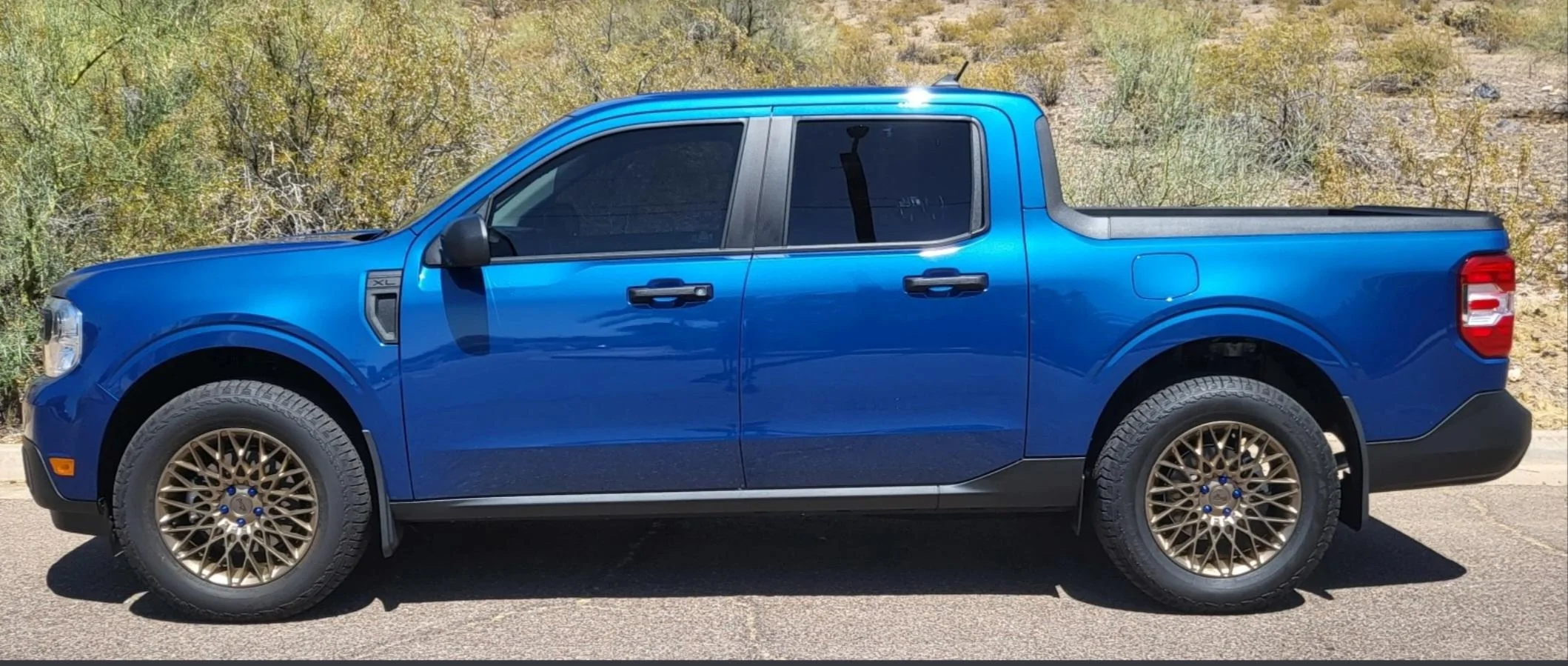

265/60/18 fit without rubbing at stock height too. The pic below is another member's truck on here.
Ford Maverick 18-inch wheels max tire size? Screenshot_20230730_070536_Chrom
Hey, just wanted to double check that at full lock they wouldn't rub?
LSchicago
Lloyd
Jul 19, 2022
87
4,169
5,490
IL
That would depend on the offset, but this one is not my truck.
