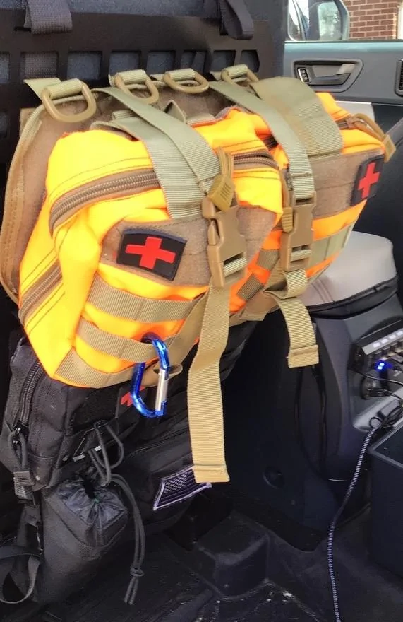

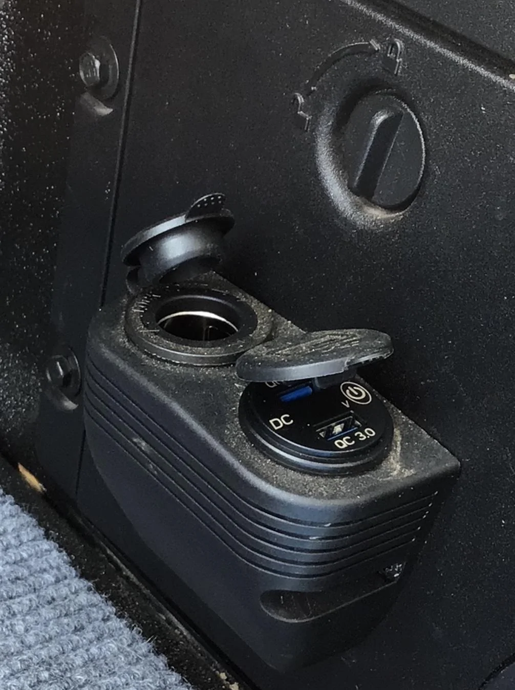

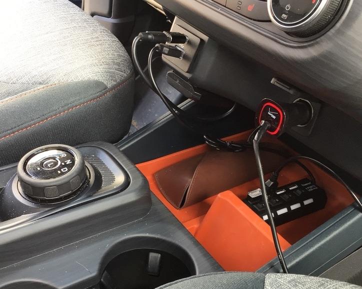

Wow!!! Impressive!! I really like that net setup you have behind the rear seat on the cab wall. Can you tell us more about that? Also the USB strip on the back of the console. Where did you get that?

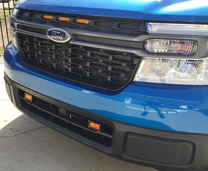

I spent sometime today with a camera to capture some shots of my truck as requested by a number of you. I don’t claim to have anything special. Rather, it represents a collection of nips and tucks to personalize my Maverick to meet my needs. Several projects remain. The front view shows a pair of 3” LED pods mounted in the grill. In fact they are simply placed there for the photo. I have the pods, a wiring kit with relay, and have mounted two five pole toggle switches to the lower portion of the dash board. I‘m waiting for a relative to clear the area around his garage lift to complete the installation.

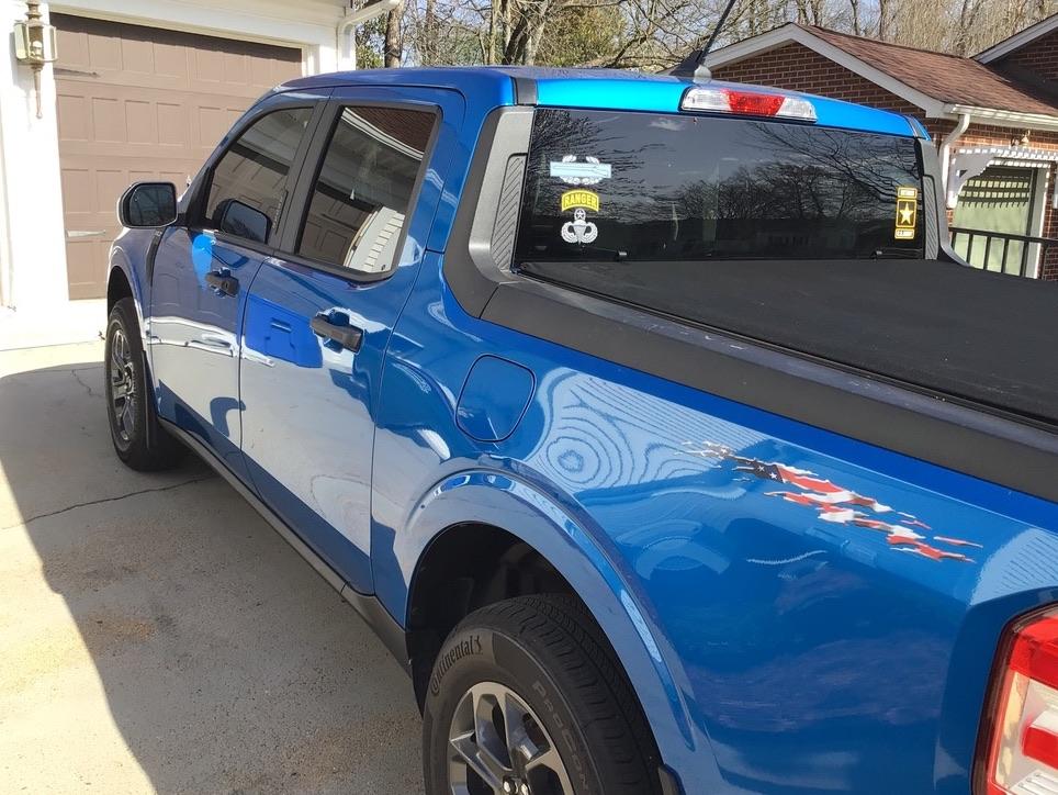

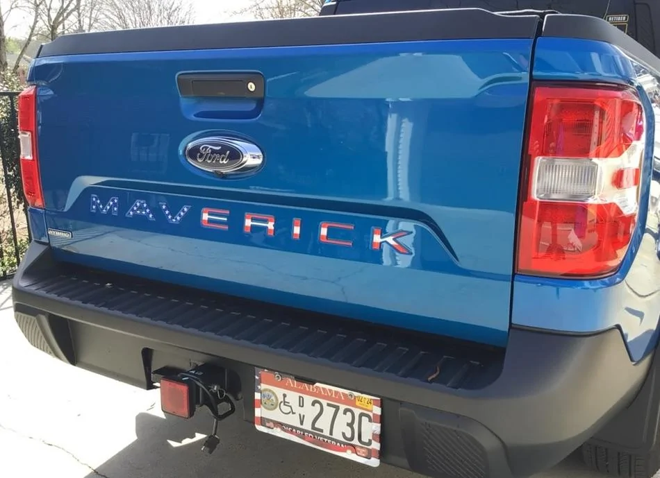

One regret, I had the side graphics scaled down. As I look at them now, I wish they were twice as big. if I can answer any questions, please ask.

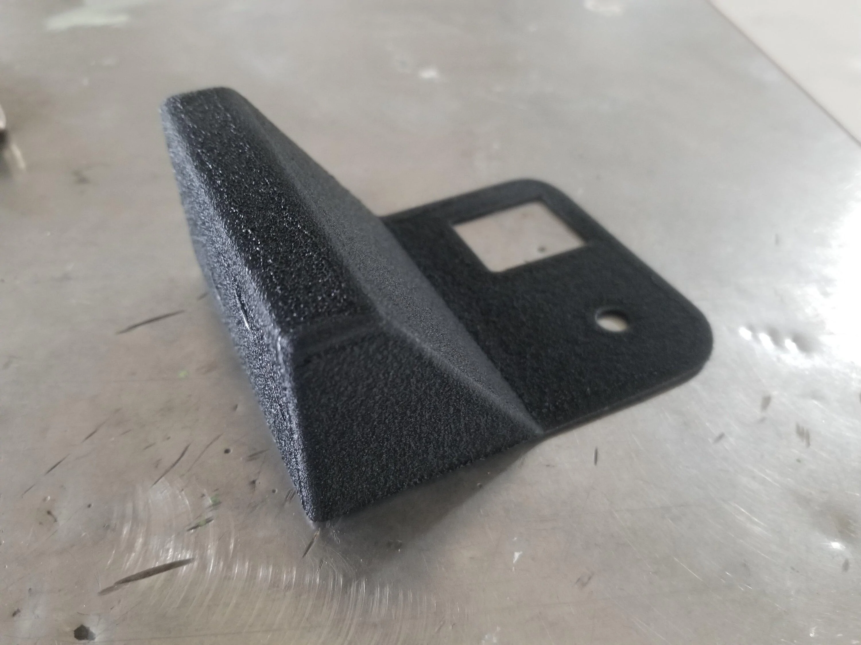

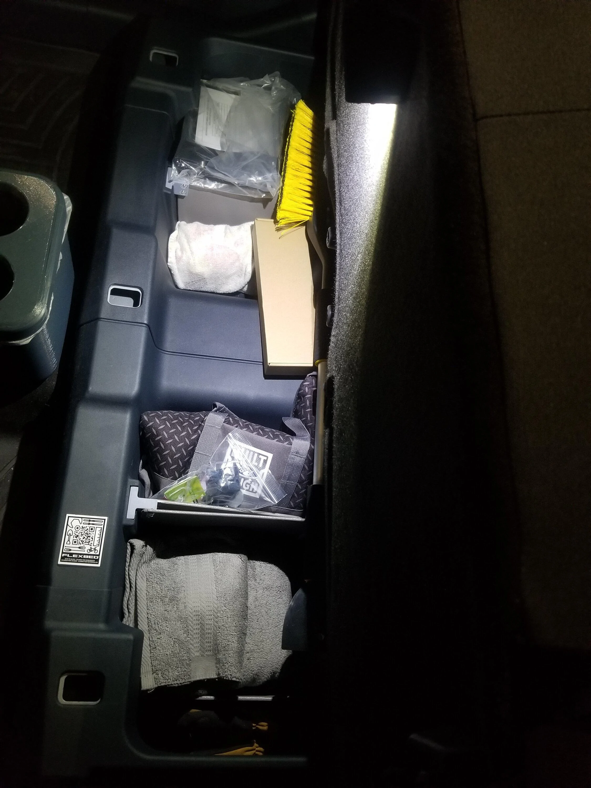

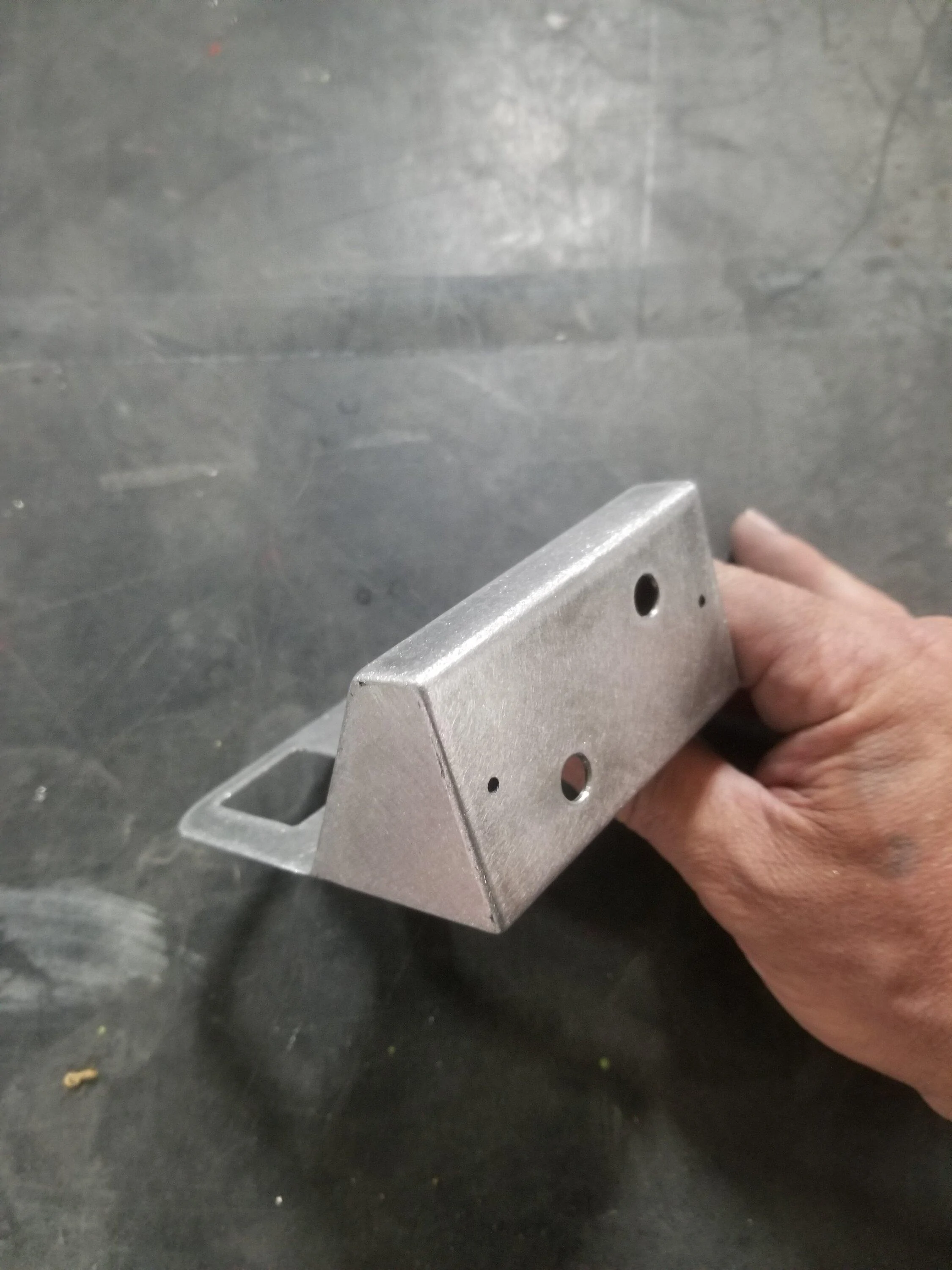

This is what I love about these trucks. They are a blank canvas to customize and make how you need / want them to be for you. I have done a bunch of stuff to mine. One thing i did was make and hard wire in a light under the back seat. The housing is fabricated and welded together steel sheet. The light is a bi color light made for a side by side buggy. Got this off Amazon. The housing was a pain to make, but should give you ideas. Wiring is ran along stock wiring and tied into the dome lamp. It uses a mercury switch so to turn it off simply put the seat down and the light automatically goes out. I used automotive black wrinkle engine paint finish to have it blend in with the carpet.

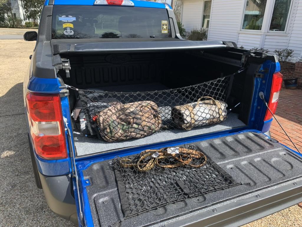

I've never seen a tailgate-mounted net before. Seems really useful. Anyone have a link? I'm not having much luck.

The net I used I took from the trunk of my Mazda Miata when I traded it in. I mounted it to the tailgate by adding large black flat washers to two OEM screws securing the tailgate’s interior face. By not tightening the two screws all the way down, I left enough space to secure the net’s elastic loop corners behind the washers. The opening of the net is at the top when the tailgate is closed. I hound keeping a pair of long, adjustable elastic bungees there especially handy.
