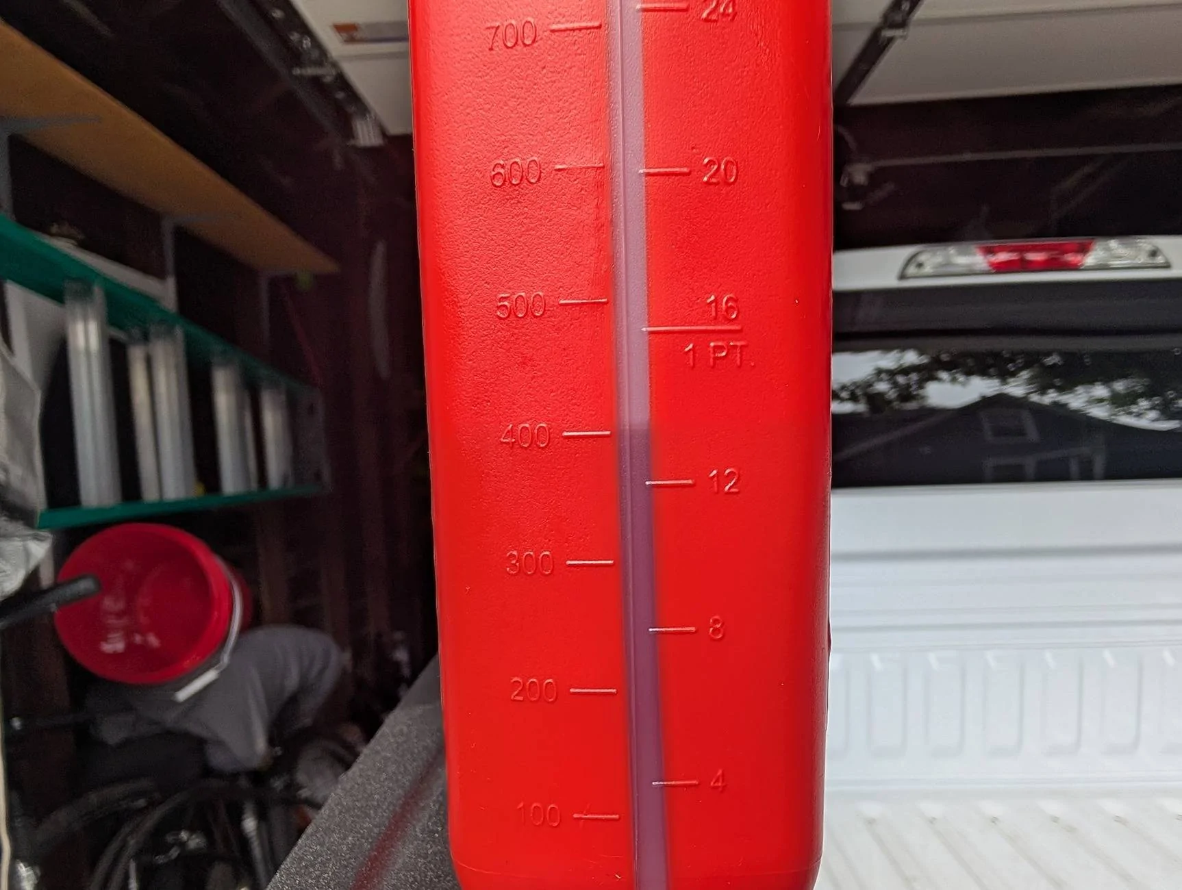

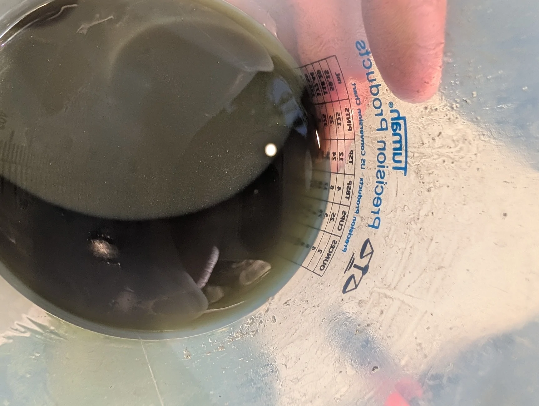

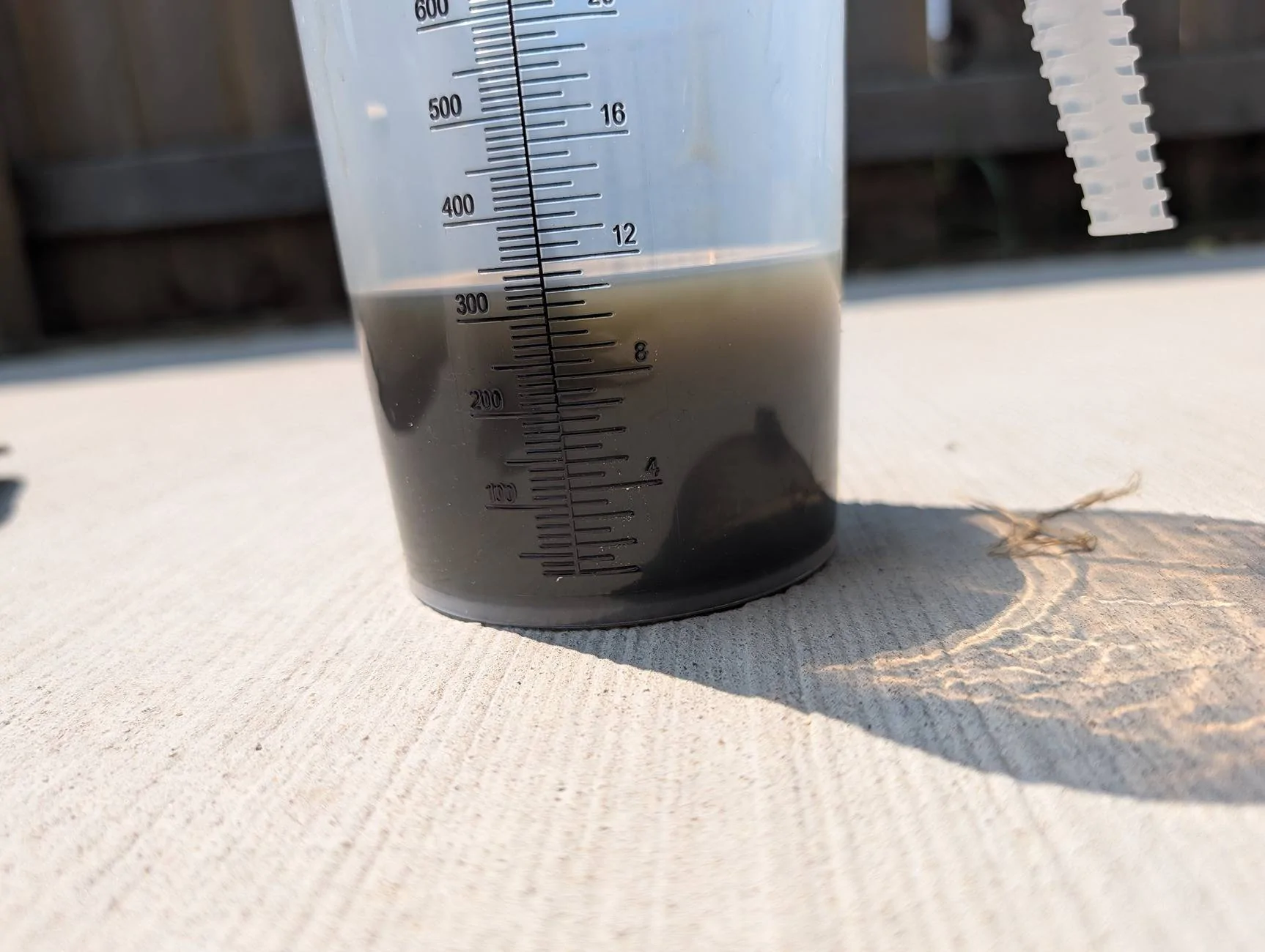

Update:
11.5 ounces drained and I refilled with 16 ounces.

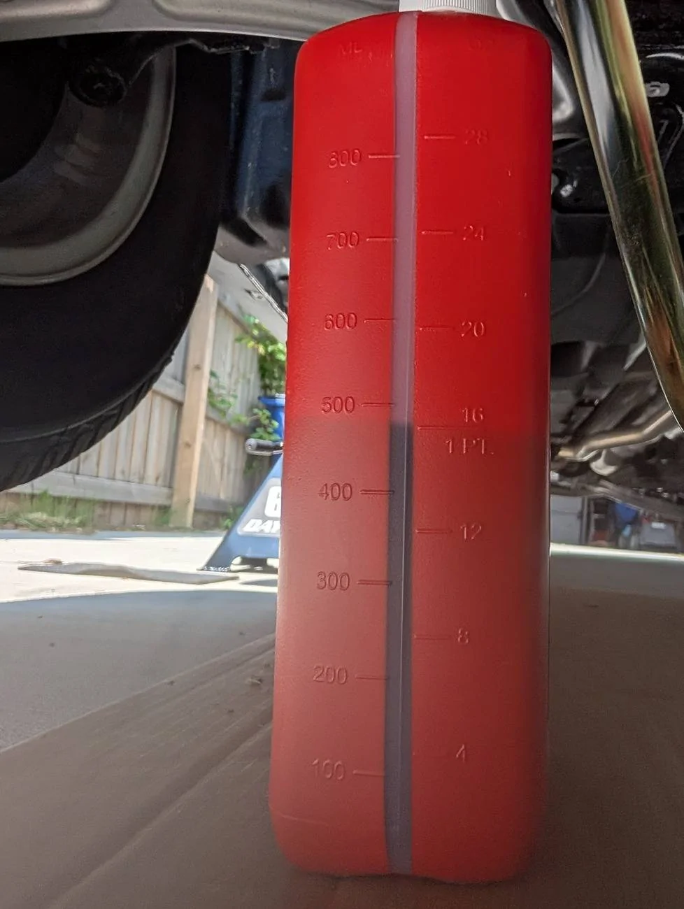

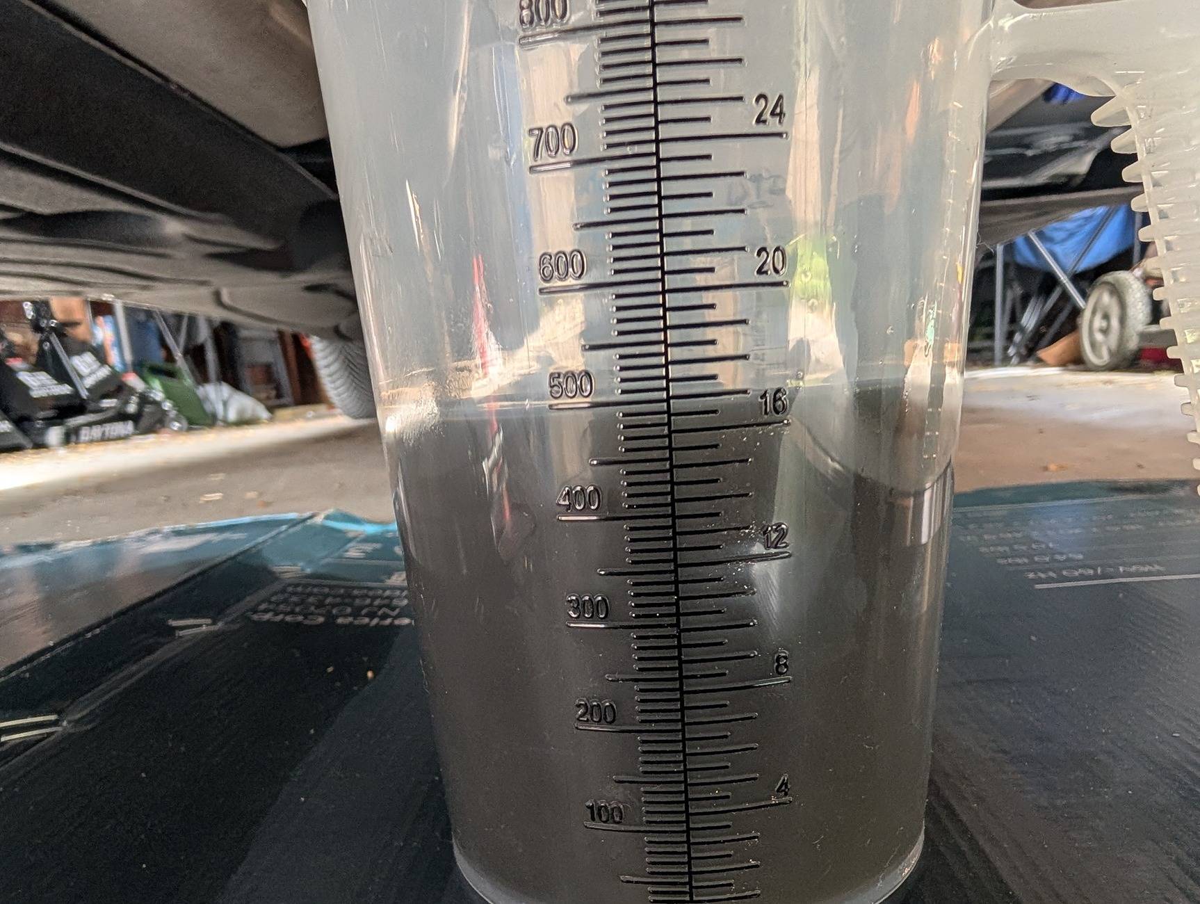

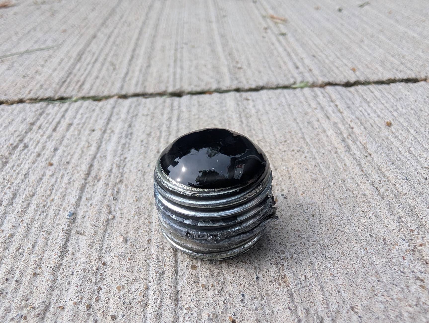

Update:
RDU drained out 16.5 ounces. I filled it backup, about 18.5 ounces. Drove it around for a bit and filled until it leaked again from the filler hole. I'm thinking about 20 ounces filled?

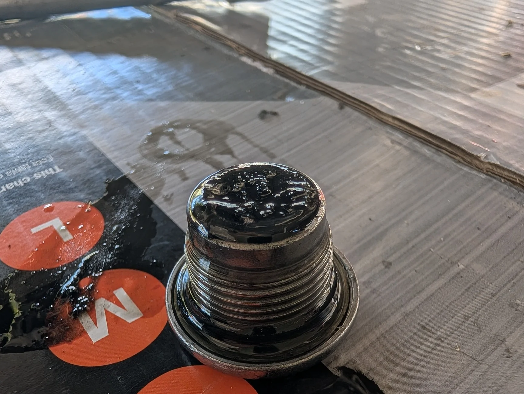

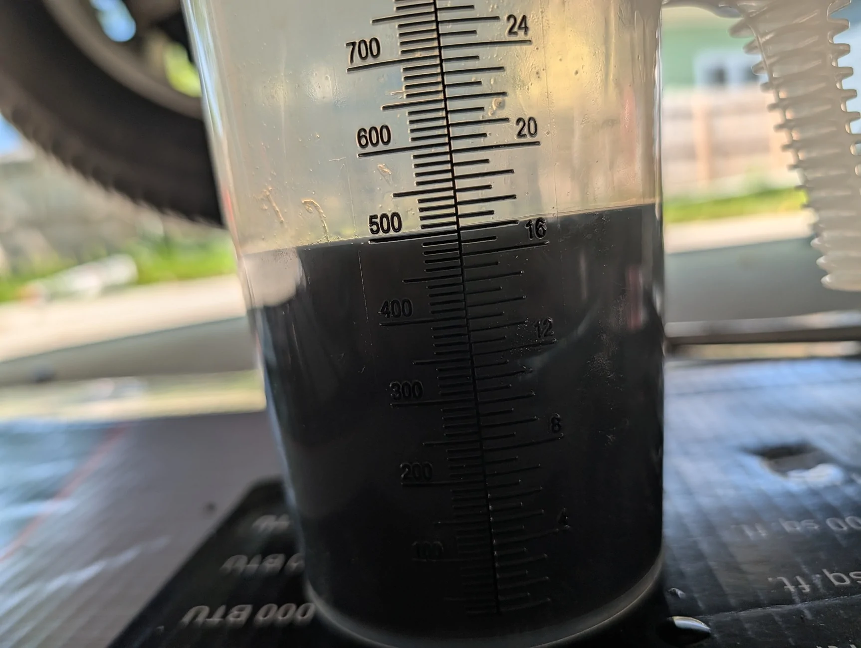

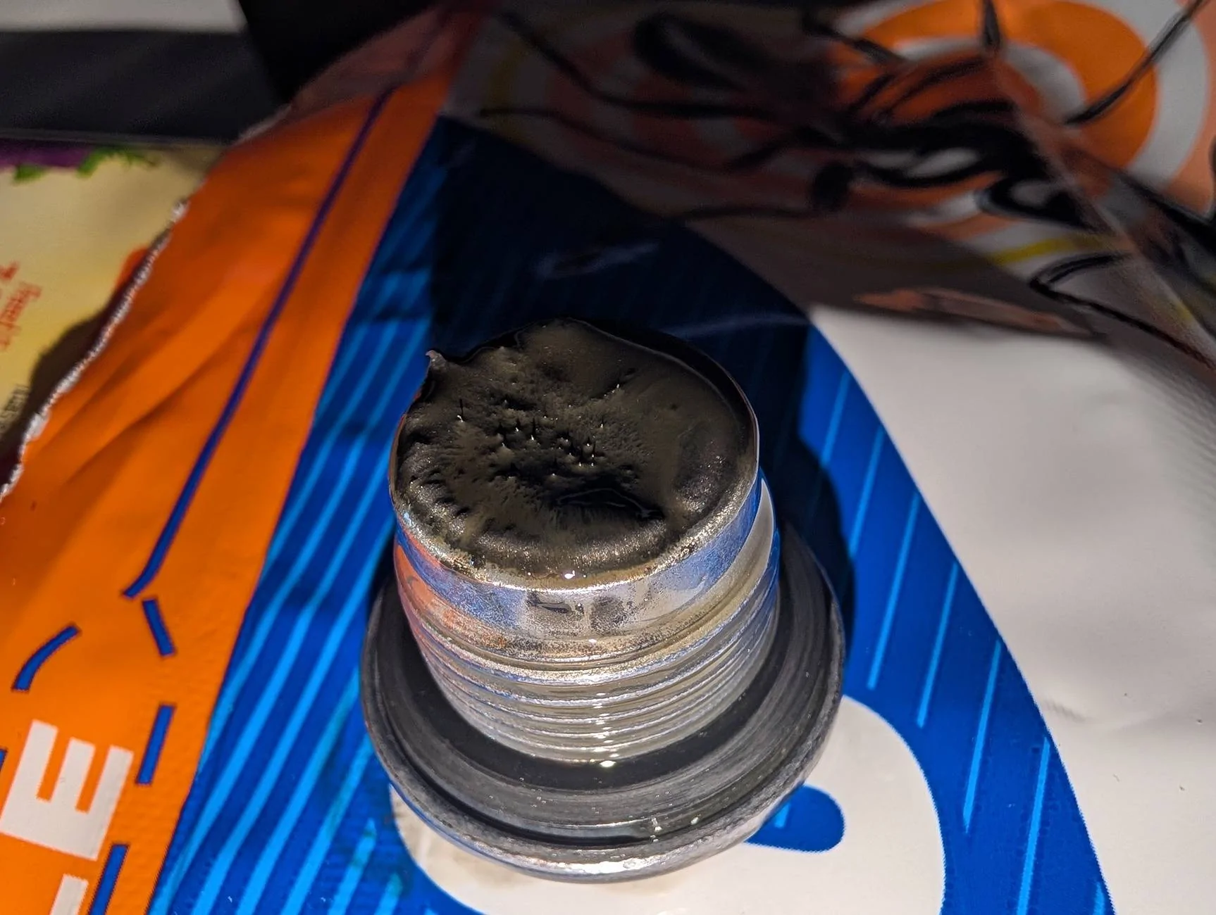

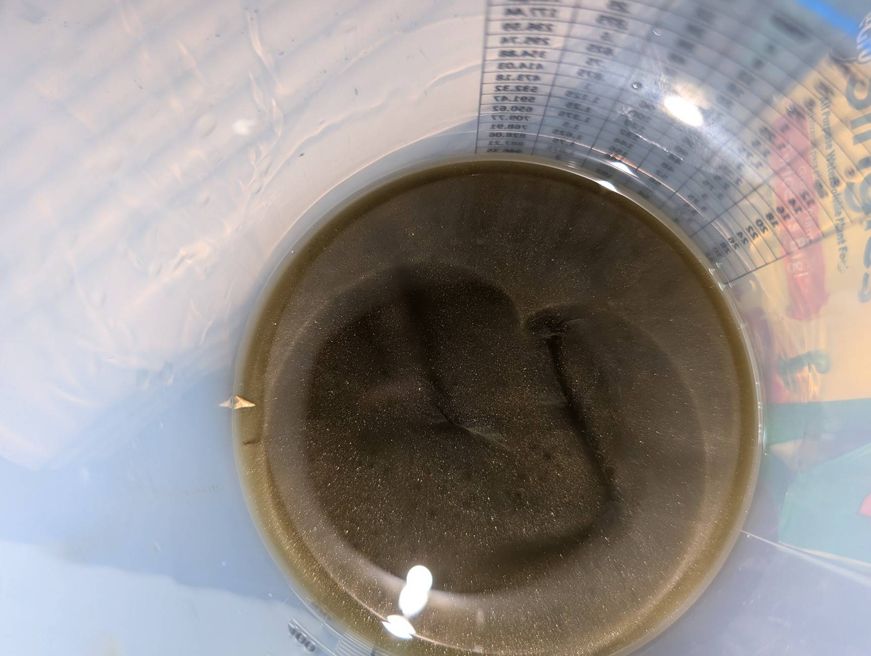

Update 11,000 miles:
Looks like I caught it in time. small amounts on the magnet and minimal sparkles in the oil. Check your PTU levels!

Original posted updated with pictures and oil level. TLDR 11.5 ounces drained and 16 ounces filled. I'll be doing the RDU once that oil comes in.

Good catch, @lostboykev.
Four ounces may not seem like much, but to me, having only 75% oil fill is significant, given the total amount required for fill.
In your pictures, there seems to be a fair bit of wear metal on the drain magnet and suspended in the drained oil, likely due to gears wearing in.
Consider a repeat drain and fill in another thousand miles or so just to keep tabs on condition of the oil and to verify that wear metal is lessened.

Updated original post to show RDU drain and fill. 16.5 drained. About 20 ounces filled. Magnetic plug was caked with slug.

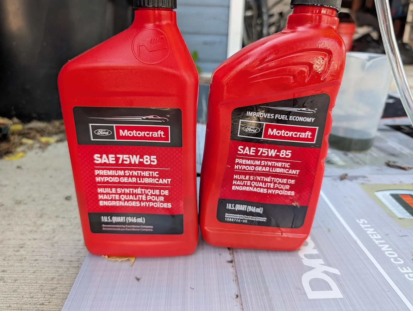

I updated the post after a drain and fill at 11k. Things are looking a lot better. Minimal sparkles in the oil and significantly less on the magnet. Also I rebought Motorcraft SAE 75W-85 oil and the cap size is different and now says it improves your fuel economy on the bottle. Not sure what could be different or if this is marketing bs. Heres the difference. Also the harbor freight pump i bought today fit. theres no threads on the new top but it worked!
