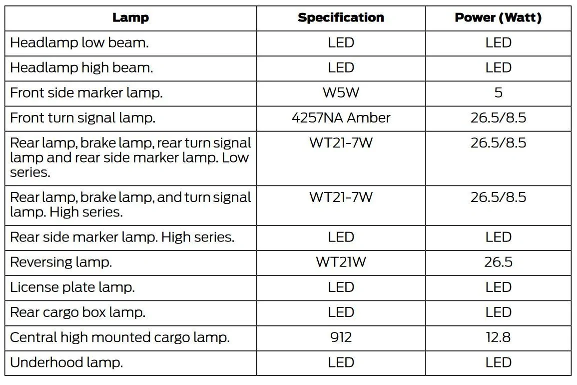

These are the non-LED lamps on the Lariat:
Lamp--- Specification--- Power (Watt)
Front side marker lamp. --- W5W--- 5W
Front turn signal lamp. --- 4257NA Amber--- 26.5W/8.5W
Rear lamp, brake lamp, rear turn signal lamp and rear side marker lamp. Low series. --- WT21-7W--- 26.5W/8.5W
Rear lamp, brake lamp, and turn signal lamp. High series.--- WT21-7W- 26.5W/8.5W
Reversing lamp.--- WT21W--- 26.5W
Central high mounted cargo lamp.--- 912--- 12.8W

I just took this snapshot out of the 24MY owners manual.
Ford Maverick MY 2024 LED bulbs same as 2023? 24 Bulb Chart
