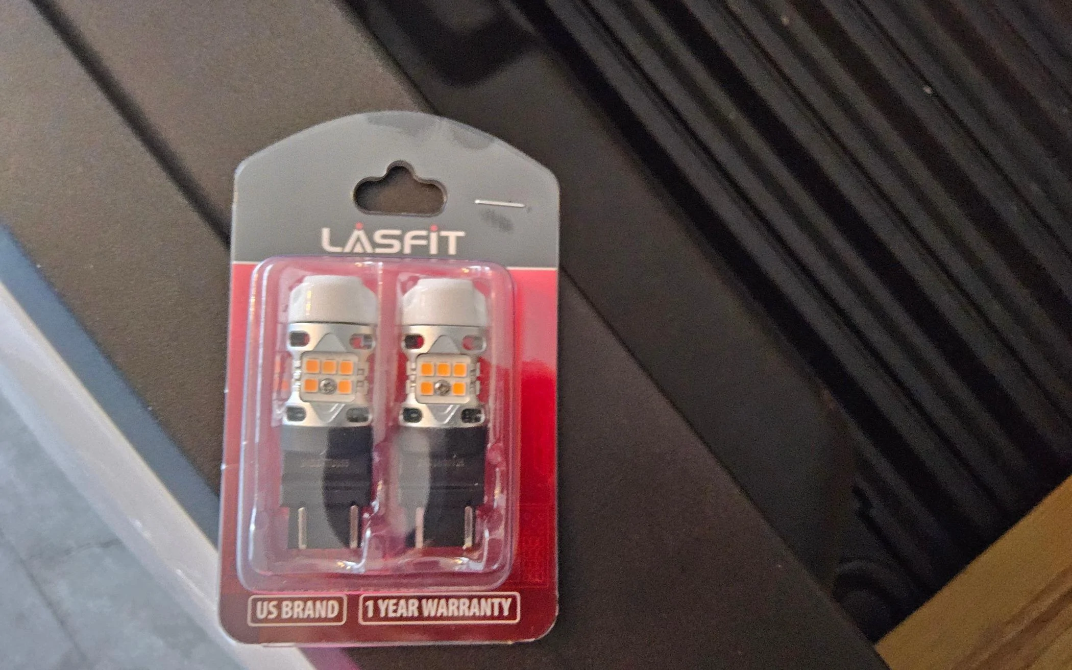

I have newer Lasfits Amber front turn bulbs. Plan to add the 4 rear turn/brake lights.
