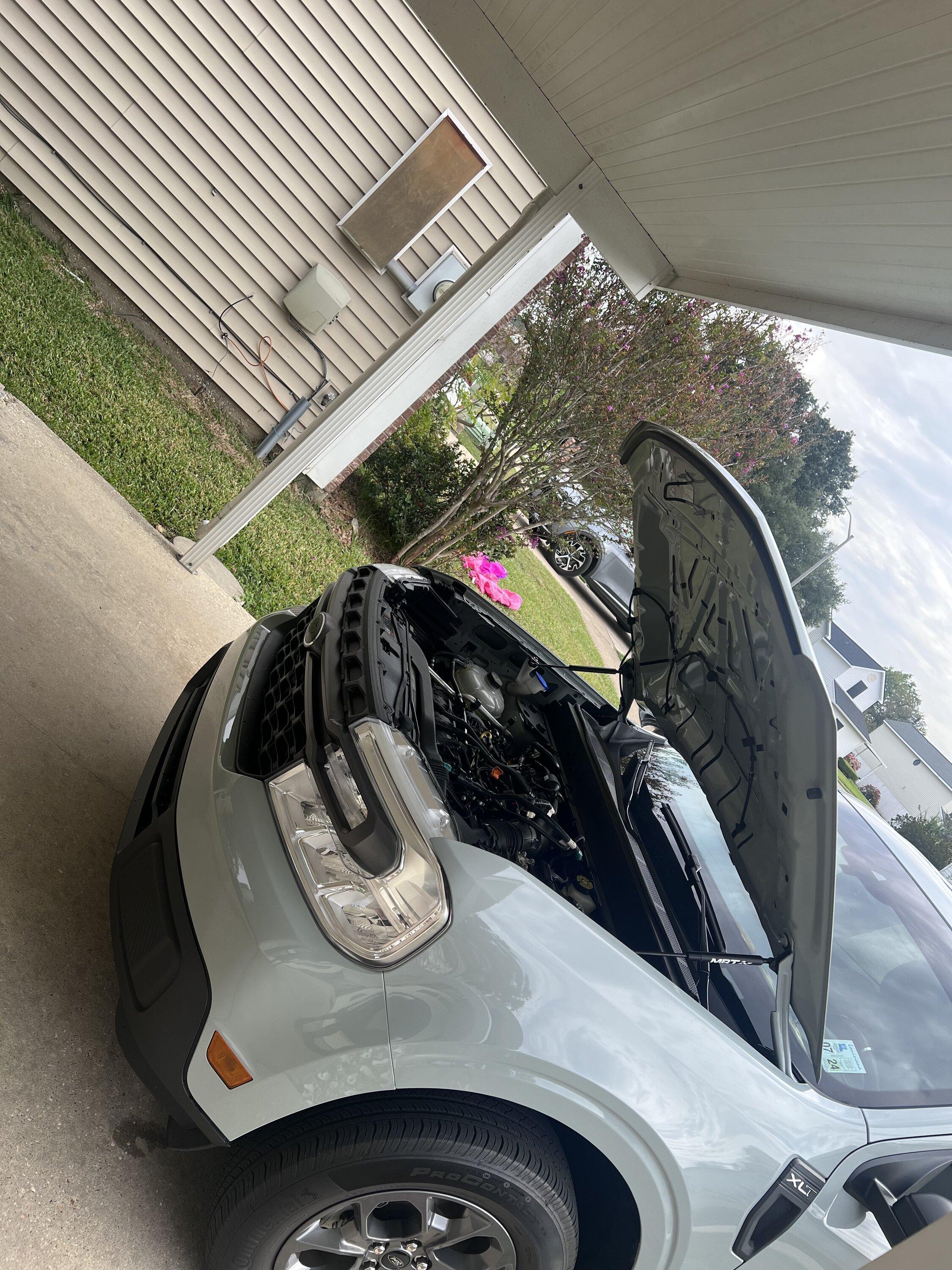

Ford Maverick MRX hood shocks. Must have IMG_0450

So you only remove one bolt each side to install so the hood alignment is not fragged??

6 bolts total to mess with. The hood bolts are reused and was a little tricky but The installation was utube easy.
I installed these back in January of 2022. Install was really easy but I followed the installation instructions to the letter even down to using painters tape on the hood for alignment. My wife helped hold the hood as well which was helpful with hood alignment.
Going almost two years and they have worked flawlessly. Here's an after installation vid I made showing how I marked out the hinges and hood before installation.

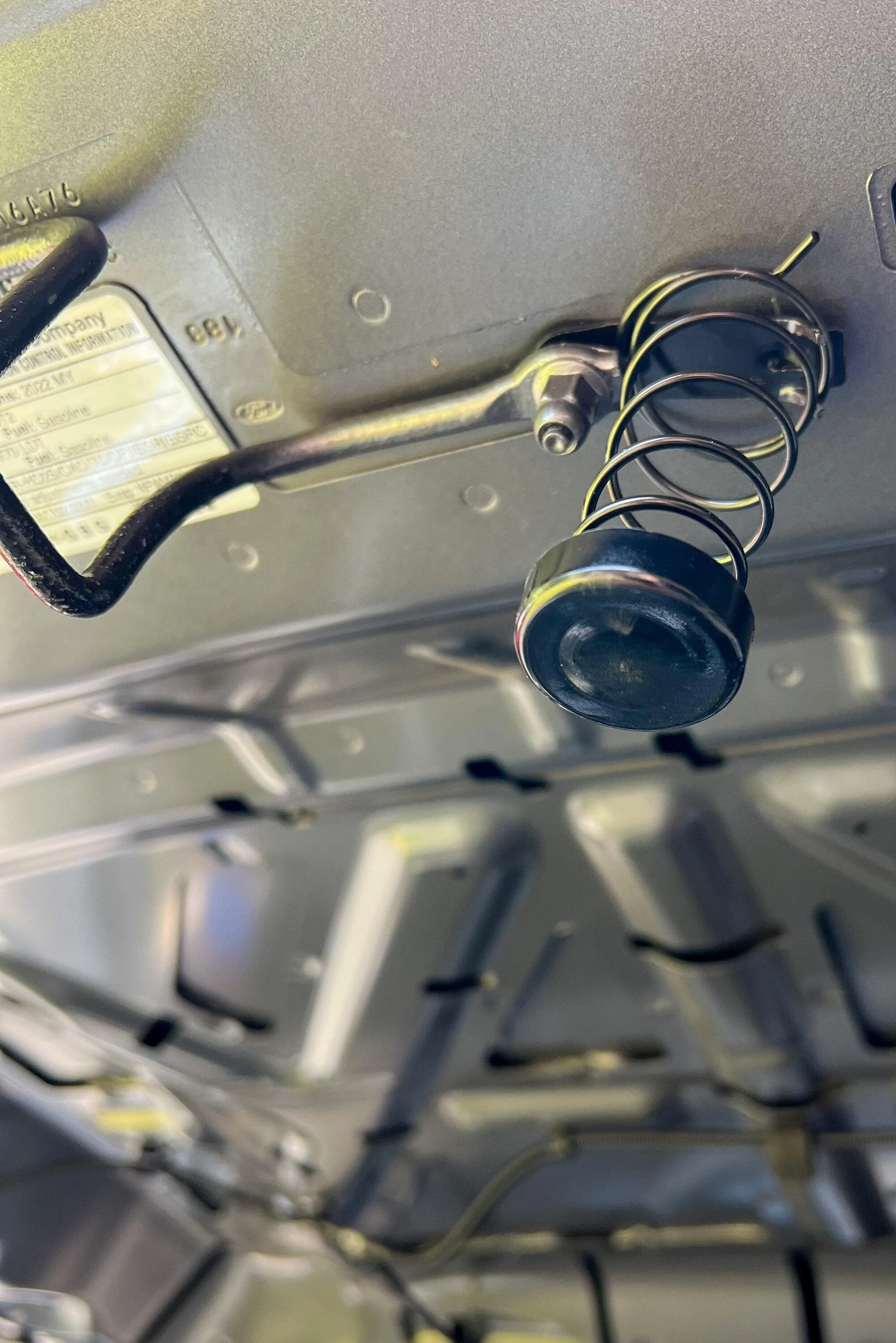

Do yourself a favor and add the $9 hood spring Ford left off to save money. Before I had to pull the hood release several times, get out to see if it unlocked, and repeat until it did.
https://a.co/d/4mClOMU
