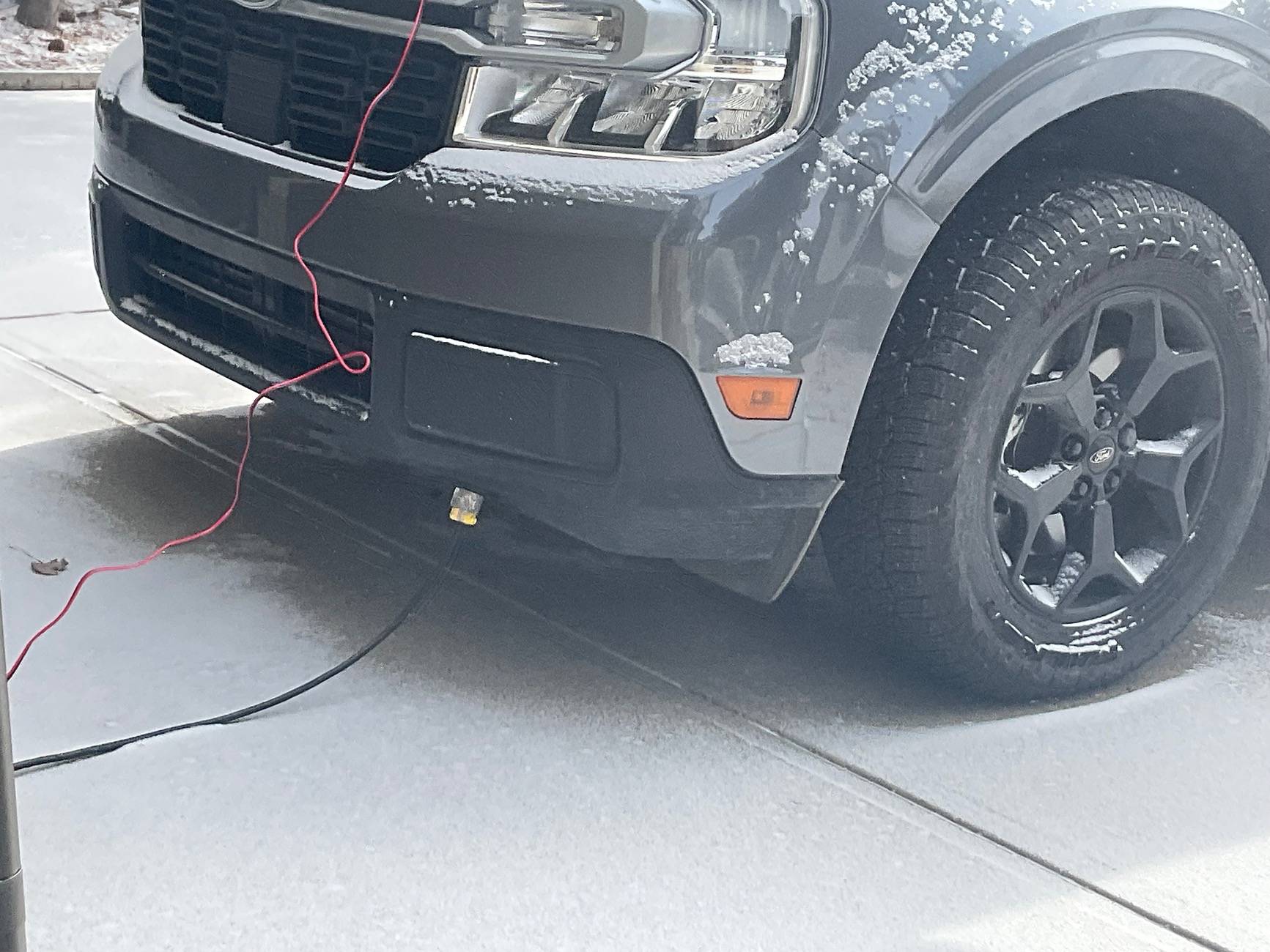

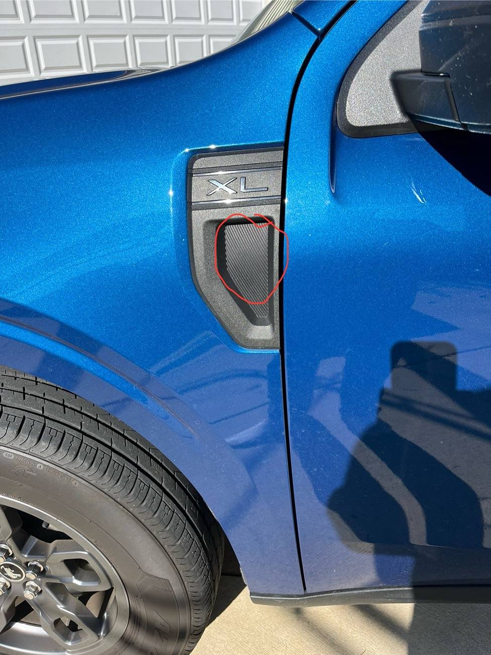

Has anyone come up with ideas on how to mount a exterior plug for your block heater instead of popping your hood each time to plug it in. just looking for ideas I was going to try to go mount one where the side badges is but I cannot find one small enough to fit in the recessed part of the badge.

Perhaps on the underside of the bumper using a protected plug. I think the cord could be routed and the plug installed with just removing the under engine cover as one does when changing engine oil.

I used to have the end of the plug hanging out of the grill a little bit just above the bumper on my old truck.

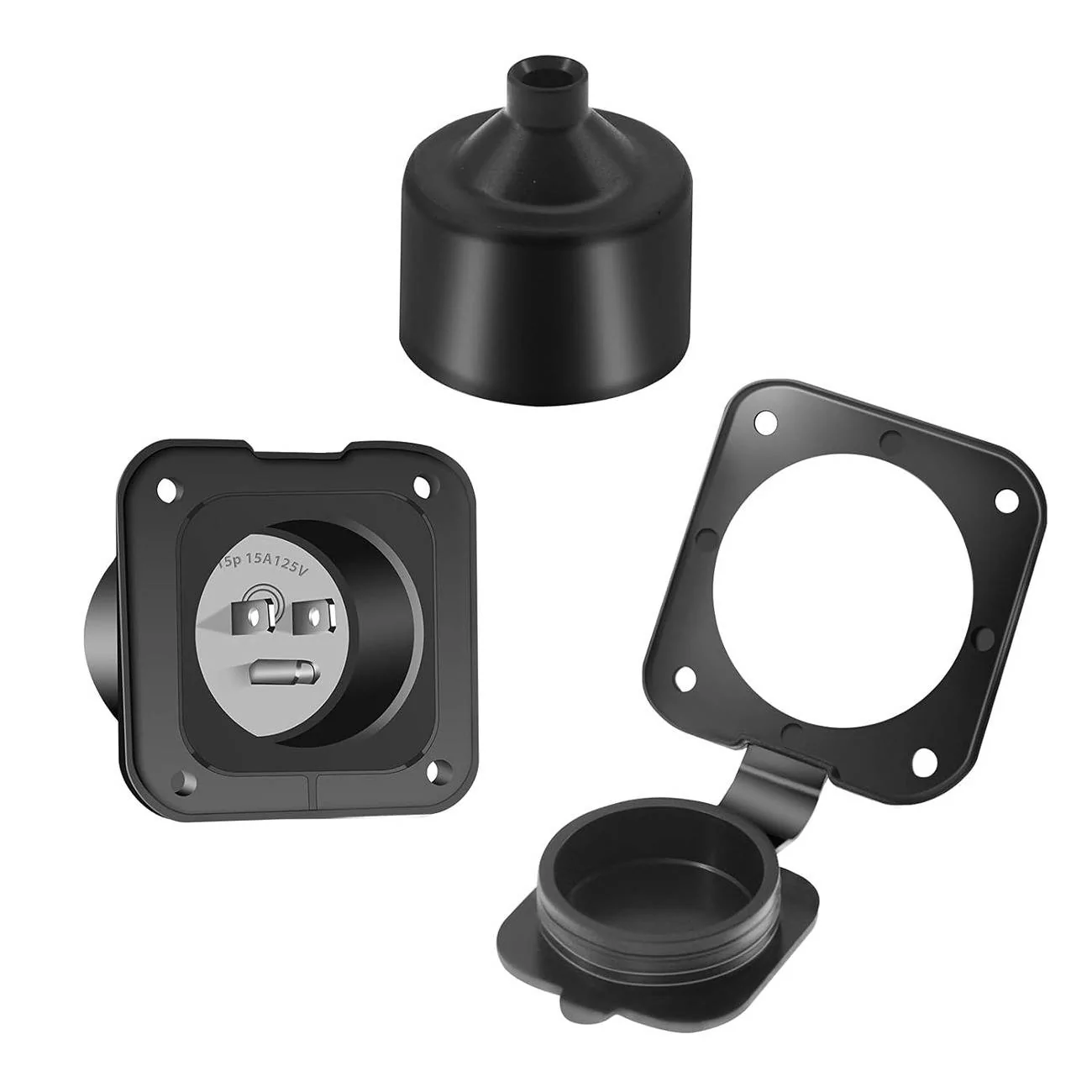

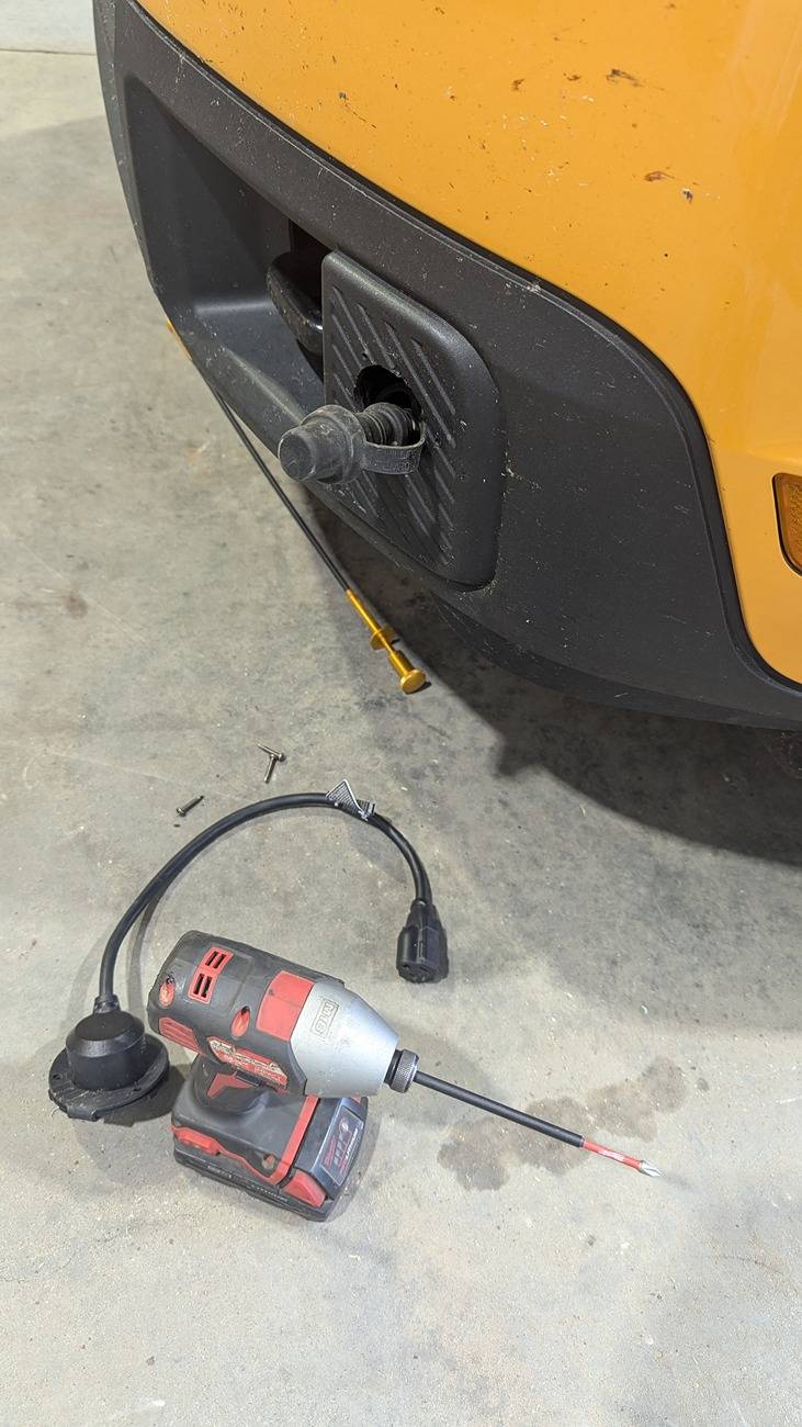

I rerouted the block heater plug to the drivers side, and added an all-weather plug to the cover beside the tow hook. Plenty of space, but right to get to. Block heater plug link
