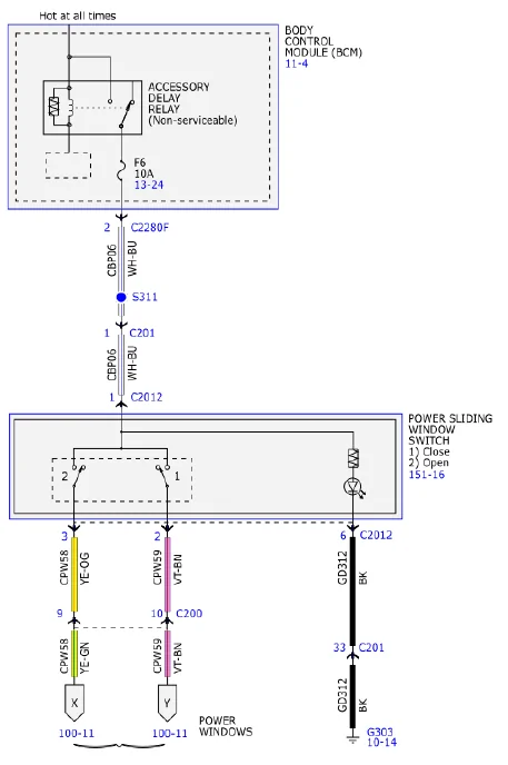

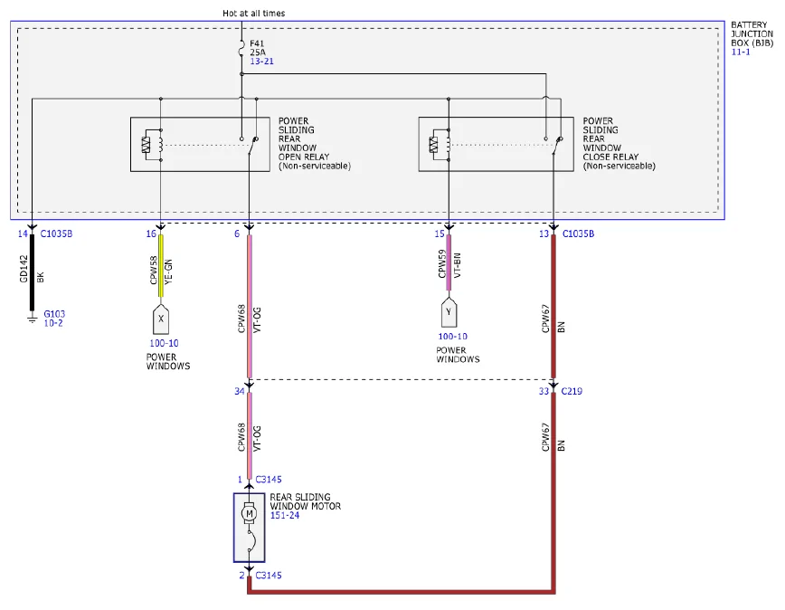

No "Es' in my degree but I'll buy THAT as pretty definitive ... looks like it's back to just REMEMBERING to shut the darn thing !! Guessing (thinking) the same might apply to the MR.
Well sleuthed ... Sir 👍
"Remembering" , I agree, a simple mental effort , but the key to many things in life, including survival.
If I can remember to look left and right and left again before entering an intersection, I should be able to remember to close my sunroof.

Looking at the circuit and operation description the moonroof is a pretty self-contained system; it doesn't have any sort of communication bus connections. The switch just grounds either open or close trigger terminals on the motor assembly/module. The motor/module assembly is on the Accessory Keep Alive circuit so that's shutting off as soon as you open a door after key off.
