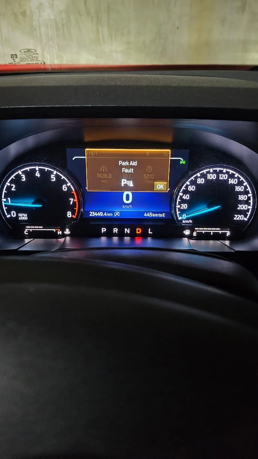

Hello @JX77 , Ive just had a few hours of testing and I think I'm a bit closer now.
Actual status:
I've detected the PAM with forscan and also, I have the park aid and distance detection on the display. So, the system does work. I installed the sensors on the rear bumper and everything seemed to work fine. (look at pictures on my previous post)
But I scanned with forscan and found I have DTC on the PAM.
The As Built that was initially detected by default is as follows:
736-01-01 0000 0000 80BF
736-02-01 8000 2100 0FF0
736-03-01 801E 1E00 00FD
736-04-01 0000 0000 0042
With that configuration Im getting this DTC:
Code: U2100 - Initial Configuration Not Complete
Status (-2A):
- DTC Present at Time of Request
- Malfunction Indicator Lamp is Off for this DTC
Module: Parking Aid Module
I tried the configuration you posted and got the following 3 codes:
Code: U0553 - Invalid Data Received From Lighting Control Module-Rear 'A'
Additional Fault Symptom :)82):
- Alive/Sequence Counter Incorrect/Not Updated
Status (-68):
- Previously Set DTC - Not Present at Time of Request
- Test not complete
Code: U0423 - Invalid Data Received from Instrument Panel Cluster Control Module
Status (-68):
- Test not complete
Code: U0415 - Invalid Data Received from Anti-Lock Brake System (ABS) Control Module 'A'
Status (-28):
So my guess is that we need help to find the correct hex data, from a Maverick just with the rear parking aid and no other 360 features. Anyone can help?

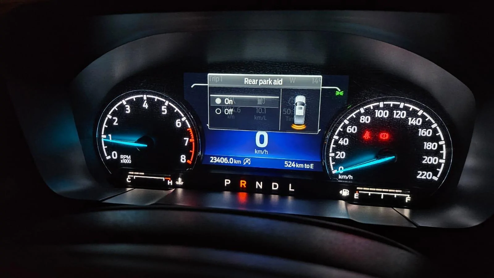

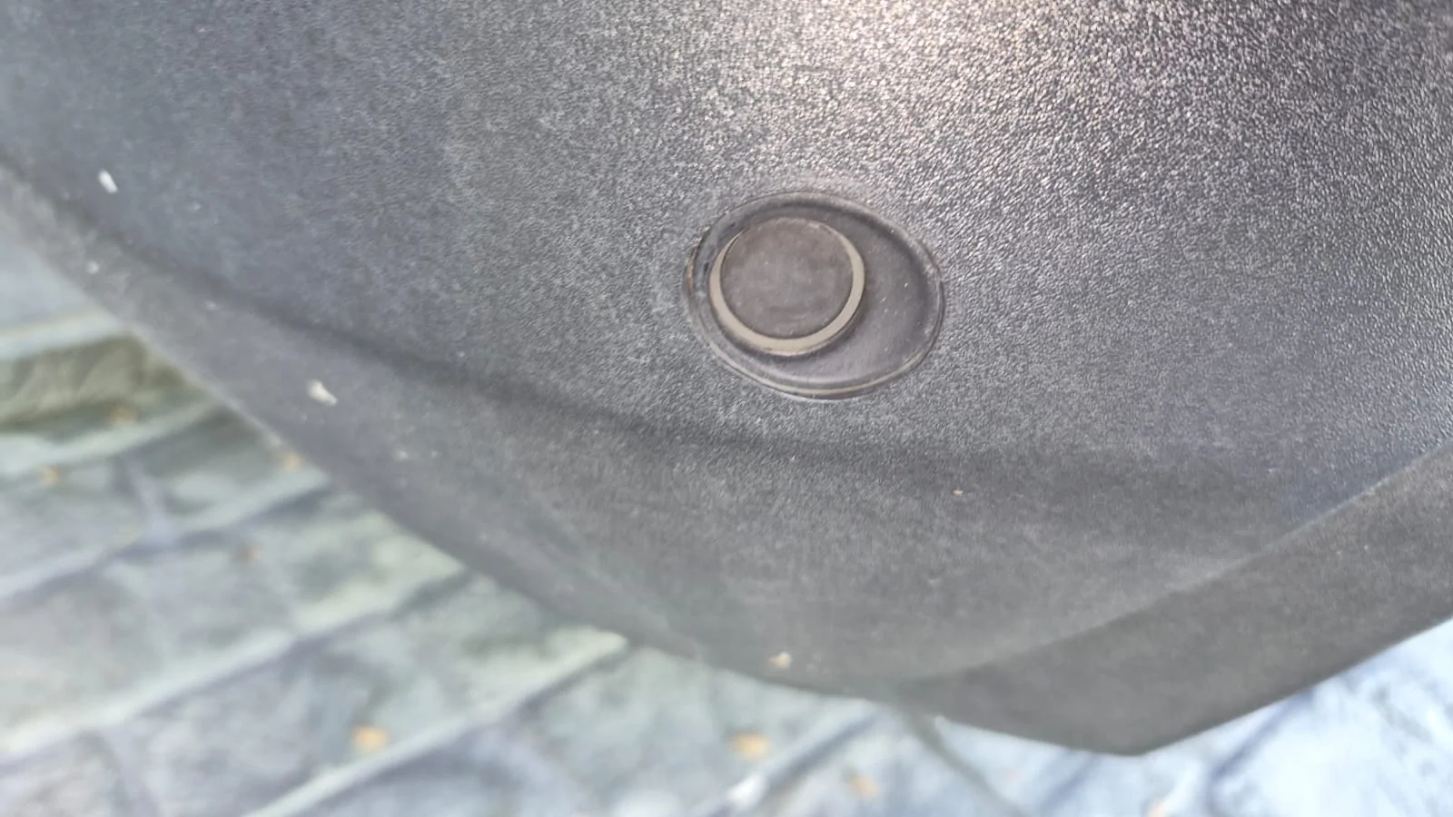

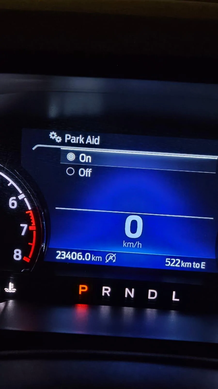

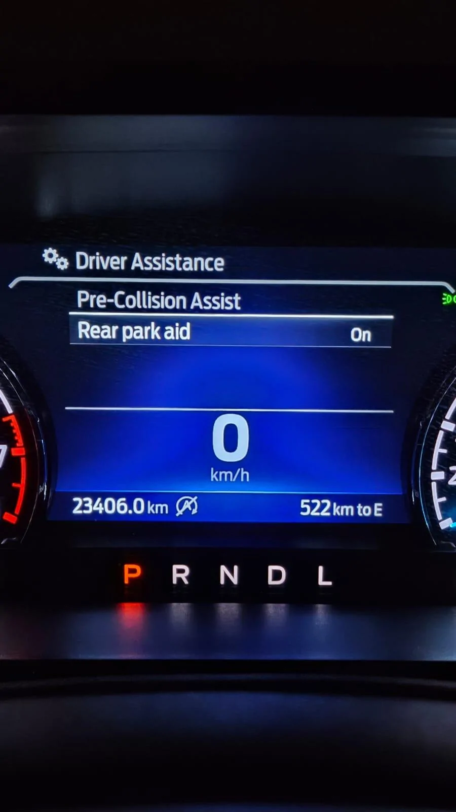

Sorry for the "very" late reply...Ive atteched a few pictures of the installation, very similar to a stock rear aid.
You don't need a separate speaker it will use the radio speakers and lower the music volumen automatically when reversing.
I was about to drop this project because it was impossible to activate the PAM with FDRS after paying twice for a 2 day licence and the non activated PAM was drying my battery after a day of non driving. The final step for completing this projects was buying a used PAM, that was already activated on another Mav. So I've been flawless using rear parking aid for a few weeks now, no codes.
