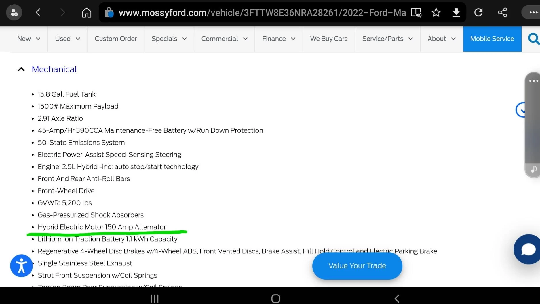

Aftermarket 12v inverters are an option, but for a 2000 watt inverter, you can expect a 170a draw on the 12v system. Which is a lot to ask of a DC/DC inverter rated for 200a total and a 390a battery, and underutilizes the hybrid components.
Is the DC/DC max 200amps or 150amps? I can't find any official specs besides dealer truck listings that show 150 amp alternator equivelent for hybrids, are they accurate. Trying to size aftermarket inverter to hook up directly to battery. I will stay well under the max amps of system, but need to know max amps it can handle.

So the 200a I quoted was what I knew from the last gen (Fusion/CMax) Hybrid DC/DC step down converter. I honestly didn't know the rating of the new liquid cooled system. The service manual doesn't list an official "rating", just that the converter is capable of delivering "Up to" 265a. To me, I'd say that means the converter should be good for well over 200a, probably more like 250a consistently. A little more digging and I found the standard alternator for the 2.0l EcoBoost is 150a while the upgraded alternator, available when equipped with the 400 watt AC outlet, is rated at 190a.
I'd imagine the literature the dealer quoted was generic info, considering the hybrid Maverick doen't even have what you could consider an "Alternator."
