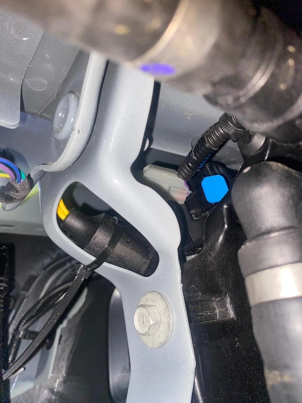

Finally installed the MegaOhm device on my 2024 Hybrid Maverick. Love it!!! Included directions okay… Tire removal unnecessary. Removed rock guard, A man with large hand and nimble fingers can install in 30 minutes. Tight space for large hands, minimal cussing, but doable. Zip tied to frame. Works fantastic! The best $$$ ever spent.
How did you get behind the computer module in that wheel well? I can see the speaker but can't access it from the bottom and the computer module (?) is in the way

So all we really need is the male components to bypass the speaker with the resistor?
As I recall and noted above, the female connector would merely act as a debris cap on the speaker. So yes, functionally you’d only need the male to connector and terminals to wire in the resistor and thereby inhibit any CEL or throw a DTC. Sorry it’s been a while since I did this and I didn’t take any notes or pictures.
