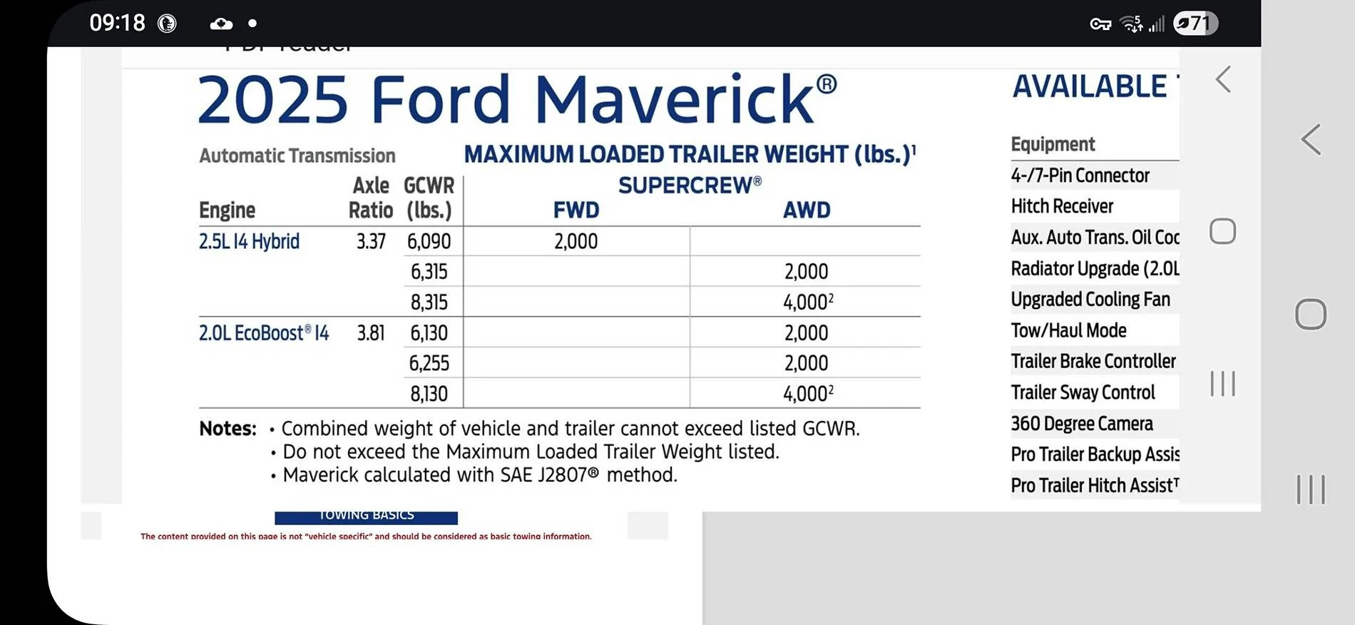

Tongue Weight does not impact GCWR, it only impacts Payload you can carry in the Truck (which includes passengers). The equation is GCWR = Kerb Weight + Payload (Truck) + Trailer + Payload (Trailer). Think of a stationary empty Truck and empty Trailer. Then GCW = Kerb Weight + Trailer. The Trailer exerts a downward force on the Truck which is like adding Payload, but does not impact the total combined weight.
When vehicle manufactures publish tow ratings they are using the J2807 Standard. This is a rigorous set of criteria that a vehicle towing a trailer is subject to (such as climbing a steep gradient in 40 C weather as well as emergency braking).
Here is a summary of J2807:

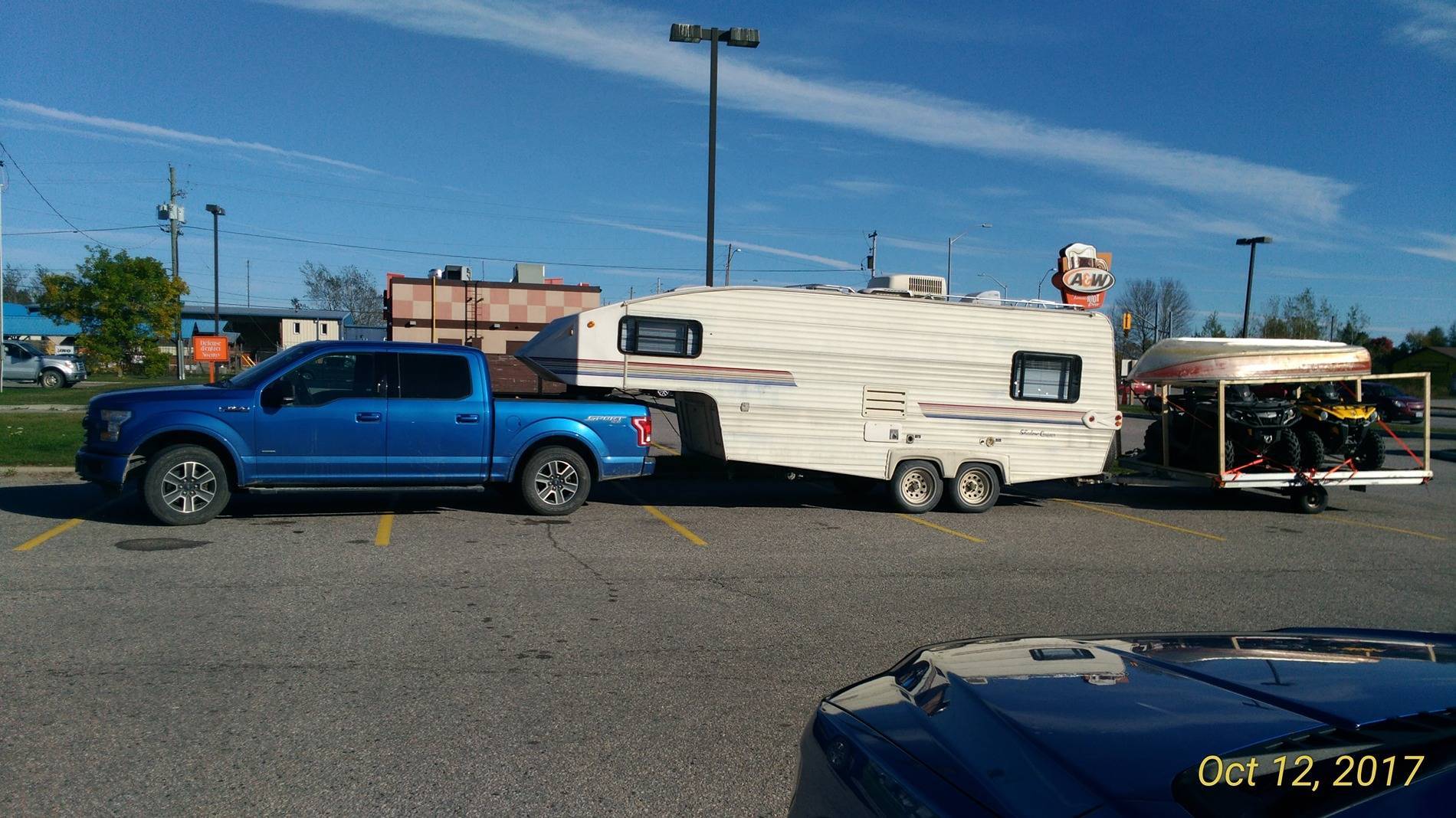

My 2 threads "so you want to tow a trailer, eh?" Thread and this one are aimed at providing info, to some who dearly need it but don't know it, and those who want to get an idea on how to tow without learning it the hard way.
Quick story, I had my travel trailer, F150 w/Anderson WDH w/designed in anti-sway) heading north for the weekend...another truck with a heavy old travel trailer (no WDH and a need for speed/being in front) go into a "tail wagging the dog"scenario while passing me...not terrible, I imagine he didn't have his hitch weight adjusted properly.
We all got out of it okay, but he did decide to slow down till his turn off. You can't unlearn that, if you recognized what just happened! And here we are...
