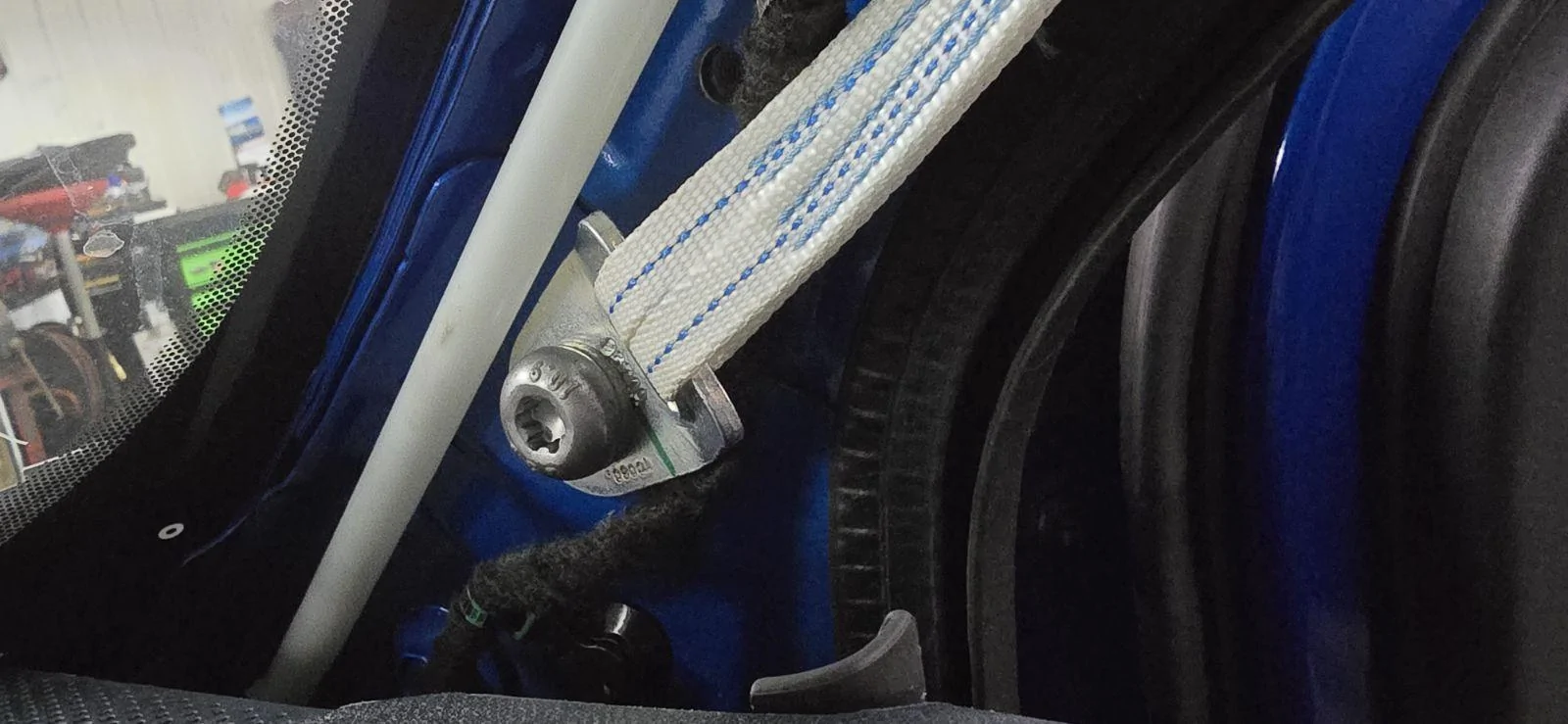

I just got back from the dealer (not the one that did the recall work). They determined that the recall dealer that did the side curtain airbag recall pinched the harness and, over time, caused it to fail. Here's the picture they took of the harness running down the A-pillar. It's the black harness caught behind the silver buckle with the white strap.
Ford Maverick Maverick Keys reprogram? image000000001
They suggested I go back to the recall dealer and have them fix it. My guess is that it won't be considered warranty work and the dealer today wouldn't get paid by Ford. They didn't charge me anything for the hour or so it took them to diagnose it, either.

I got my truck back today and it's all fixed, although it took 4 business days. They confirmed that the wires were crushed by the buckle in the A-pillar as a result of the side curtain airbag recall work.
Interestingly, that fault also caused the TPMS light to come on well after the key fobs stopped working and stay on solid. Once the wires were repaired, the key fob and TPMS problems both went away.

Based on the invoice, it looks like they used a wiring repair kit rather than replace the entire harness. I'm OK with that since it meant they only needed to remove the A-pillar cover instead of getting into a lot more of the interior and dash areas.
Of course, now the repair needs to hold up.
