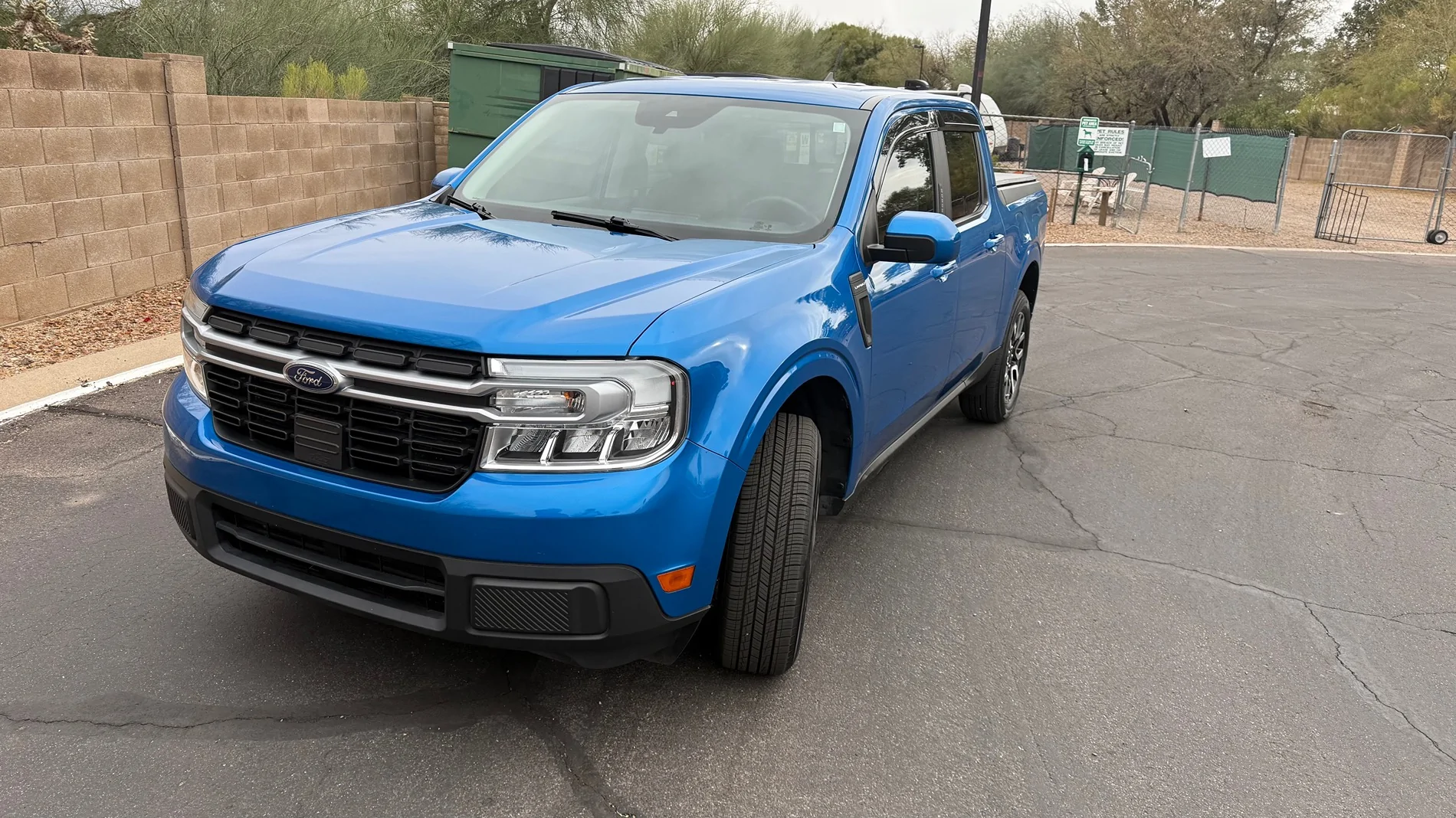

I Recently purchased a 2022 Lariat and was wondering is there any way to discover the code for the keypad. My local dealer was no help
Ford Maverick Key Pad reprogramming IMG_4924

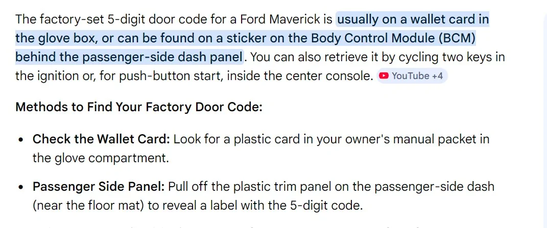

Adding to post #2 from HRG.
I hope this helps.
From your picture I see that you've got a wired keypad.

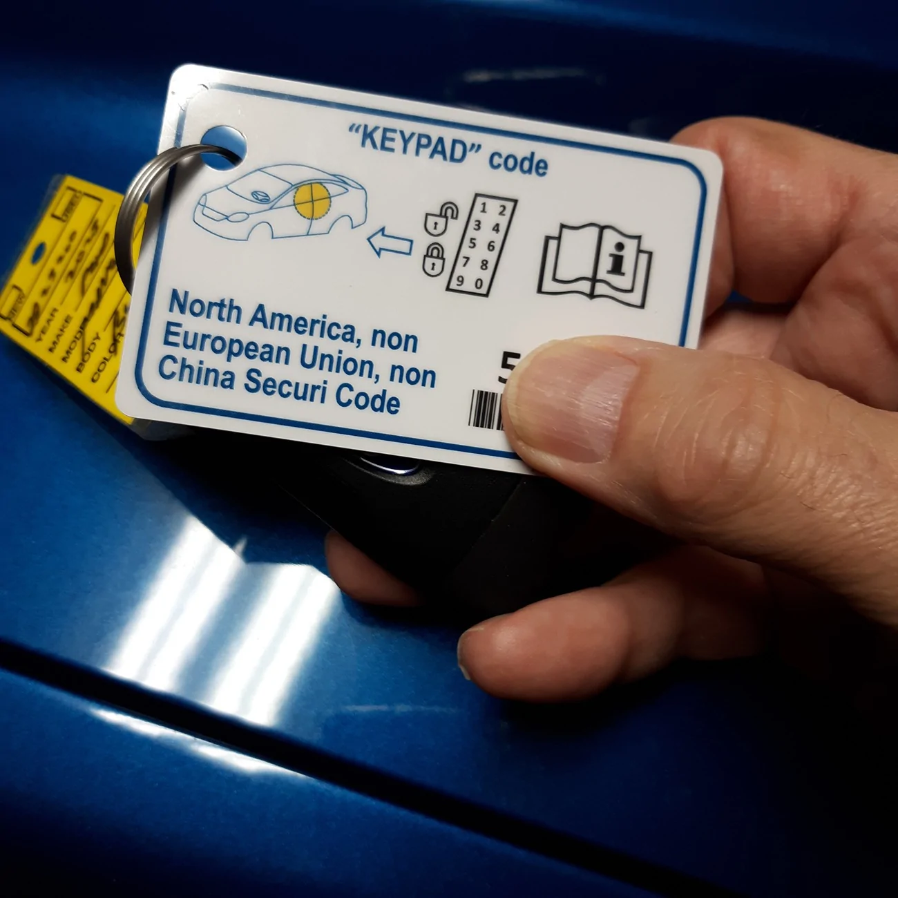

I am guessing that you do not have the cards that came with the keys that had the code they look like this👇
Ford Maverick Key Pad reprogramming 20260424_083737
There are other places on the truck where the code is located.
