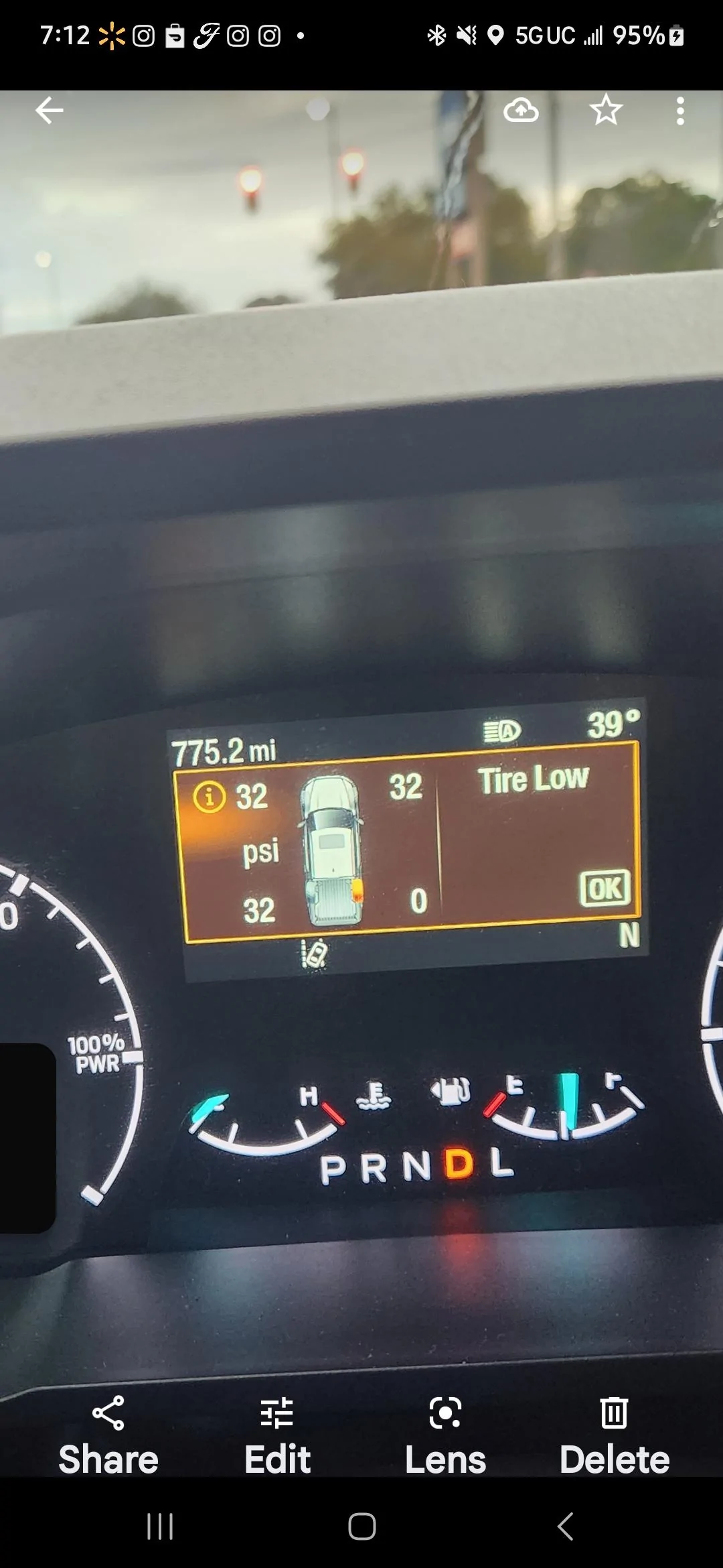

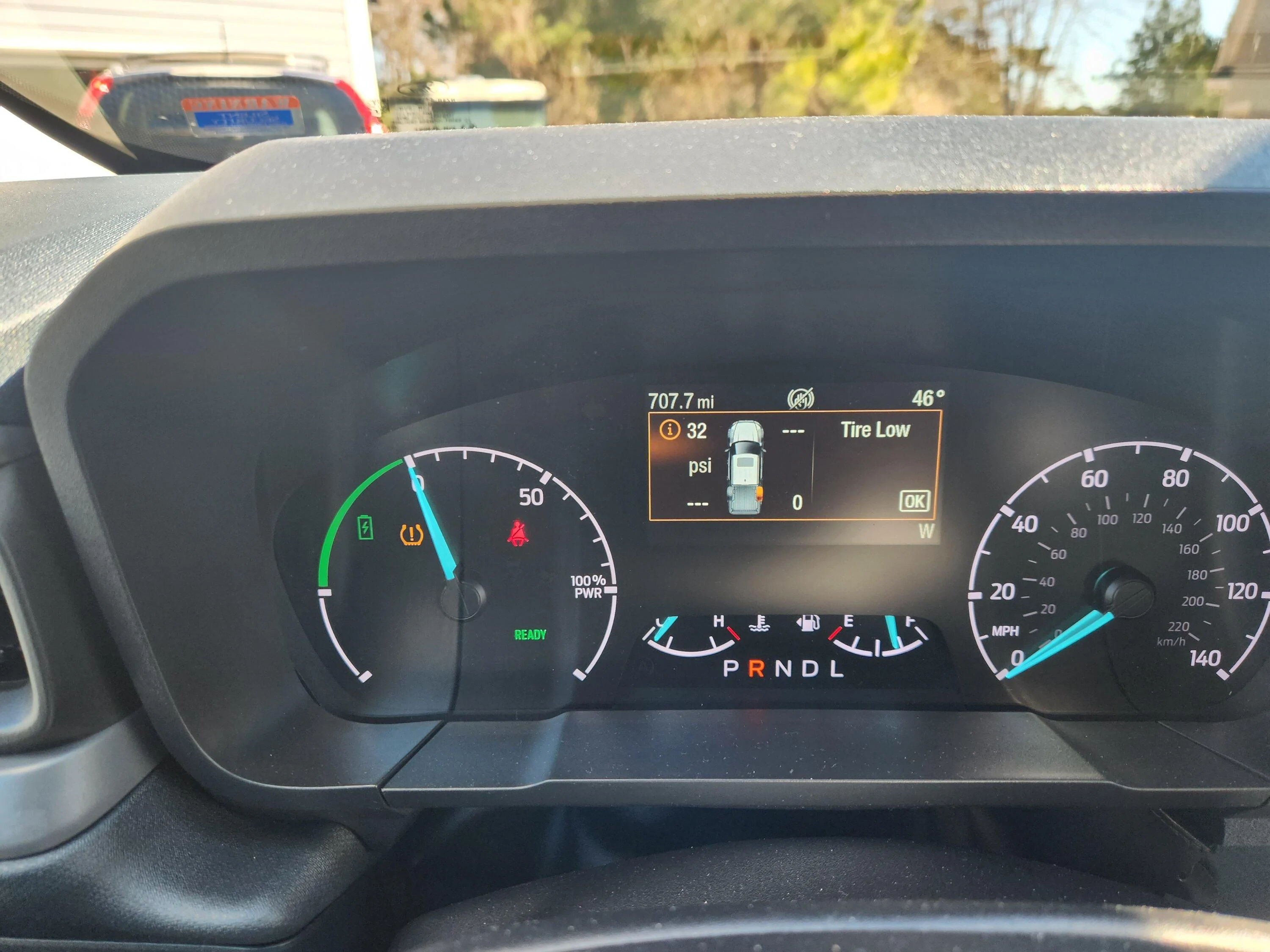

I installed a set of 2022 Bronco Sport rims and tires on my hybrid. I’m getting the low pressure error. It says right rear but I have 35 in each tire. I’m thinking the tpms in the bronco tires aren’t compatible. I still have the tpms from the other tires. Can you just remove the sensor from the valve stem?

Do you think I have a bad sensor right rear?

OP, have you changed your spare tire in any way? If not, I would move the tire in question to another position and drive it for a day to see if it relearns.
The TPMS could have been damaged during installation.
All your tires appear low.

I have 35 psi in all of them. Not reading correctly.

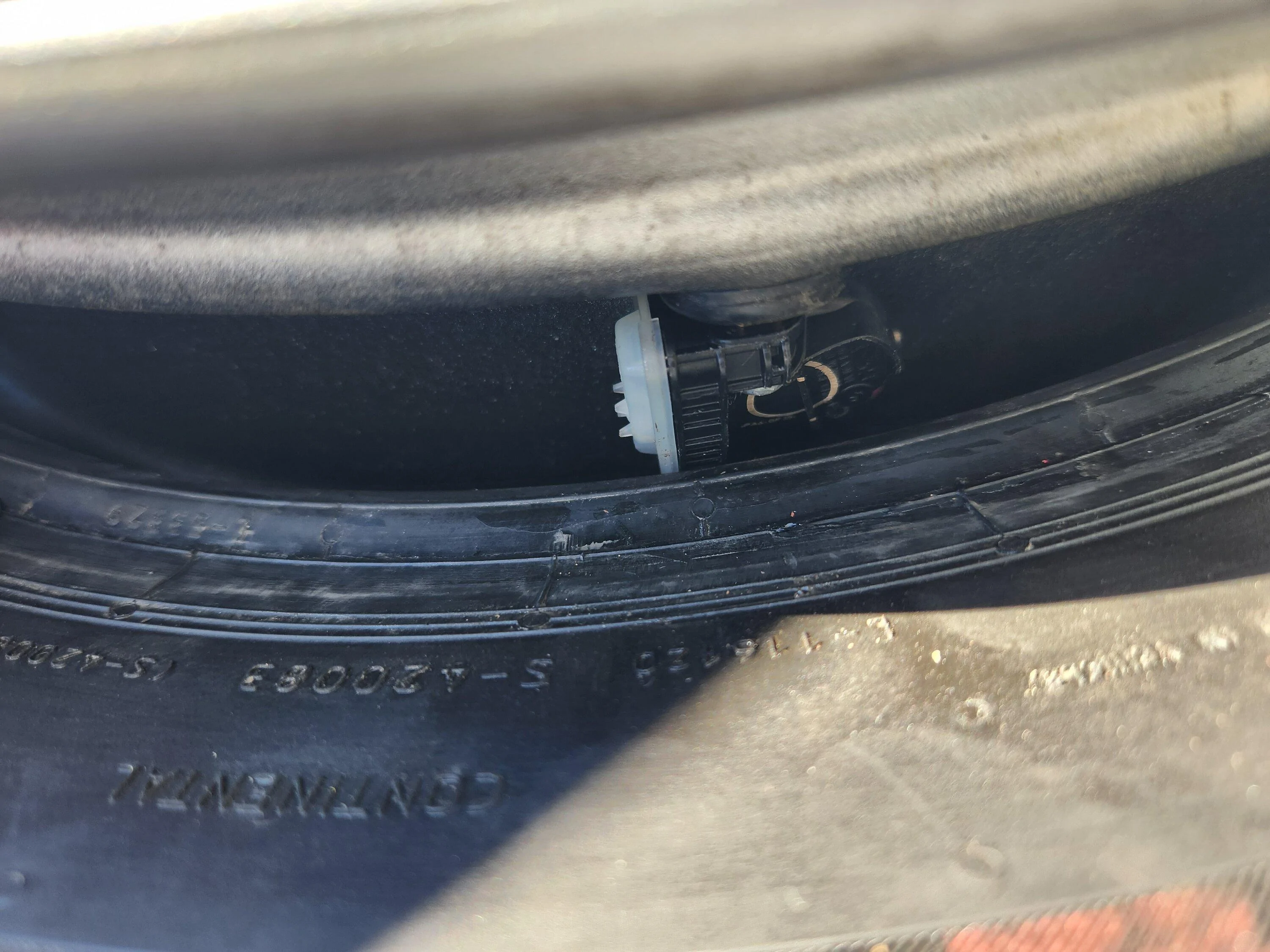

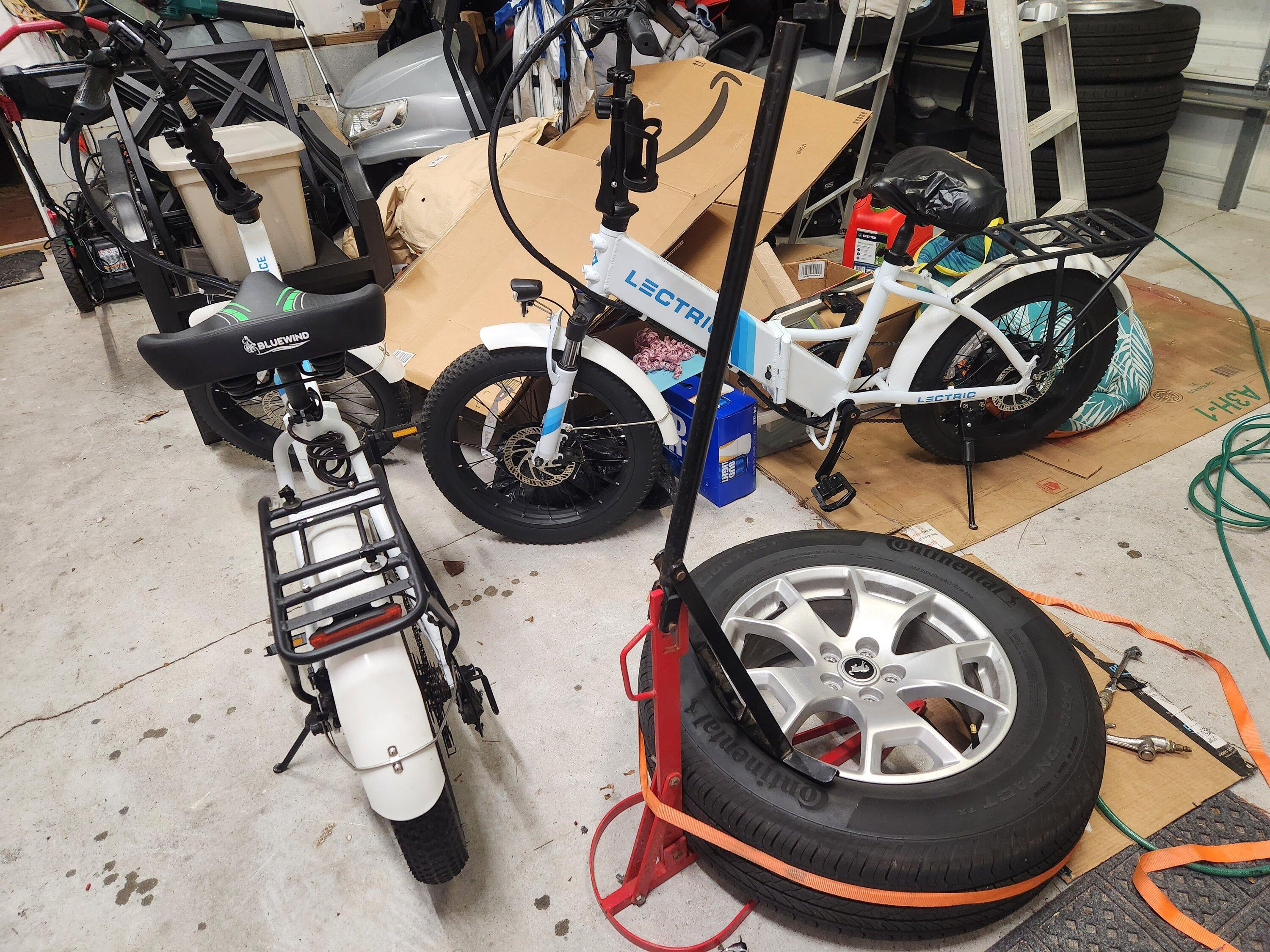

Well,,,,,,, come to find out the rims I bought from the guy didn’t have sensors in them. Put the sensors in (with the help of my cheap harbor freight bead buster) from the steel wheels and all is fine now. If anyone needs to know the screw holding the sensor to the valve is a number 10 star bit.
