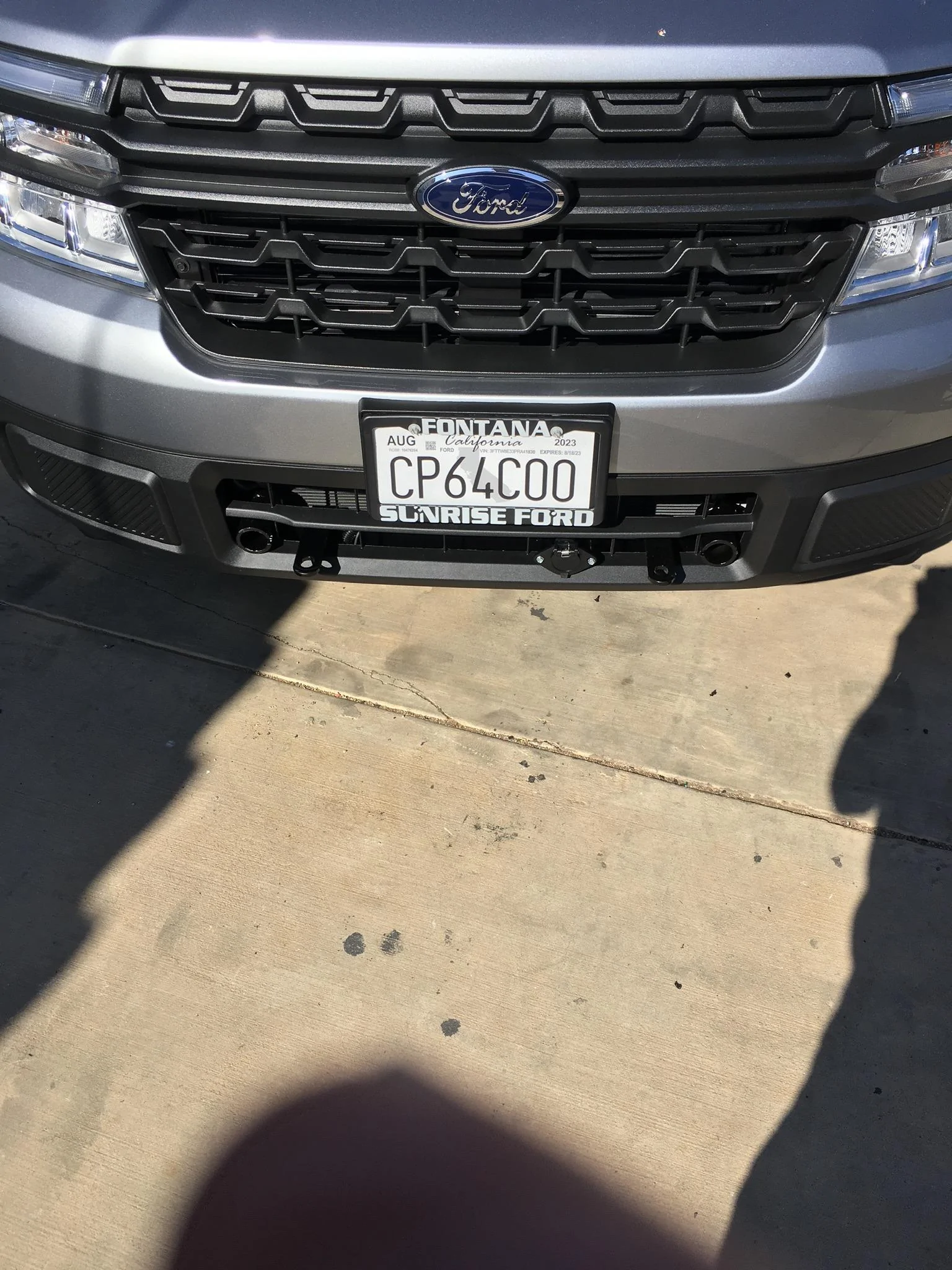

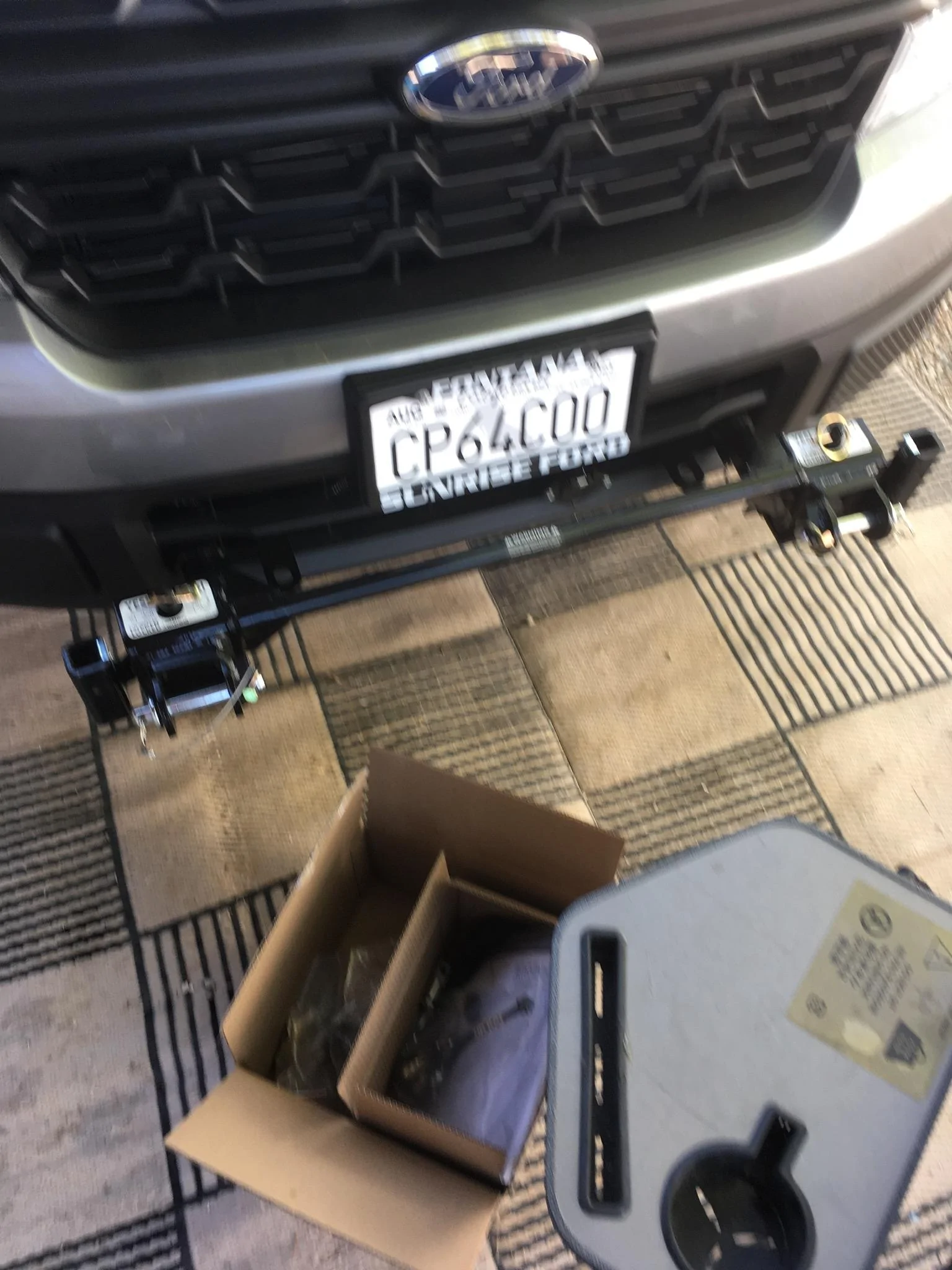

I just had mine installed going to try it out tomorrow. The install looks good less cutting than I thought.

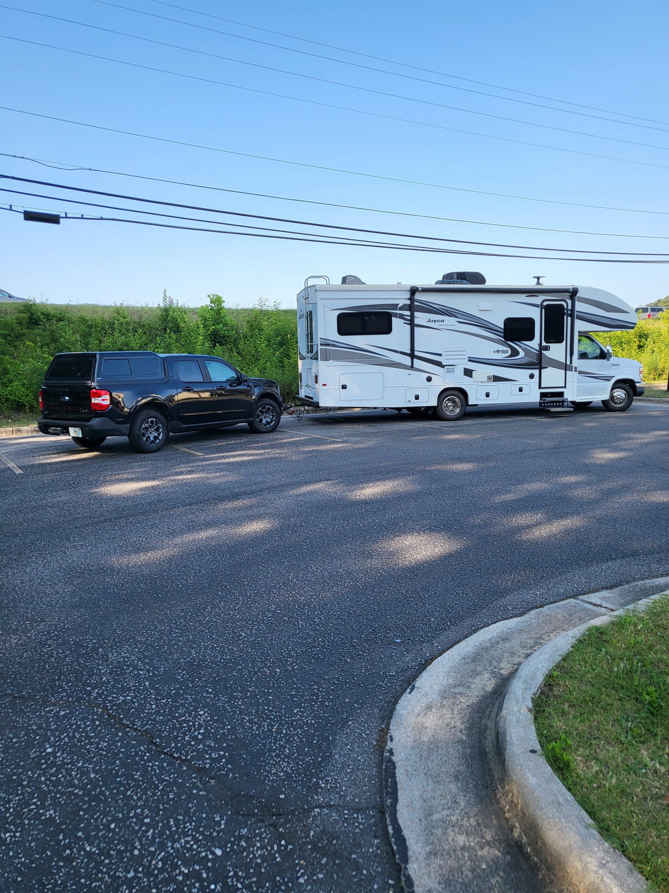

I had my Road Master base installed on my 23 XLT about a month ago with the invisibrake system just did a 1400 mile trip towing behind my motorhome from FL to NY alls good tows great
Nice setup Bud!
We have a very similar motorhome and setup.
Will do first trip with it in January.
Happy trails!!

Nope mine installed 7 months ago and towed over 5000 miles all good
