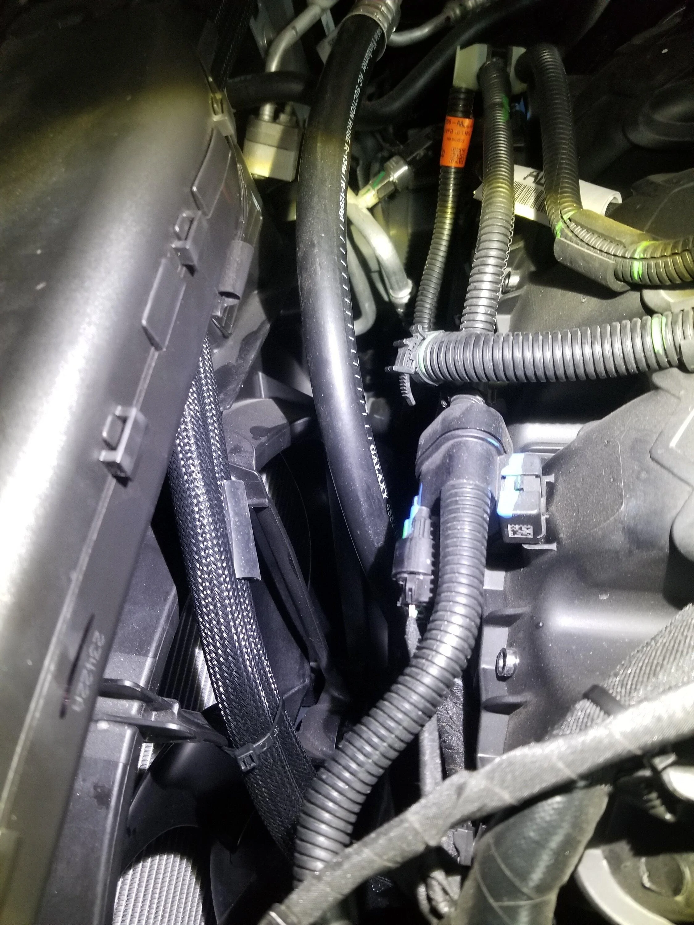

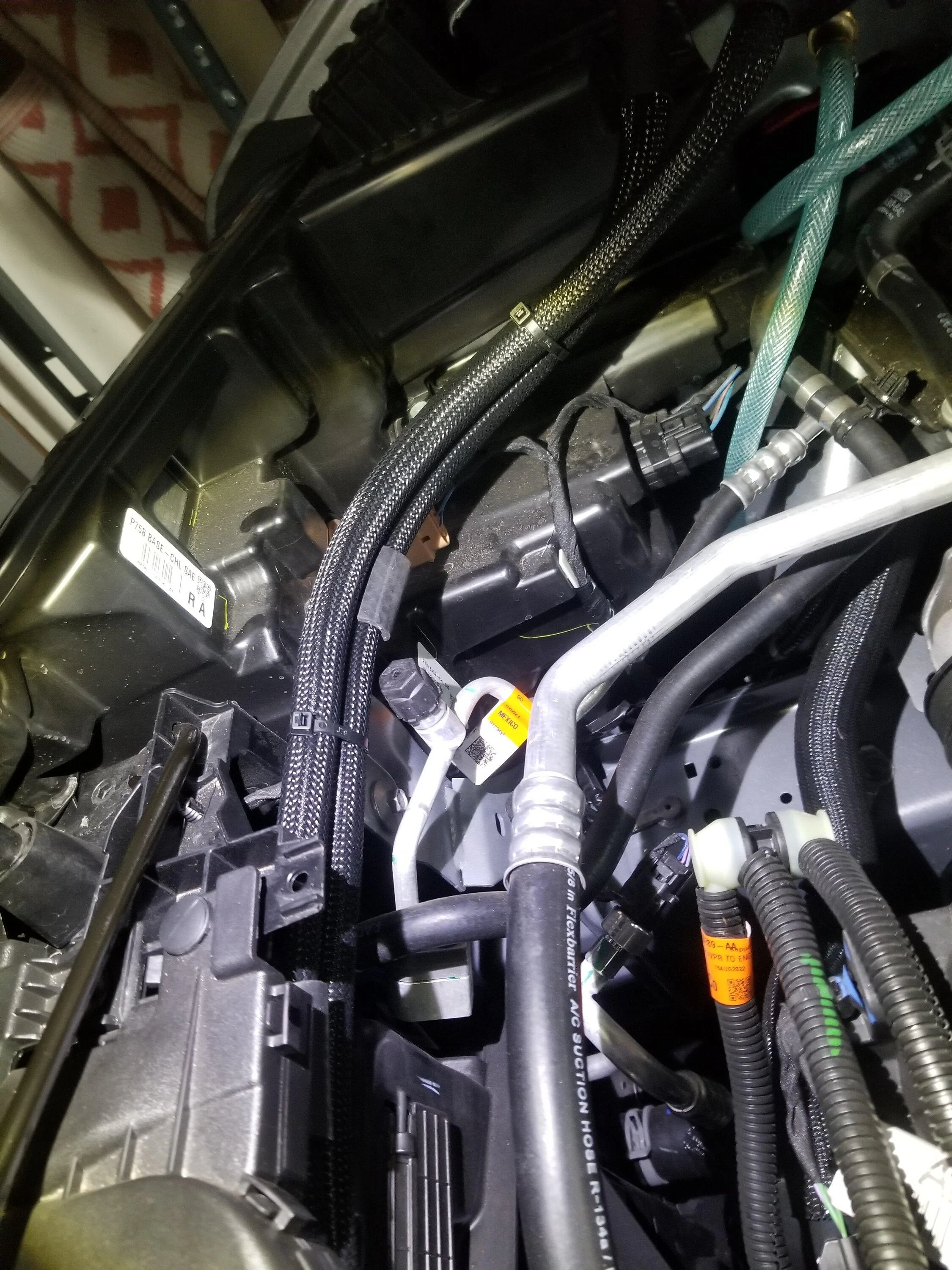

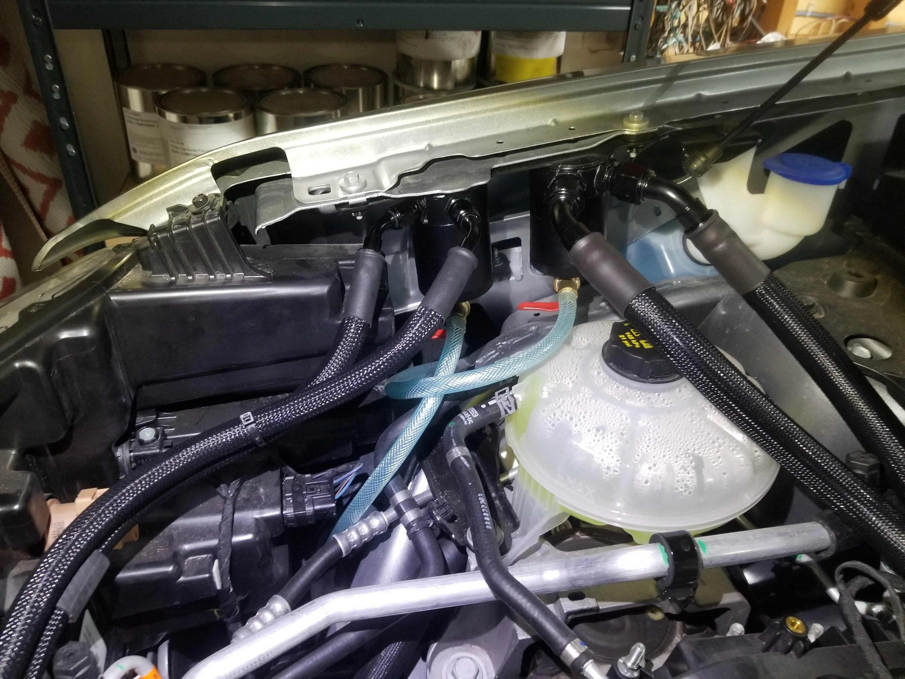

I finally plumbed in the lower lines for the second catch can. Holy crap is that tight. After you remove the intake tube from above the radiator, you can reach in there and feel the tubes. You have to do damn near all of this by feel, and with a mirror on a stick. The orange colored hose nipple on the engine side is the "out" side from the crankcase that goes to the "in" on the catch can. The "out" from the catch can is what goes to the intake, or black hose nipple on the engine.
I put woven coverings over all the hoses to give it all a "stock" appearance. I plan to get hose separators, and make up a few brackets to support the 3/8" hoses that run to the lower side of the system and prevent them from rubbing on things. For now I cut some hose pieces to put over them where they rub, and i zip tied everything together.

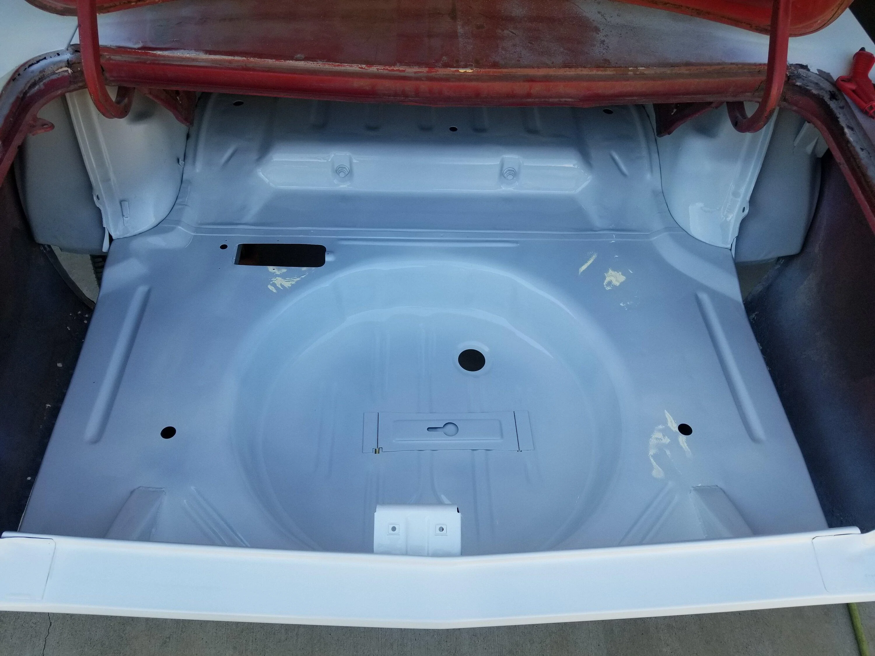

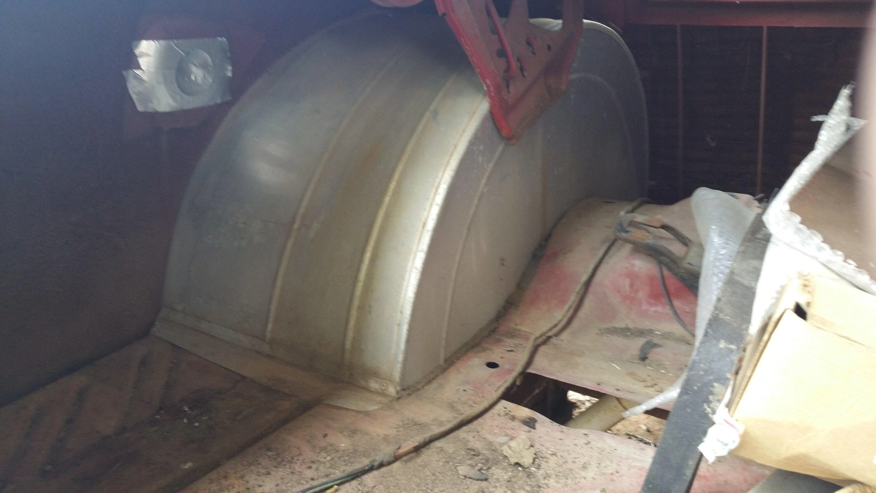

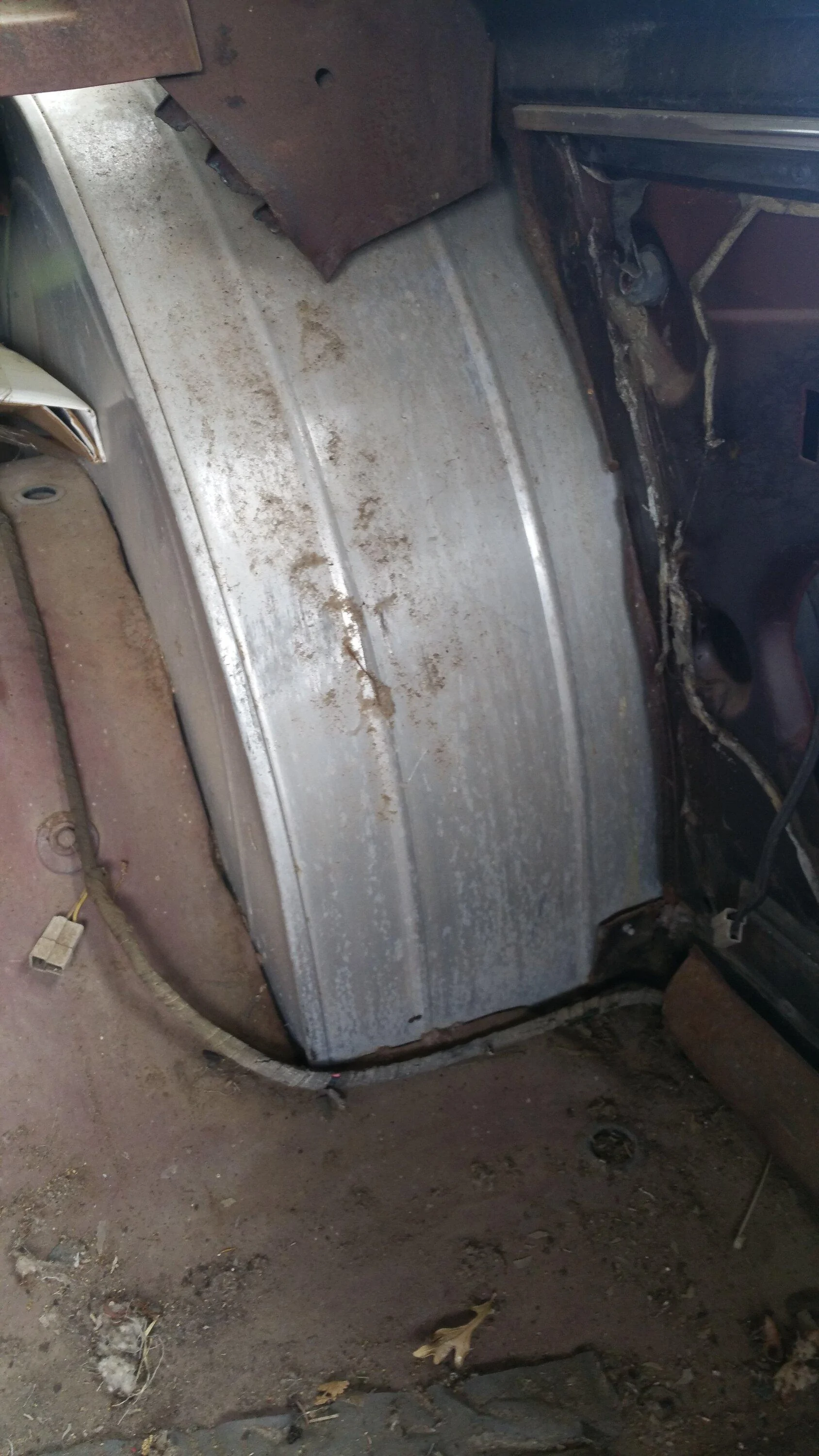

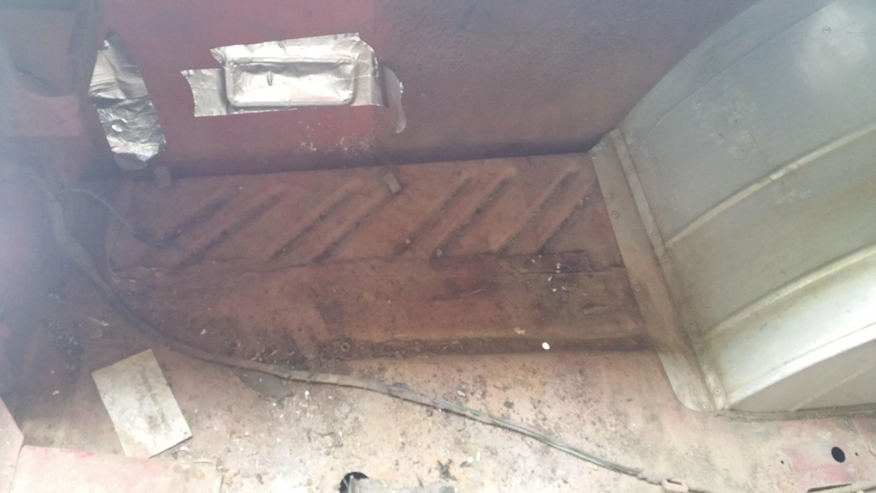

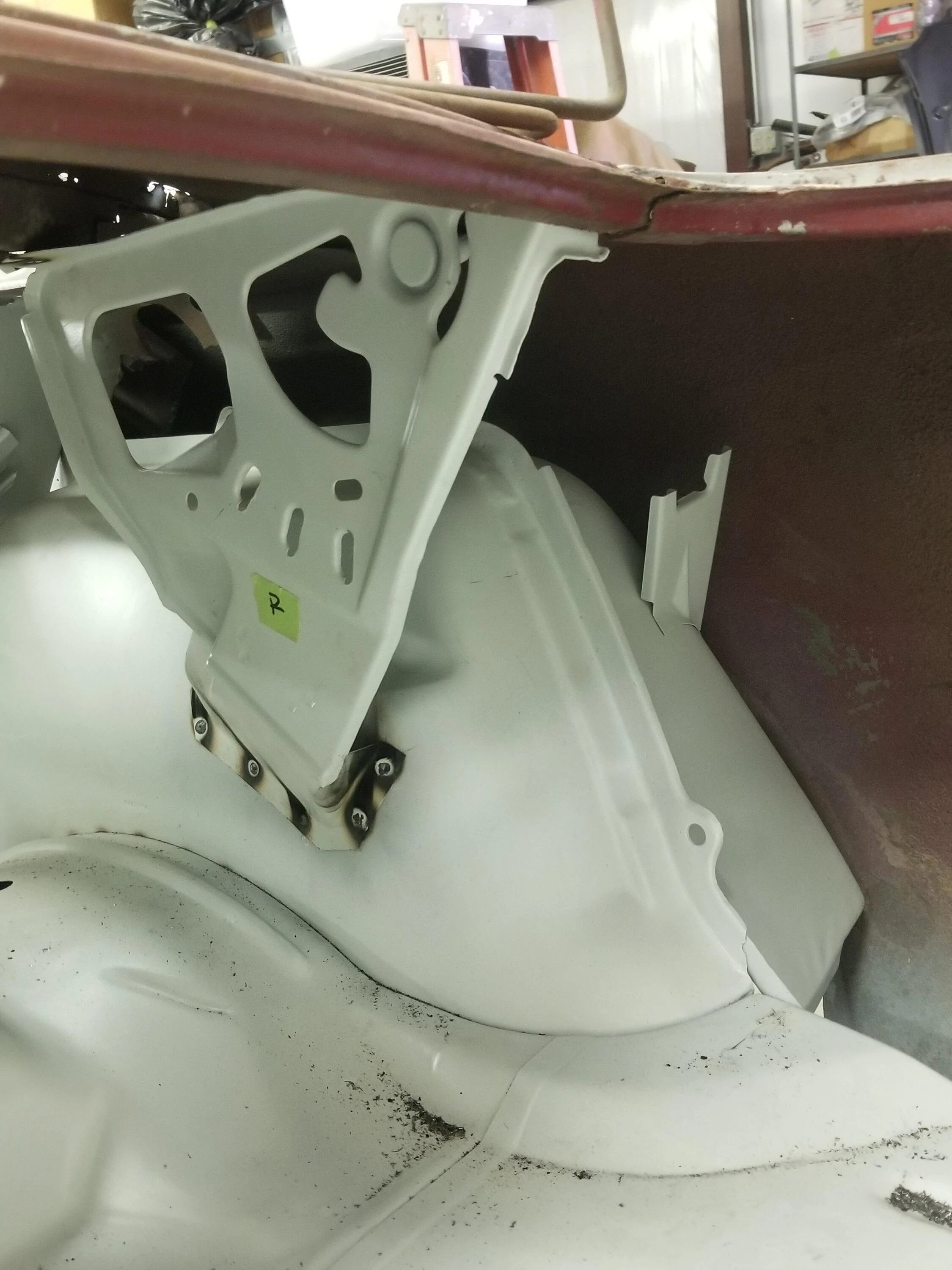

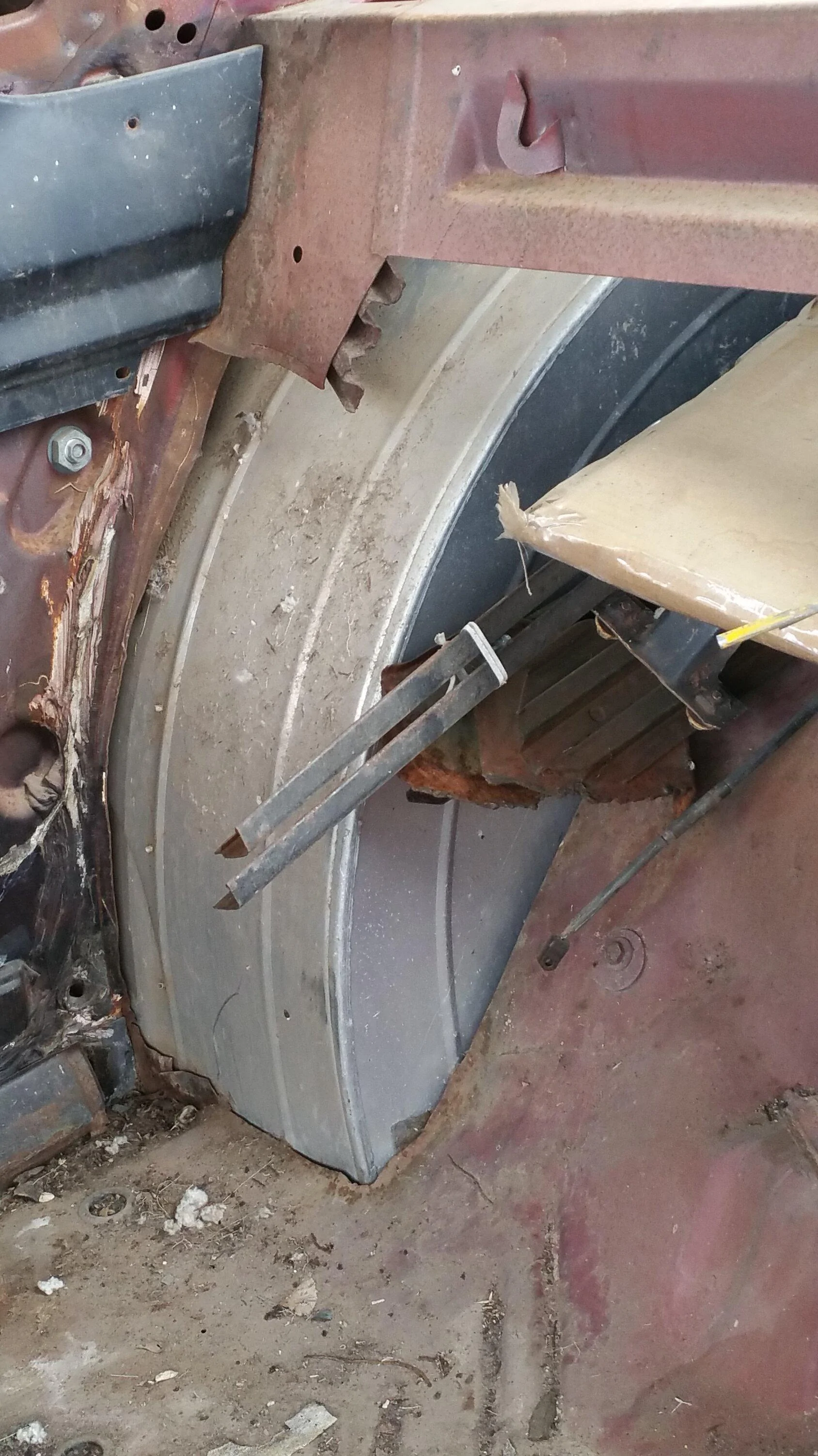

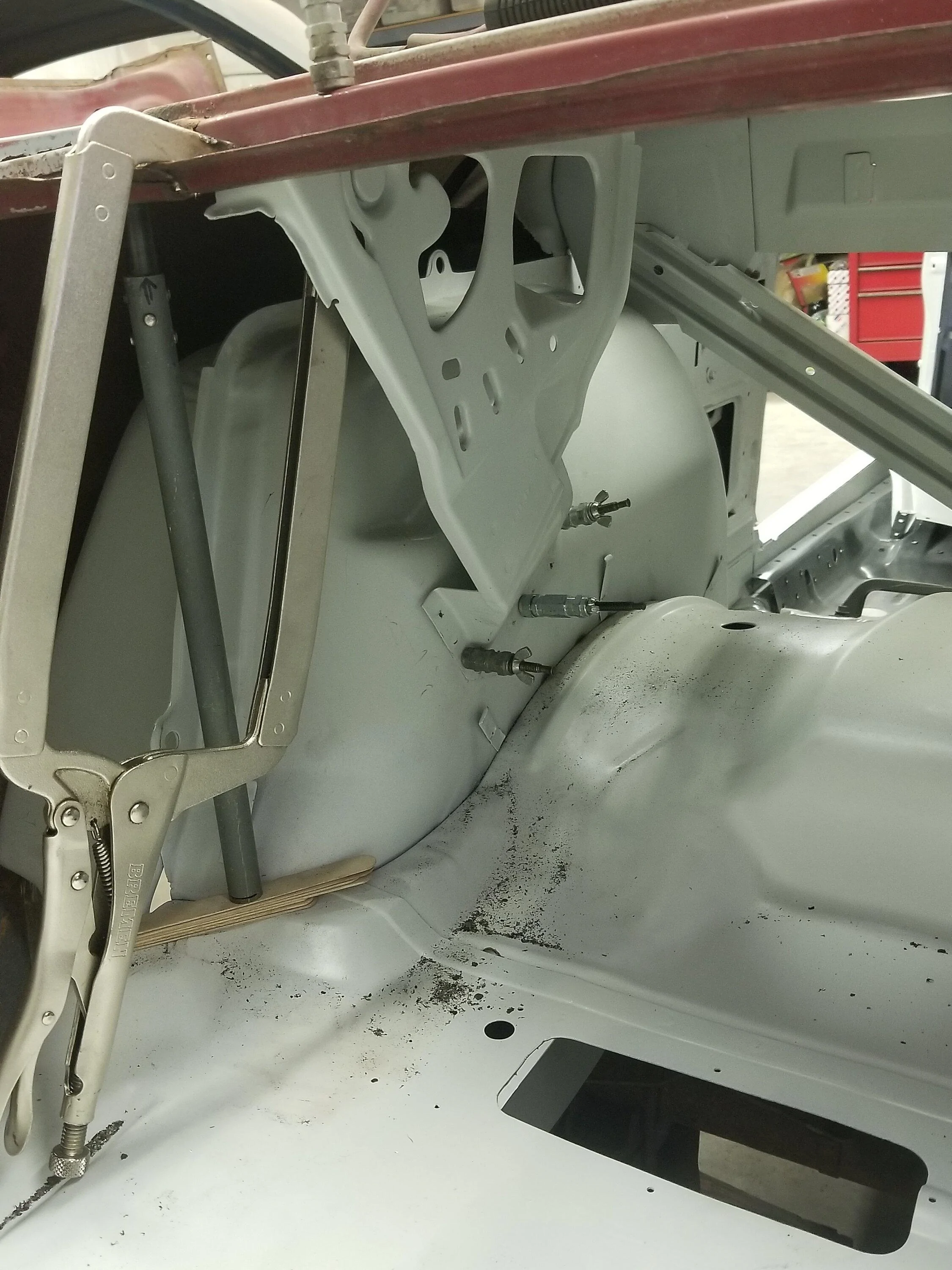

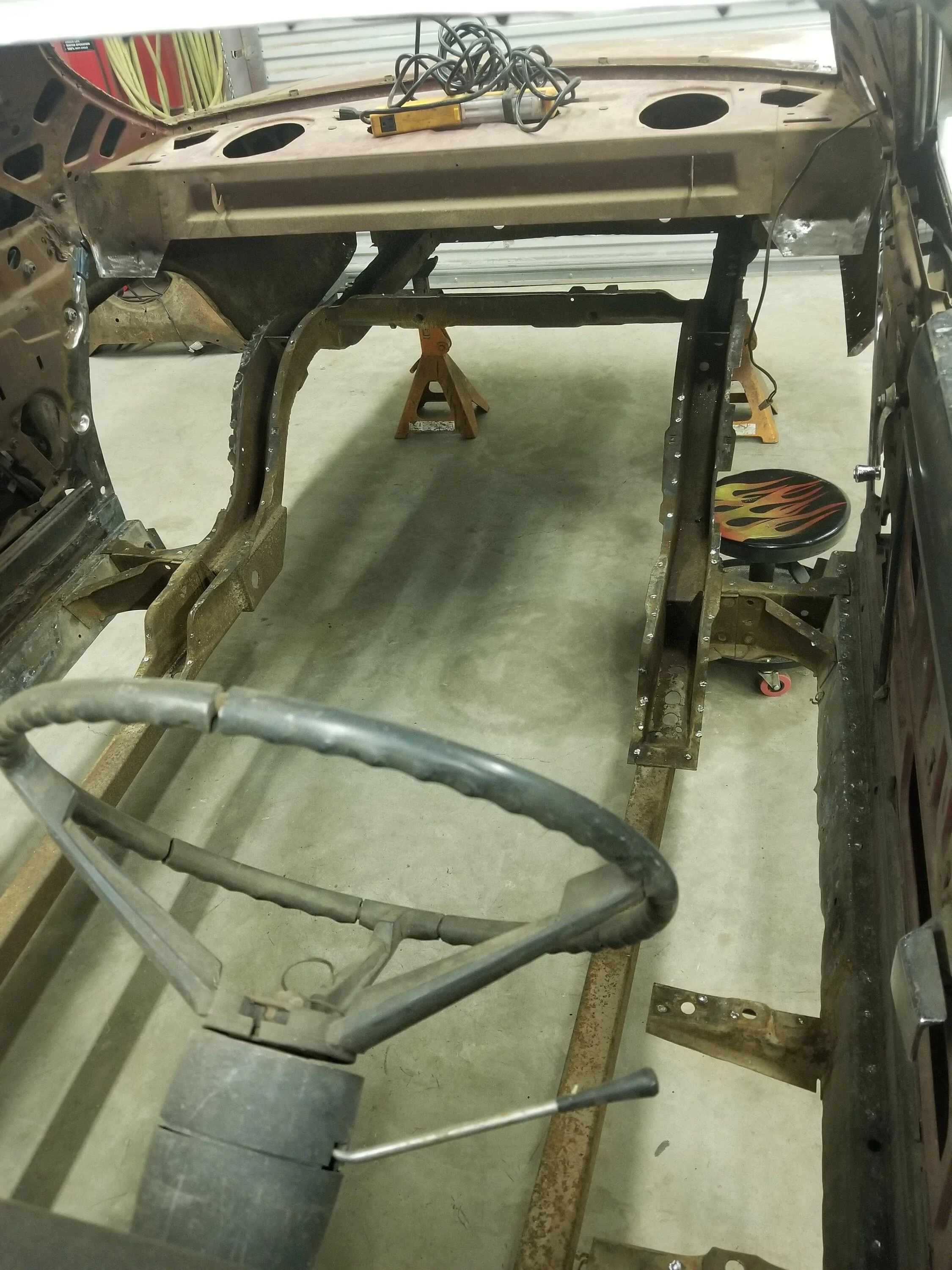

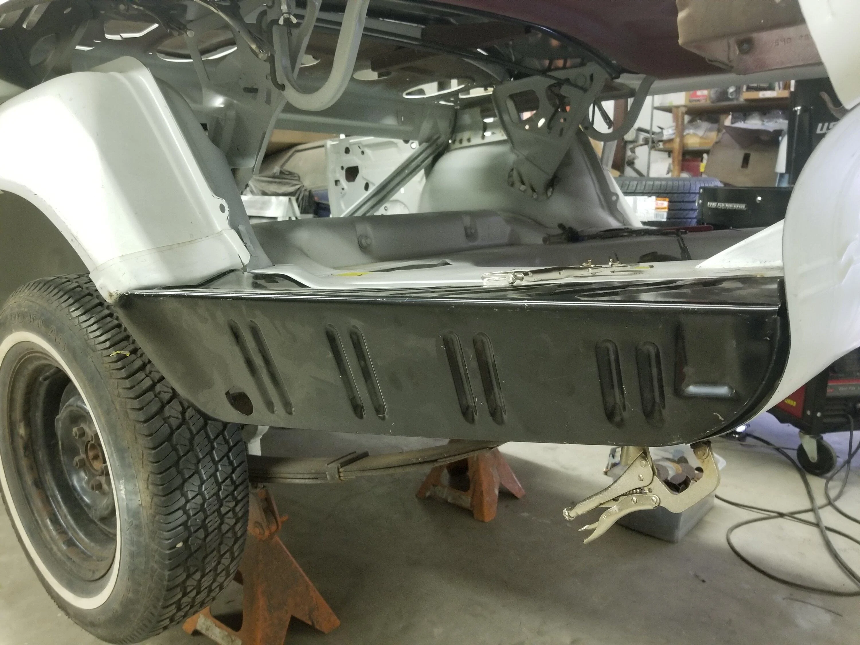

And how much room do you think your really gonna get cutting away the wheel houses. Maybe 2 inches on either side? A whole 4 inches for all your effort. I mean there is still tires, shocks, and suspension under there. It's not empty space.
Could I do this type of mod? Yup I sure could. Am I gonna? Nope. The gains are minimal. This is just a 4 door car with a large trunk to me is all it is. See pix below. This is me reversing a rusted floor, and horribly hacked in pop rivets and silicone aluminum minitub job on a 69 barracuda. Pix show that I am capable of doing this sort of stuff. The difference in the pix, is I am putting the car back to original, and restoring the structural integrity that was designed into it by the OEM.

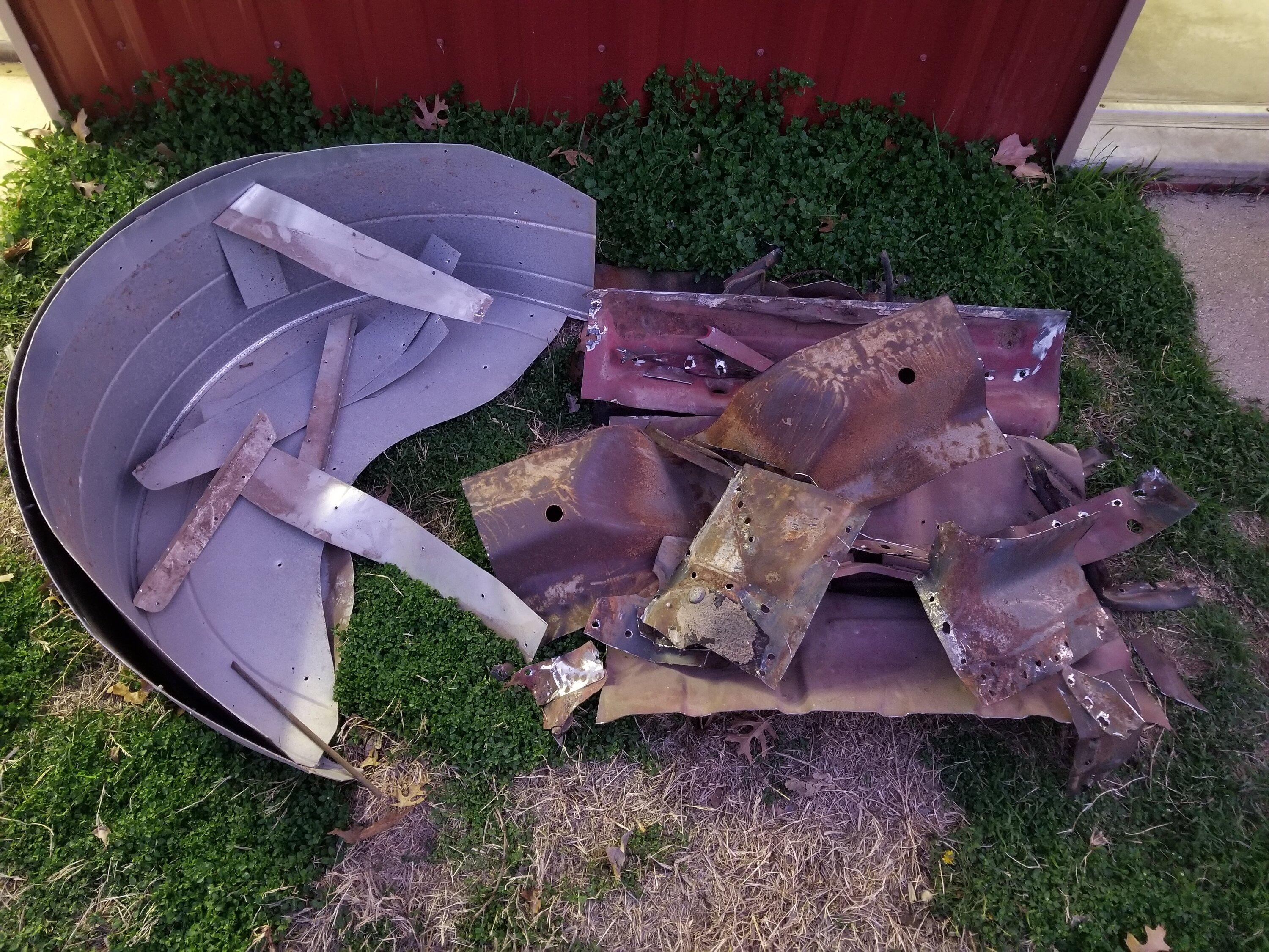

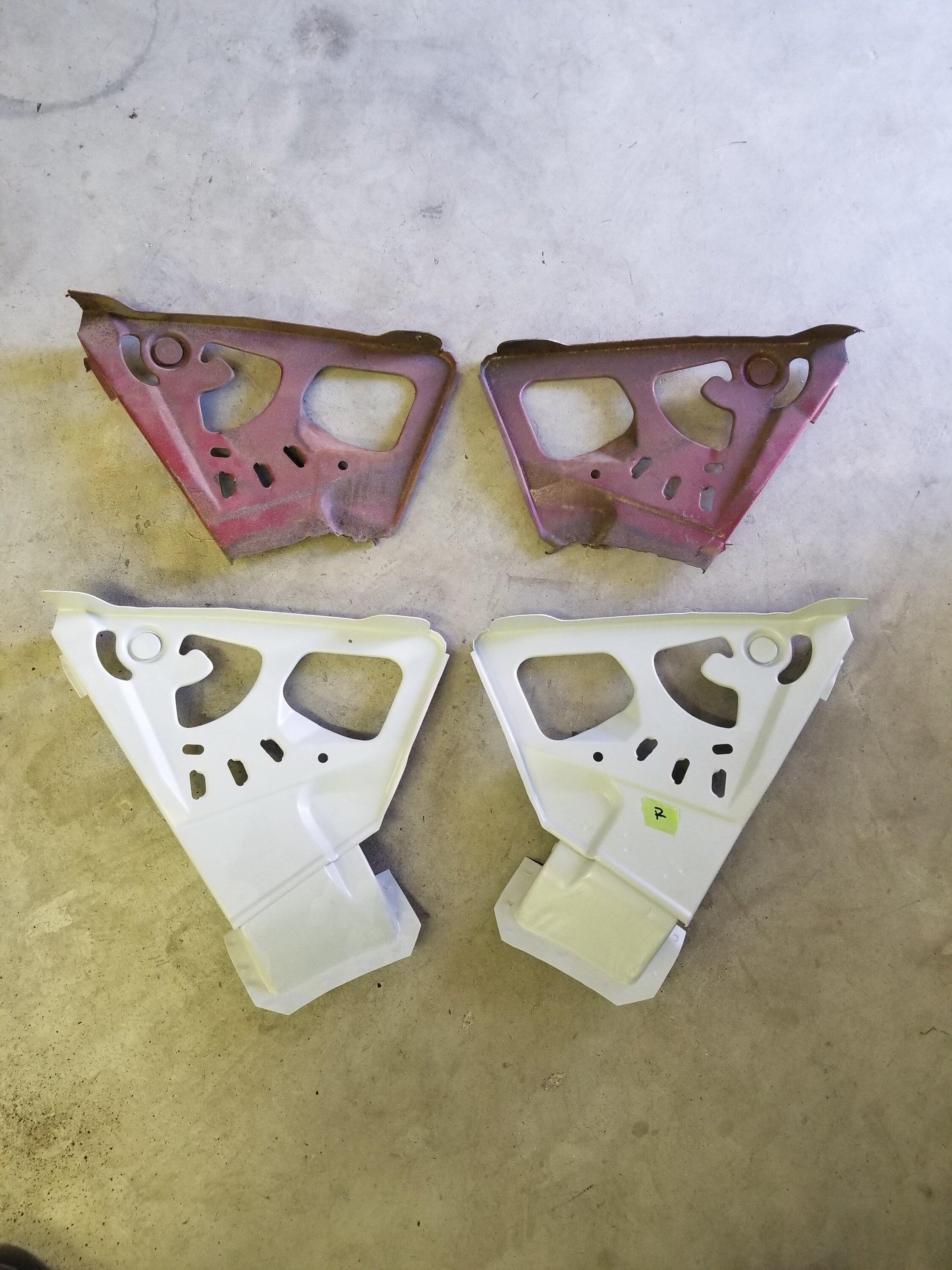

Here is the butchery that had to come out. They even cut the bottom off the trunk hinge supports making them useless. Thank God for donor cars.
