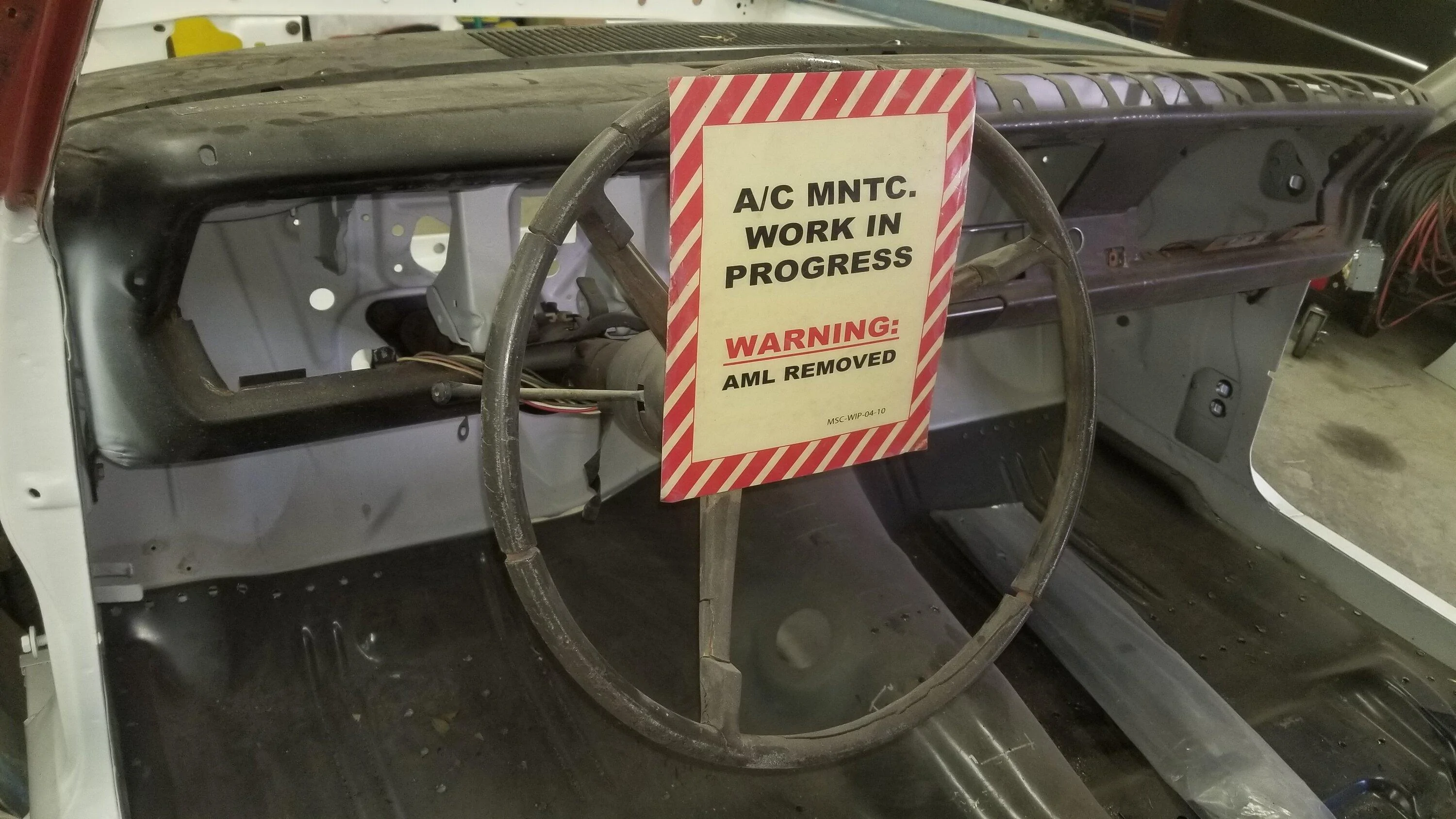

Off work and on vacation through january 8th. I have some more stuff to do on the silver buffalo, and then I will be back in the shop and welding the main floor pan in on my project car. To say I have been busy with other things home, kid, and spouse related is an understatement. The cuda will have its floor pan, and other sheetmetal projects welded up before I get back to work on january 9th.

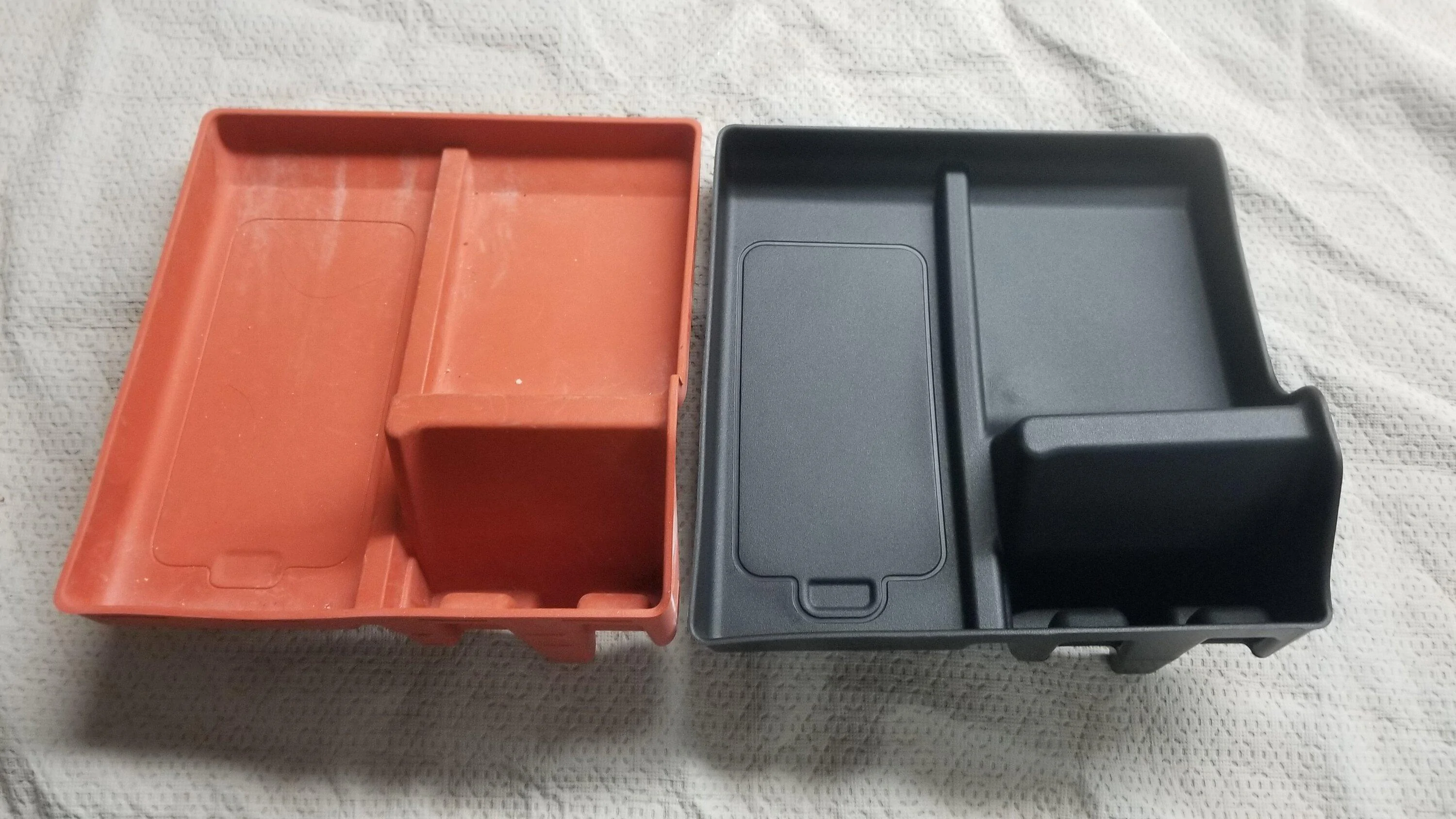

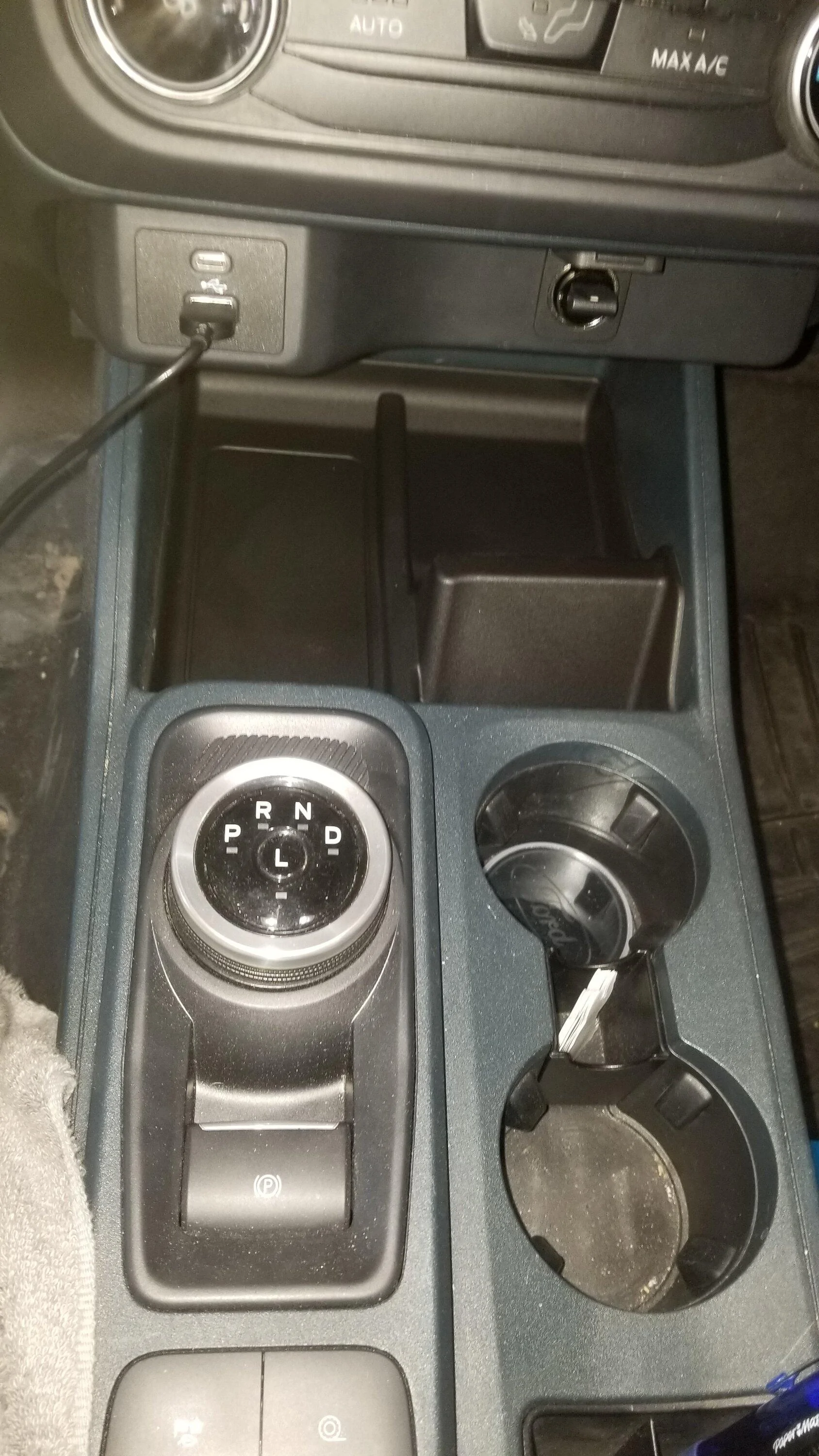

I thought I could grow to love the orange accents in my XLT, but just cannot. I will keep the safety orange on the door pulls as it reminds me of aviation MTX of which I work in. The orange accented stitching is not bad either. The orange center console tray however has to go. It's just too much. I checked my ford dealer and the black one for the XL was listed for $98 !! I almost choked. Well recently ebay and amazon have a copy in black that looks almost identical and fits perfectly. It cost me $39 shipped. I love this much better than the orange. And at half the price of OEM.

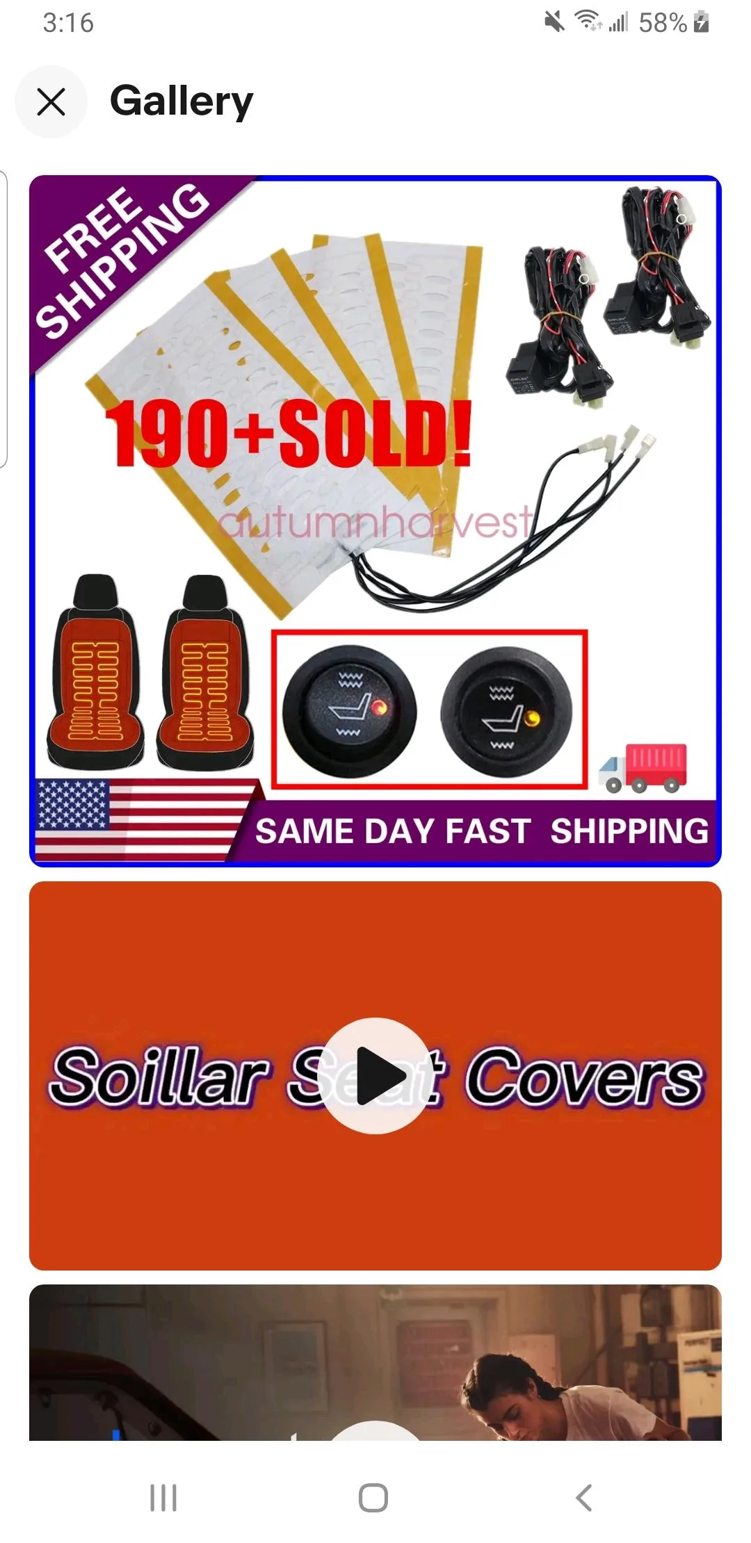

Anyone do heated seats? Looking to put these in when I get the truck.
Seat Cushion Heated seat Kit High/Low Switch Settings Faster Warm Up (2 seat) https://a.co/d/0J8pp7t
One of the things I am planning on eventually doing to my XLT. Perfect spot for the switches is on either side of the cigar lighter aux power plug above the center console forward storage area. I will likely look for a set that uses round switches and 2 seperate controller boxes. One for each seat. This minimizes the wire run to the dash for the switches and isolates the seat heaters into 2 seperate systems, left and right. I will run power in, and mount everything to the bottom of each seat on mounting plates. Relays, fuses, controllers etc. Theres enough room to do that.
Note in pic, 2 seperate wire harnesses and controllers. One for each seat. This way, if one controller goes out, it only takes out one one seat heater not both. The switches appear to be 3 position, and have an LED light that probably lights dimly on low, and brightly on high. So off, low, high.

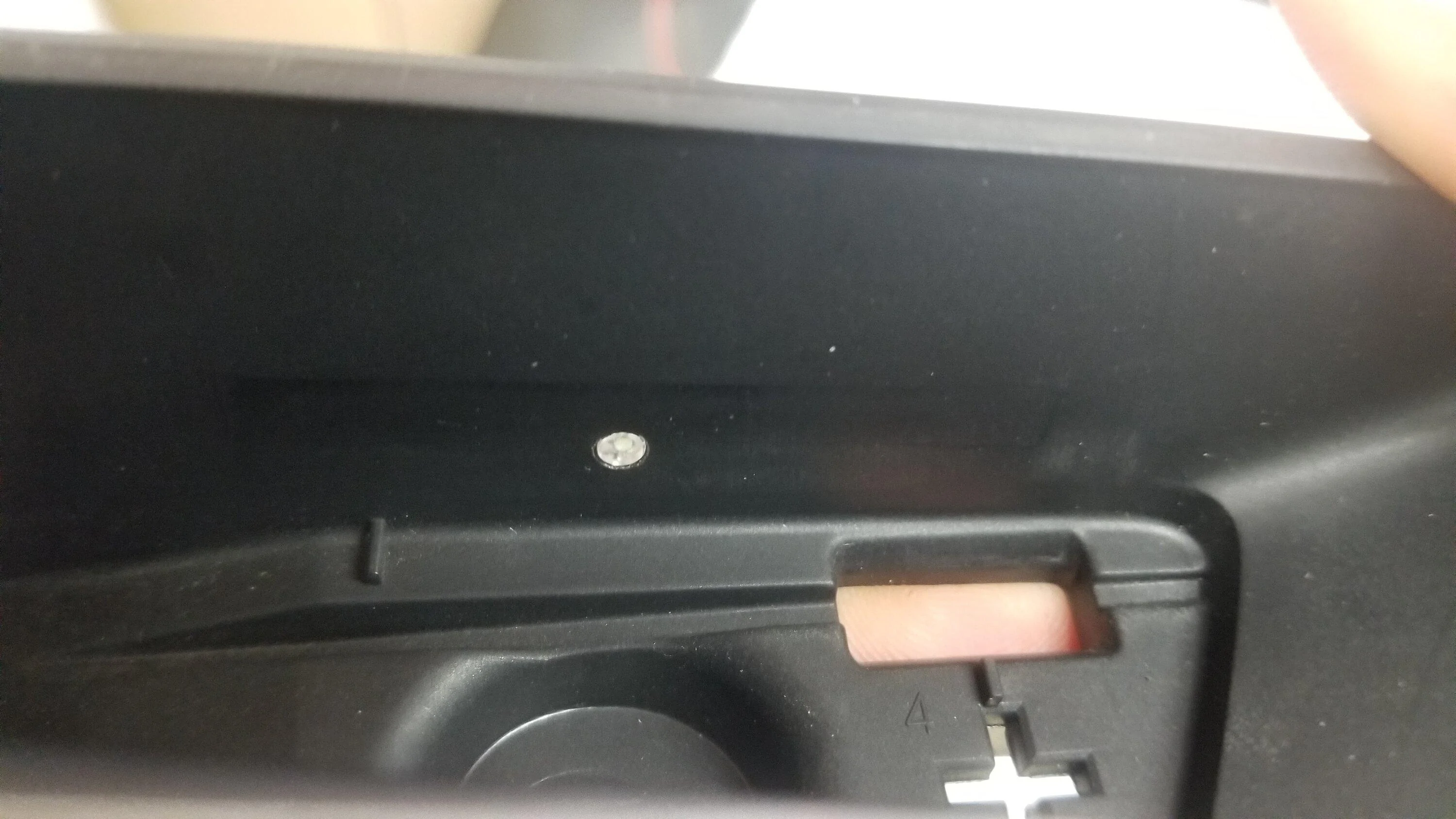

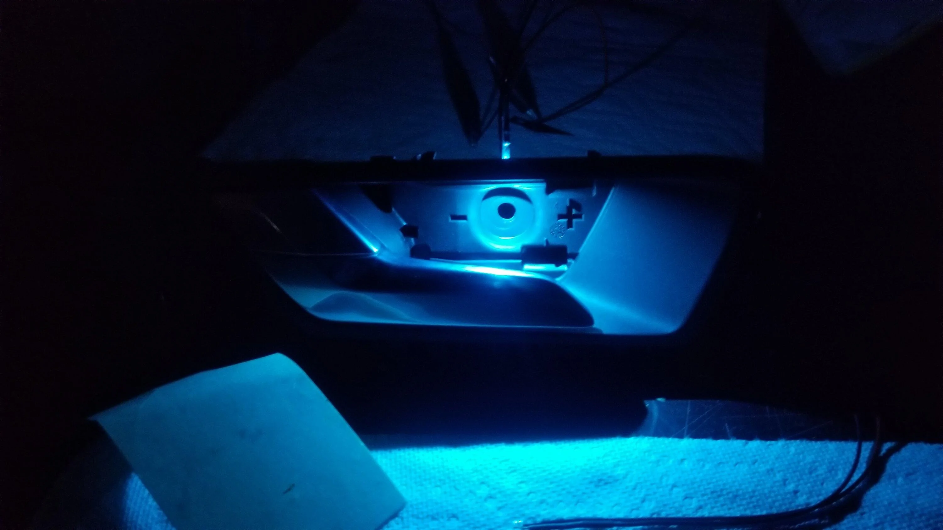

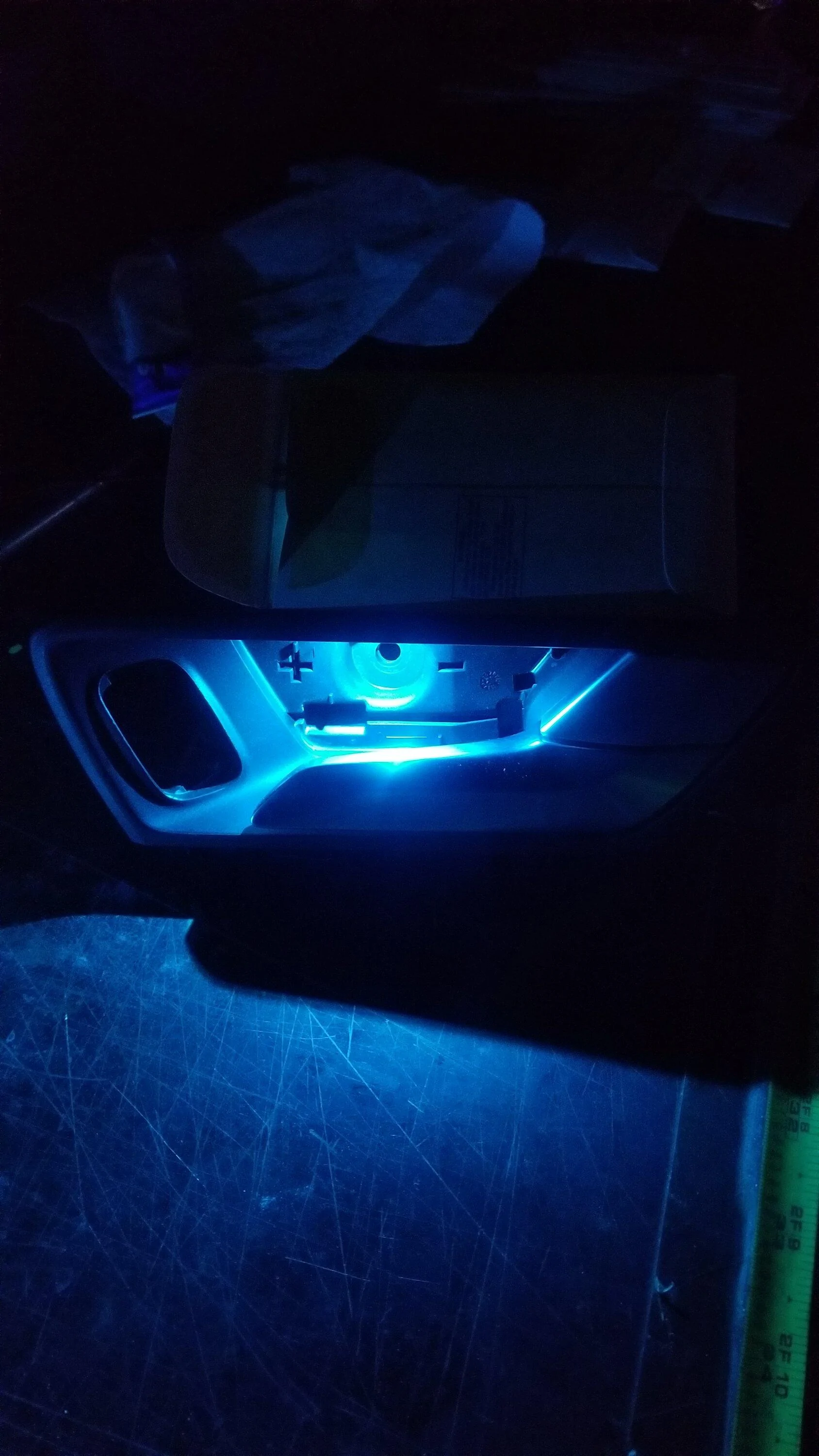

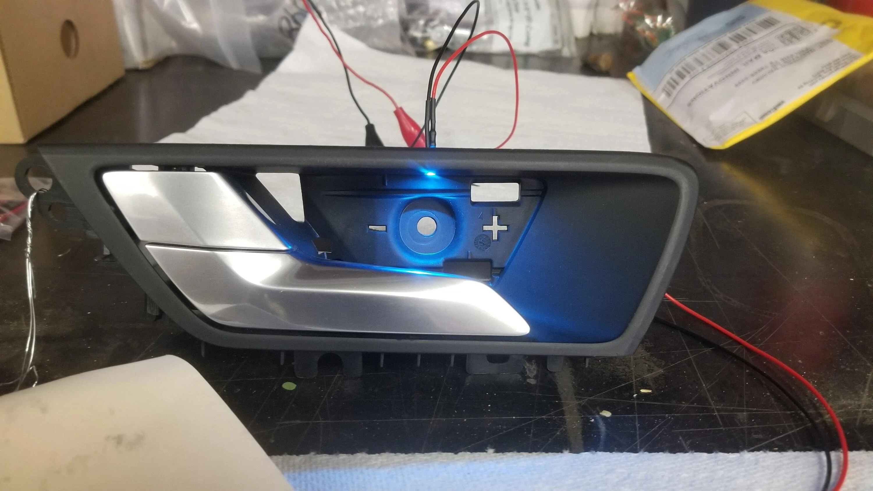

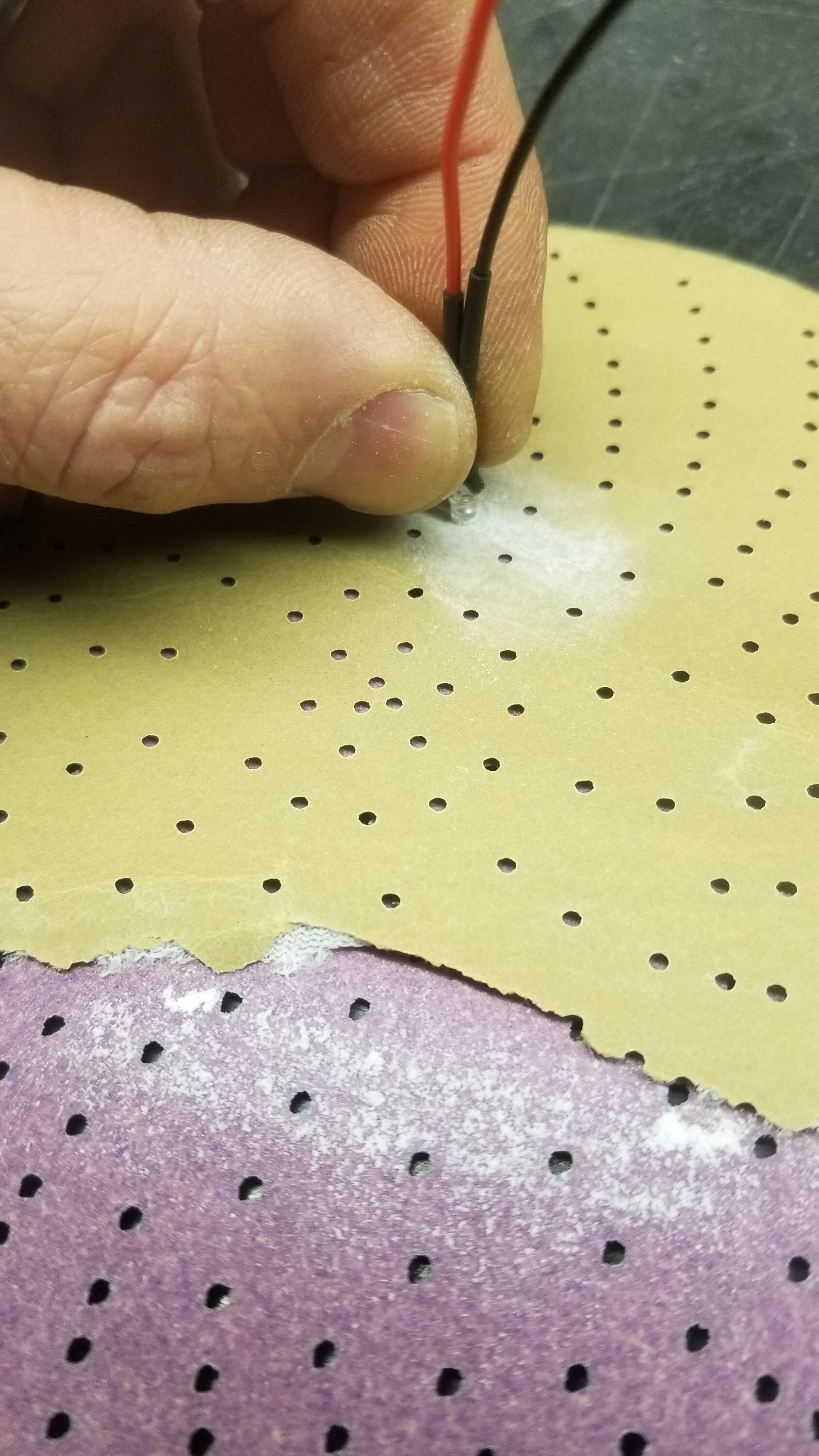

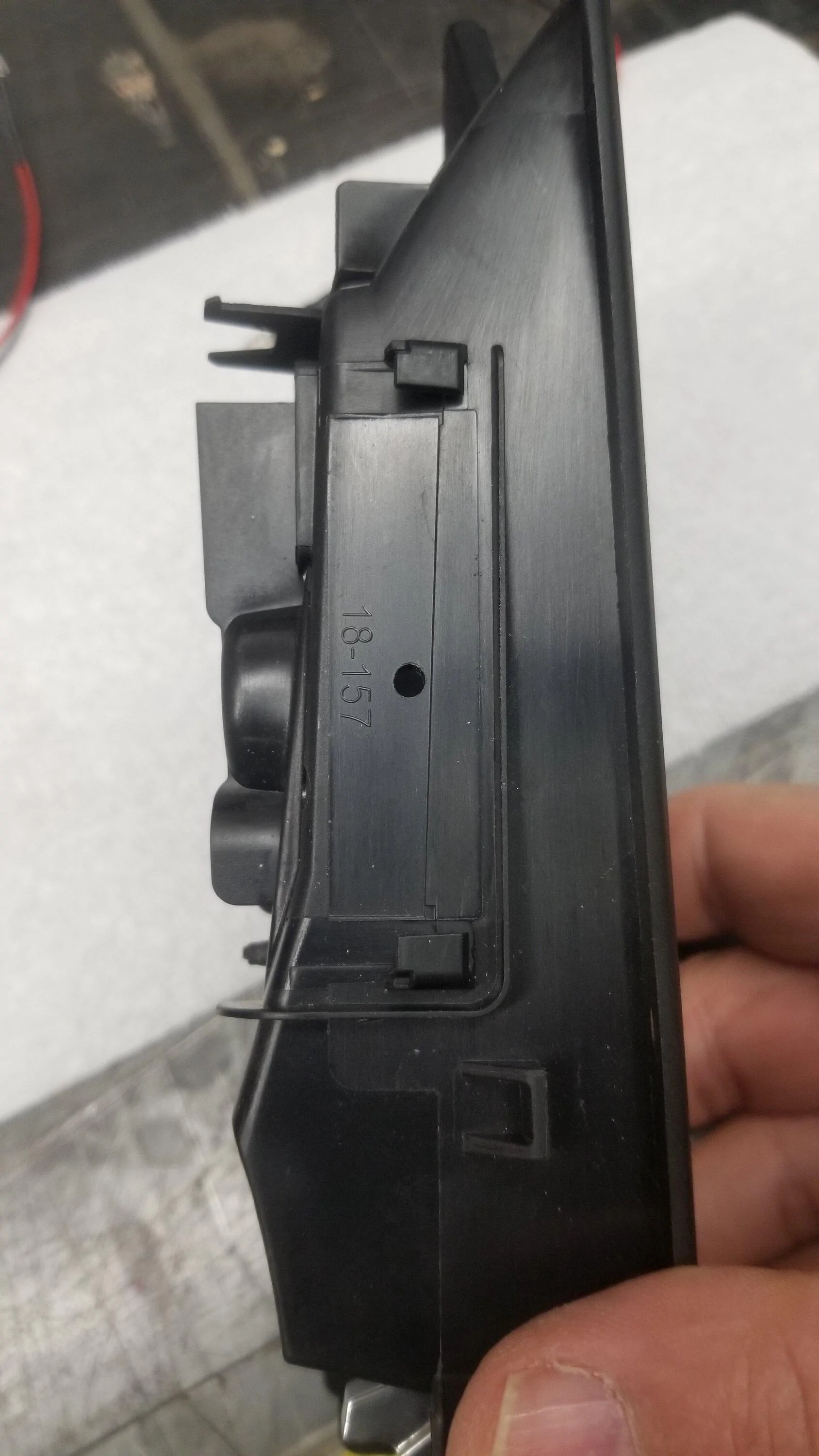

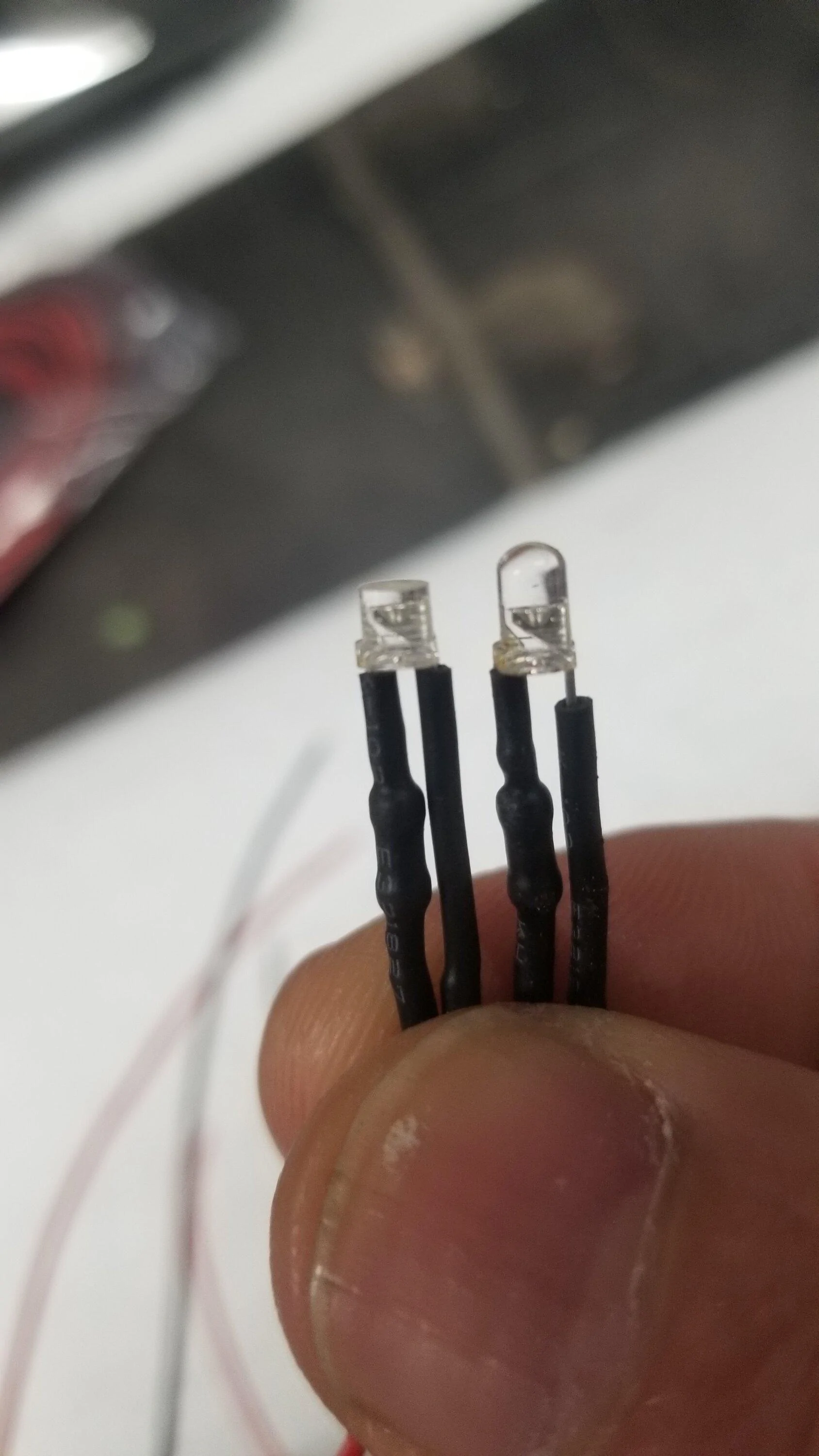

So the lariat has ice blue lighting on its front interior door pulls. I finally found ICE blue 12V LEDs I wanted to use. I bought 3mm and 5mm. Was not sure which would work best. I bought escape platinum door pulls because of the nice brushed silver. I used a #30 drill and centered and drilled a hole in each pull. If you notice theres moulded in clips on the door pull housings for the backlighting, but the rectangle for the bezel is not cut out on these.
Anyhow, being as i could not get these LEDs as flat top flush mount, I did as i have done in the past, and filed the tops flat with 150 grit sandpaper, then 320 grit, then superglue them in flush with the inner side of the door pull housing. You want them this way, because theres an access cover that has to be removed to get to the bolt that holds the handle that has to clear the light, plus it softens the glow a little bit.
These LEDs are not dimmable , but that's fine. The camera pix make them appear brighter than they are. I plan to tie them into the backlighting power on the power lock switches on the front, and to the power window switch back lighting on the rear doors.
I also plan to light up the front door panel storage pockets in ice blue as well. I will be changing out the front door speakers, and will mod each door for all this at one time. I dont want to pull the door panels off multiple times.
I am also thinking of backlighting the cubby in the dash next to the radio.

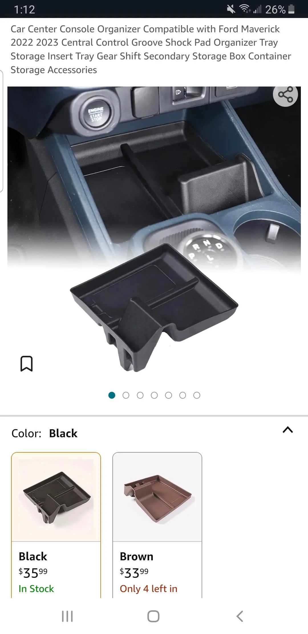

I searched on Amazon, but could not locate this accessory. Are you able to provide a link to the site you used?
Thank you in advance.
Not sure still how to link it, but heres a screenshot for the brand I bought. They have em in lariat brown too.
