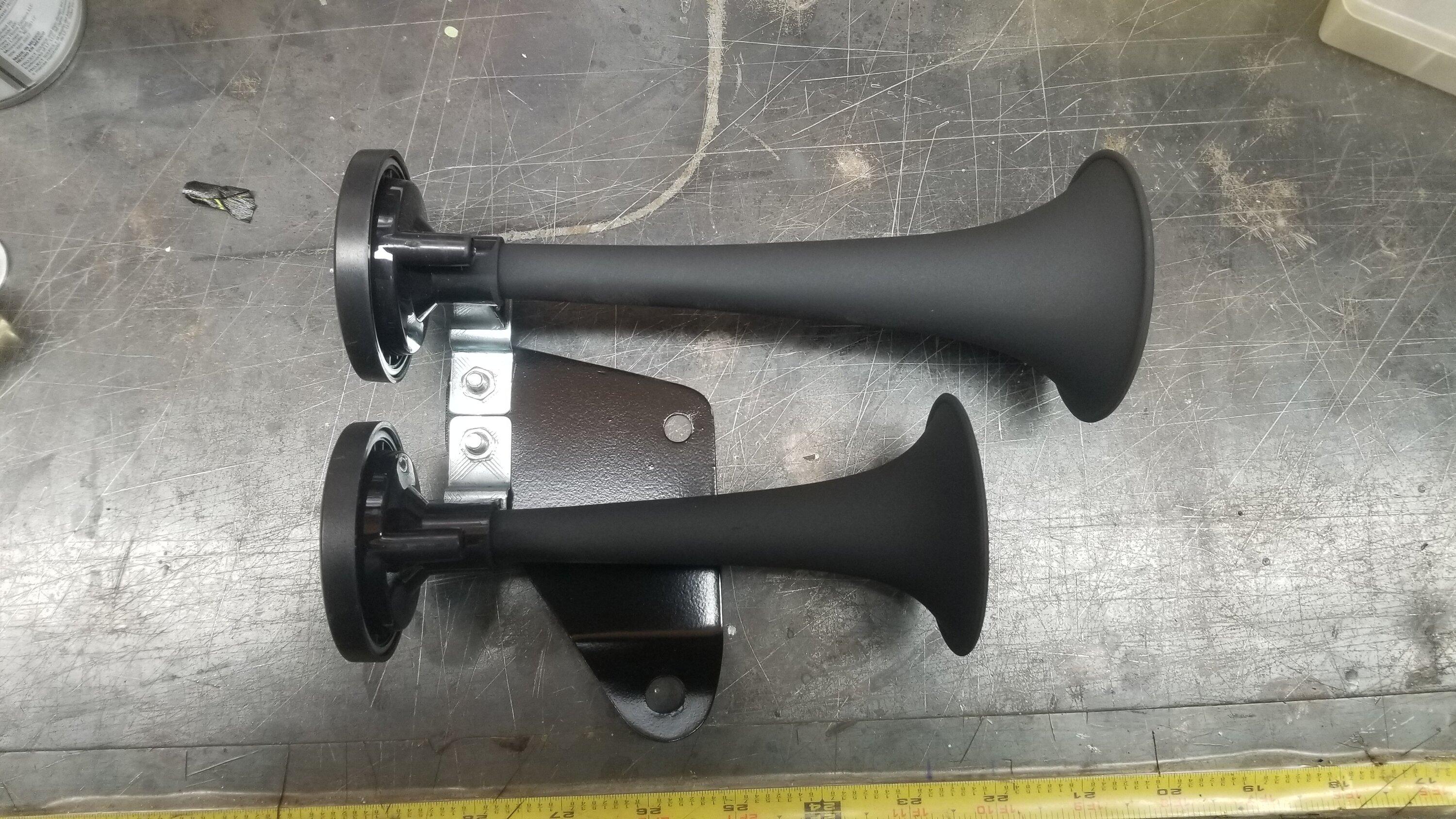

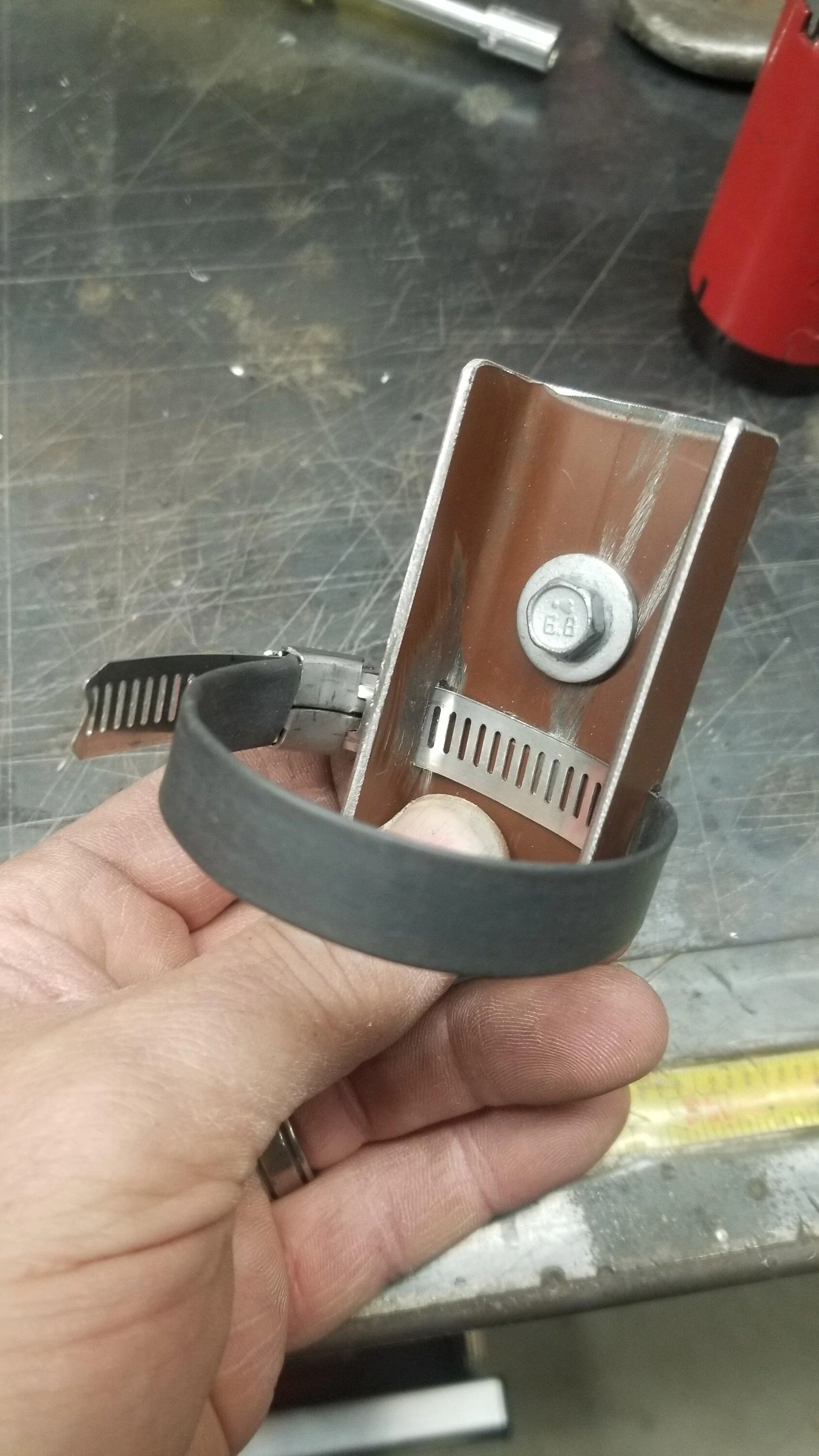

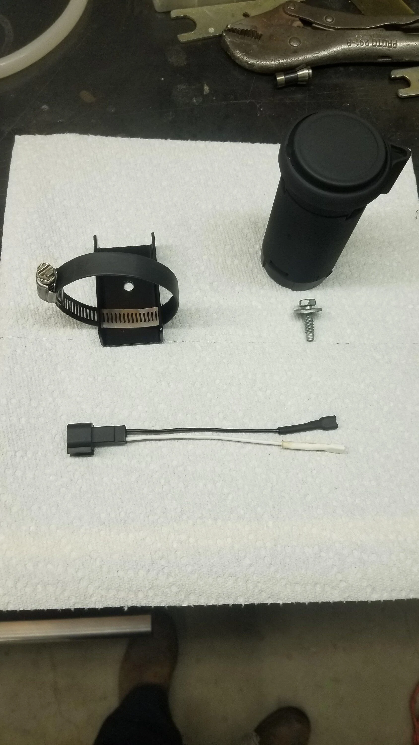

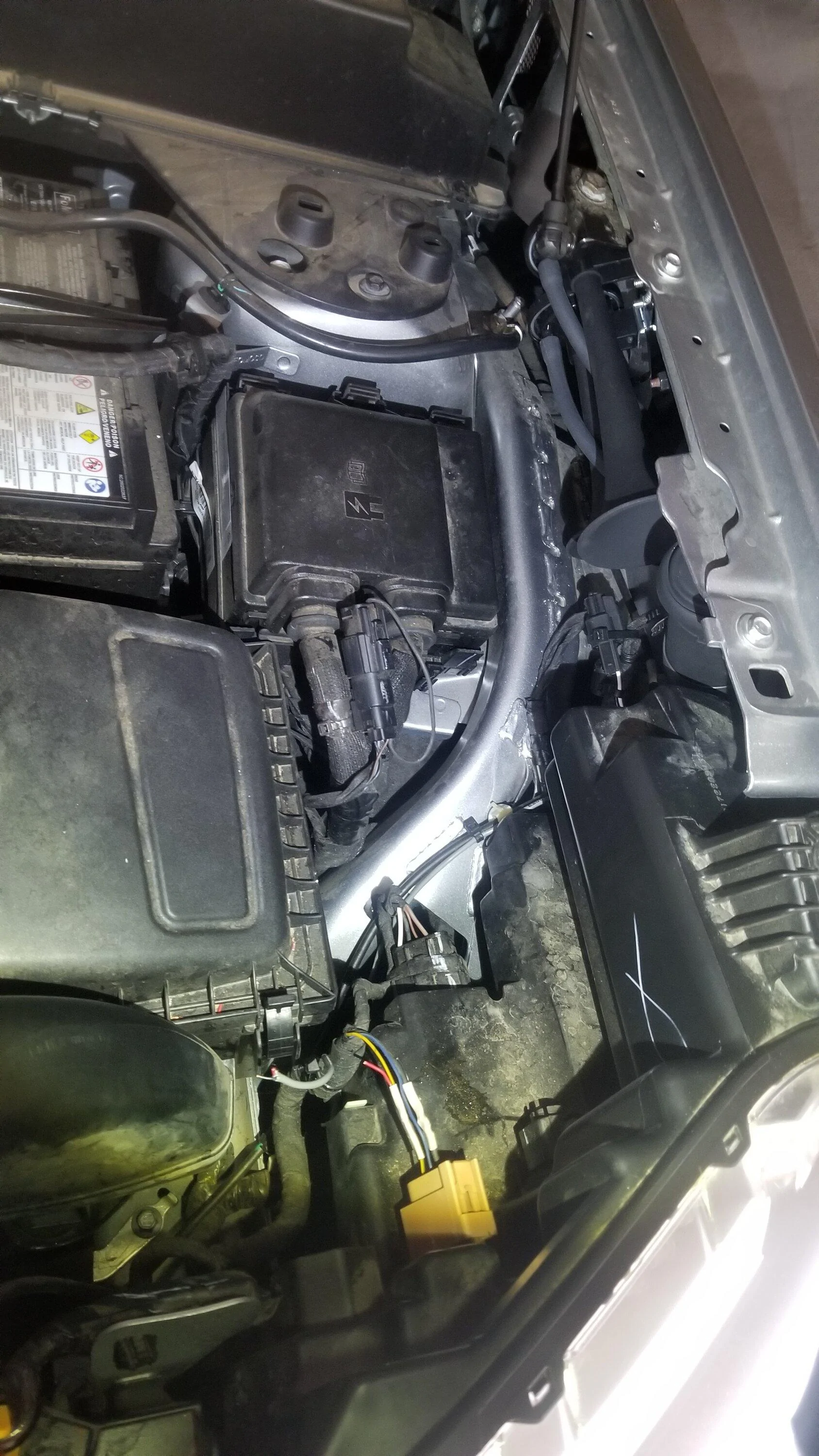

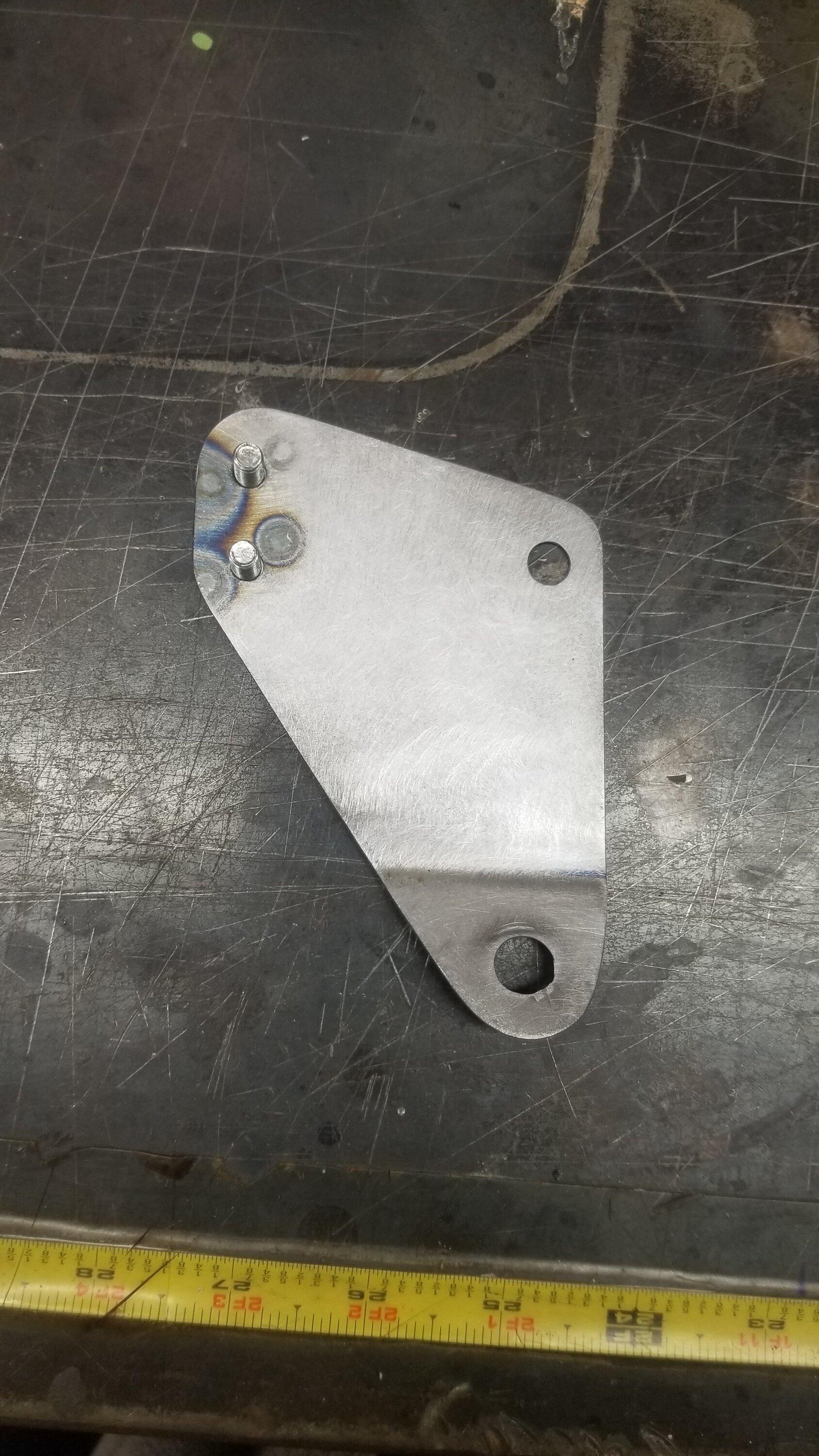

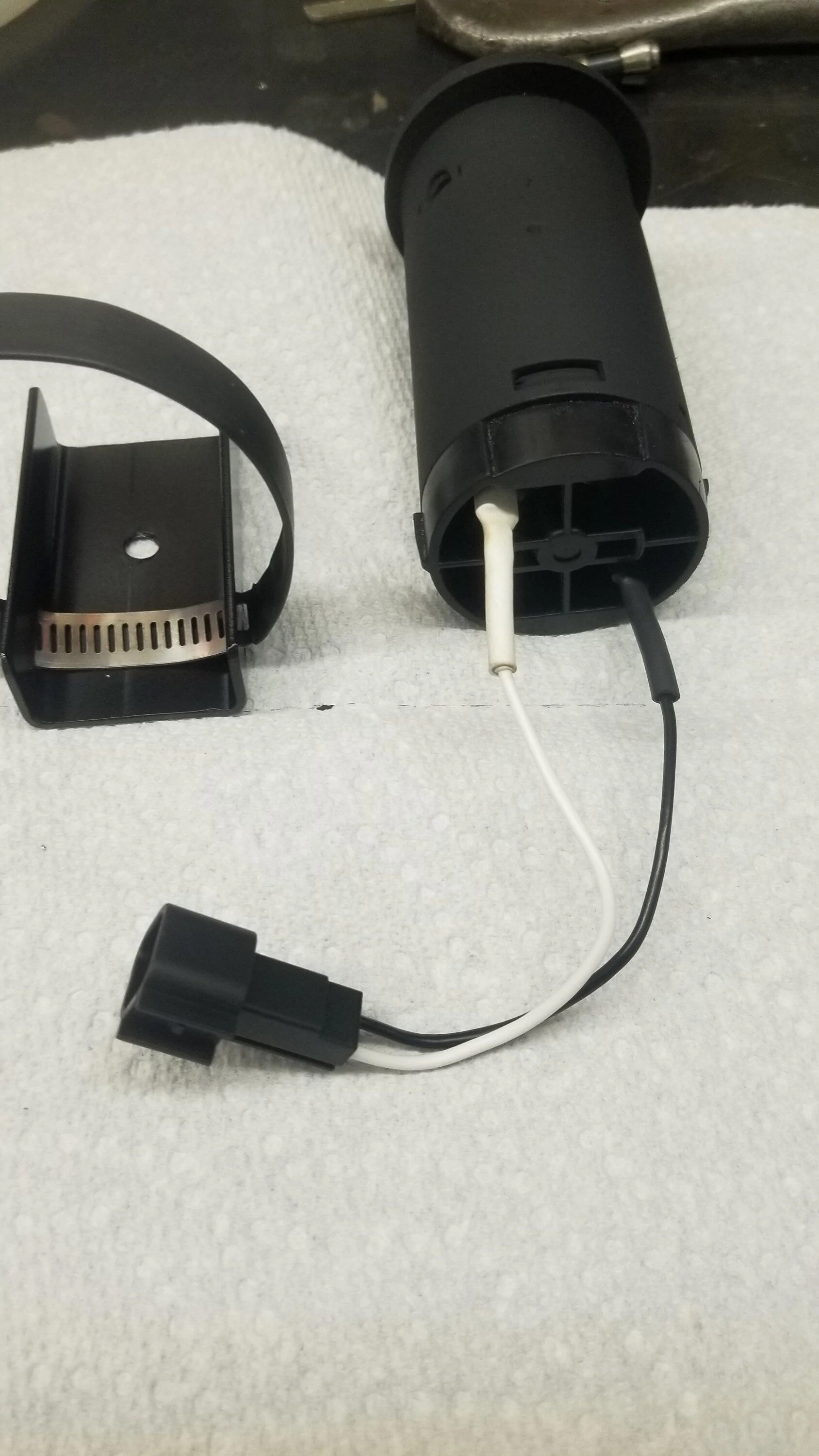

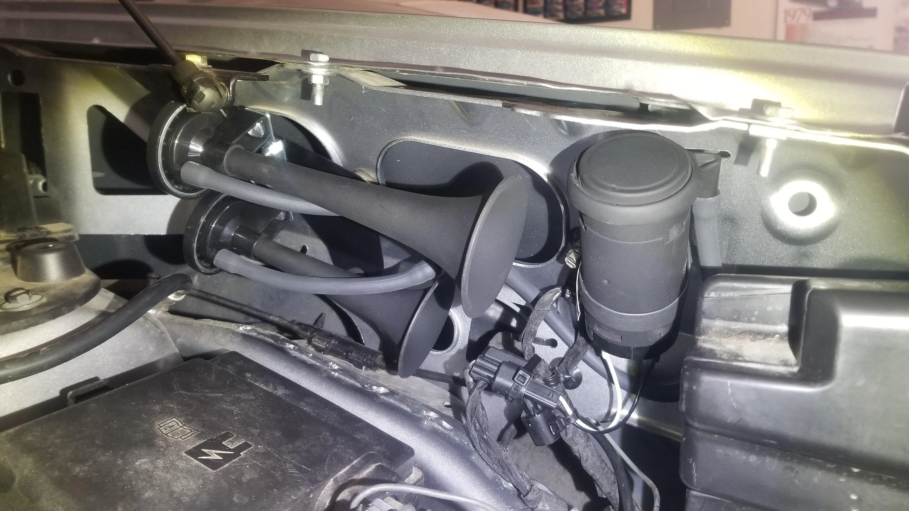

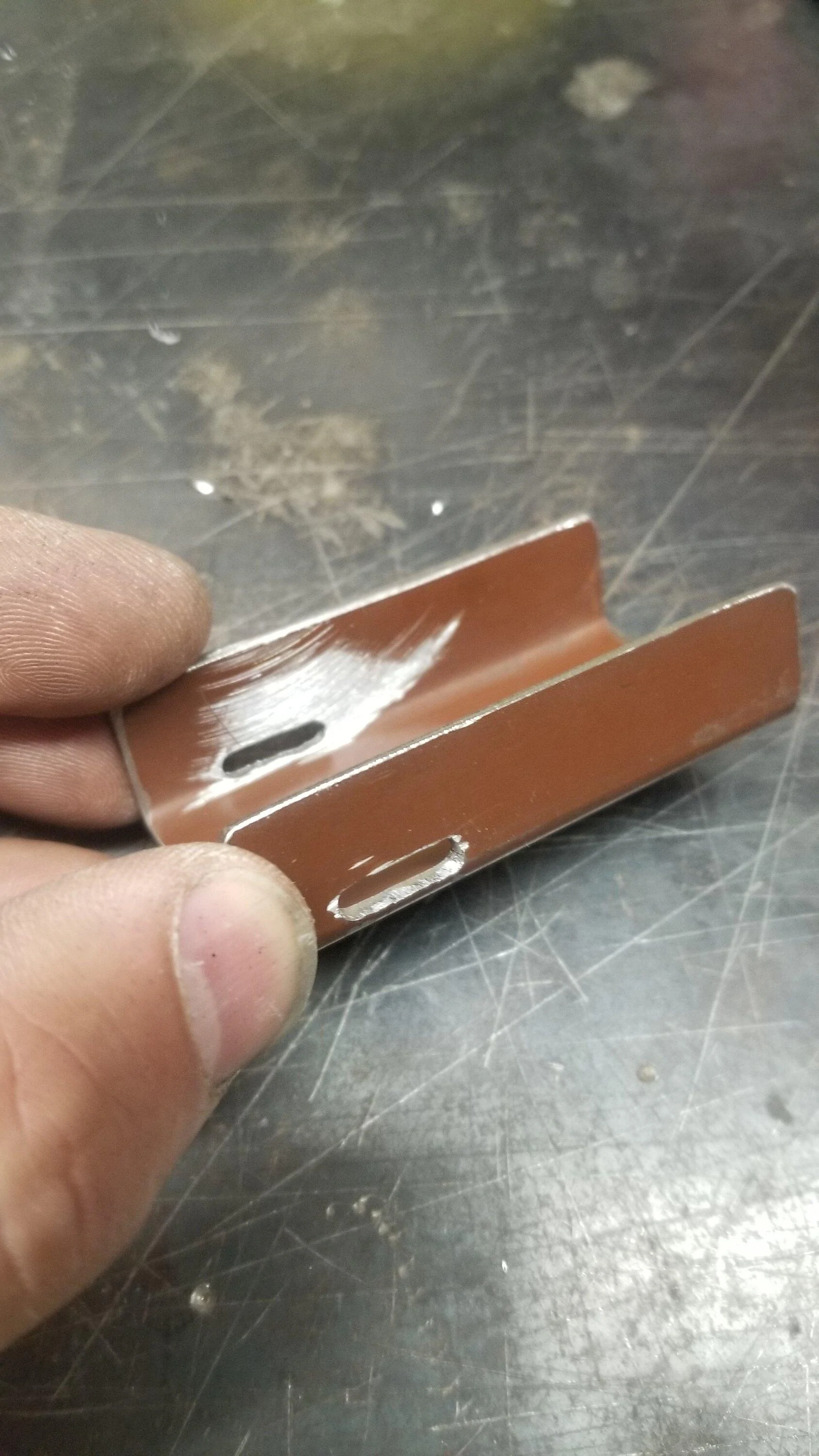

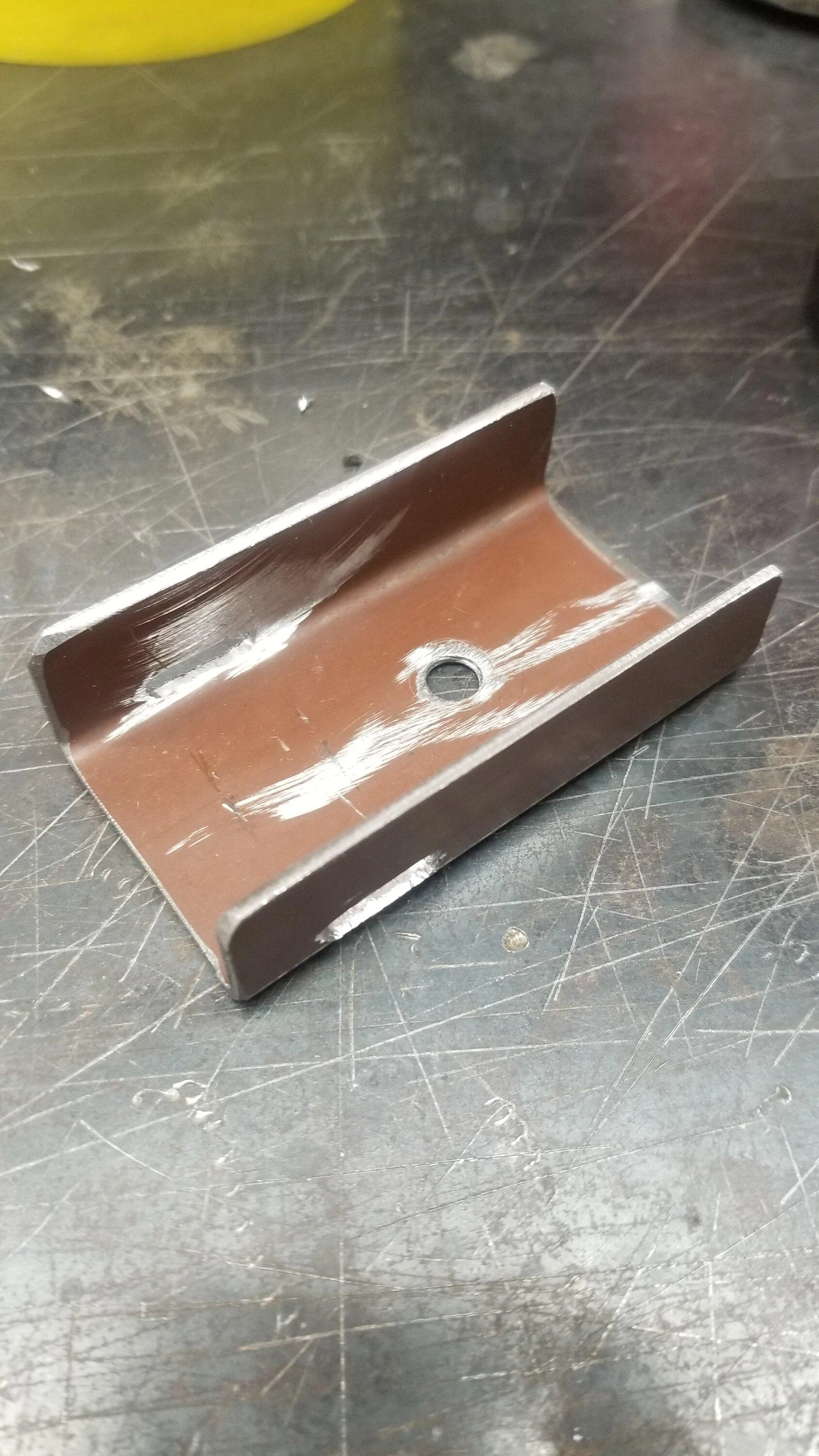

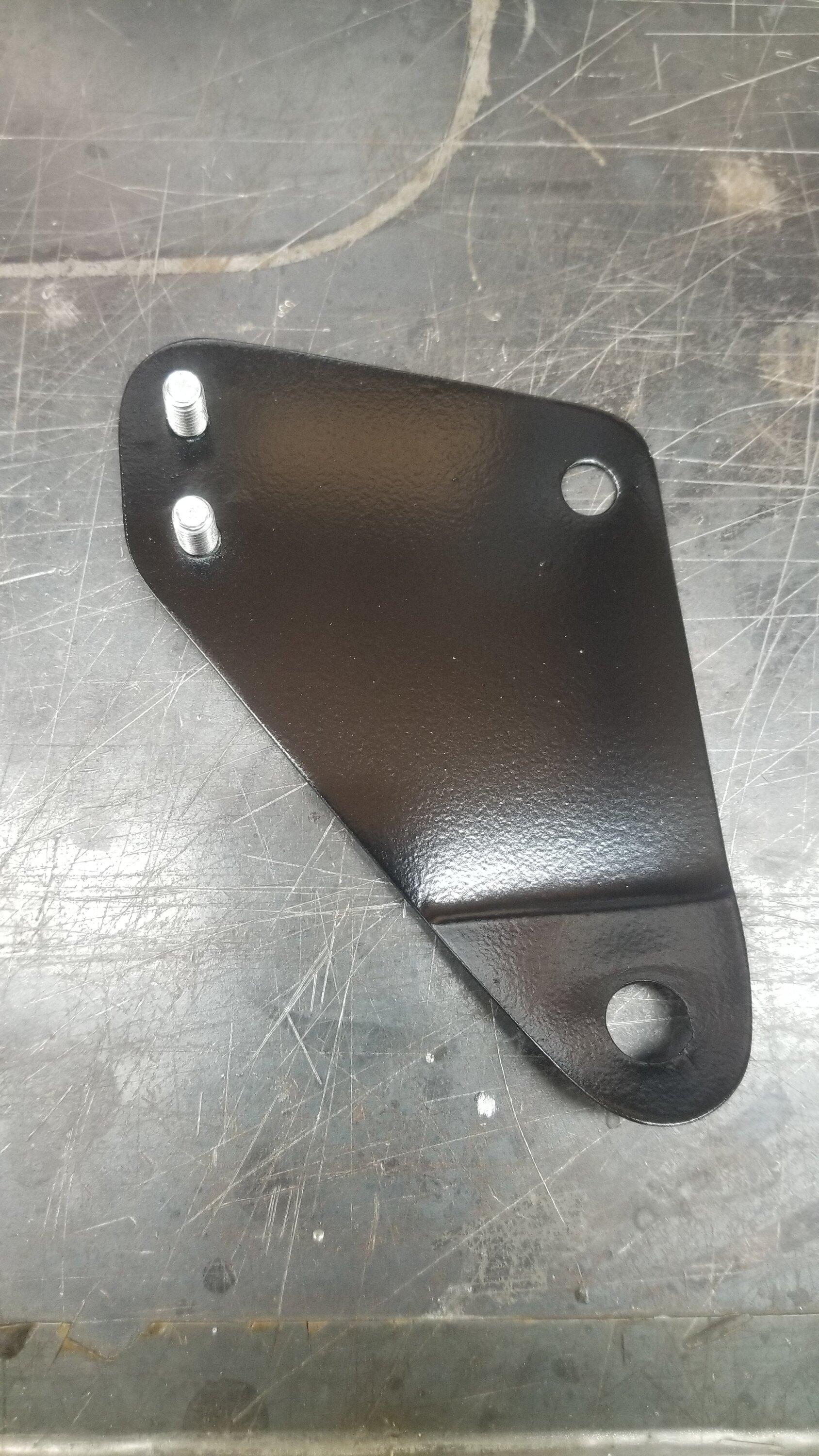

Finally worked everything up in my mind how I wanted it, made the mount brackets and installed my horns. I painted everything black. I used a Metra brand Ford type aftermarket 2 pin speaker adaptor plug, and plugged into only one horn connection. Just zip tied the other horn plug out of the way.
I also had to un pin and swap the wires in the Metra speaker plug to change the polarity so the compressor motor would blow air from its compressor exit port, not try to suck it in. This way black wire attaches to negative side of the motor.
These tuck up out of the way very nicely. I am very happy with my install. The bonus is they are very loud, and sound like the more expensive Italian made Fiamm Riviera series horns. Kind of "Ferrari esque". The best part, is I used all existing holes under the hood, and did not drill any additional holes. I hate drilling extra holes in a vehicle.
