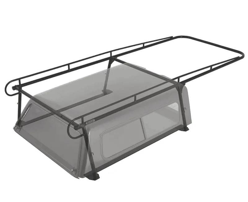

They will custom make whatever you want. They even have racks that have a flat that sits between camper shell and extends out far enough to support the rack outside and over the top of camper as well as over the cab of truck. I do not know if they have actually made on for maverick but the design is in their cad software and all they would have to do is enter the trucks measurements and the pieces could then be cut automatically. These would work even with tonneau covers.

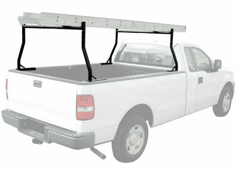

Harbor Freight also has this over-cab model: https://www.harborfreight.com/800-lb-capacity-full-size-truck-rack-98511.html
I would want to look at it in store and take some measurements to make sure it will fit on the Maverick's short bed, but assuming it fits, this could be a good option.

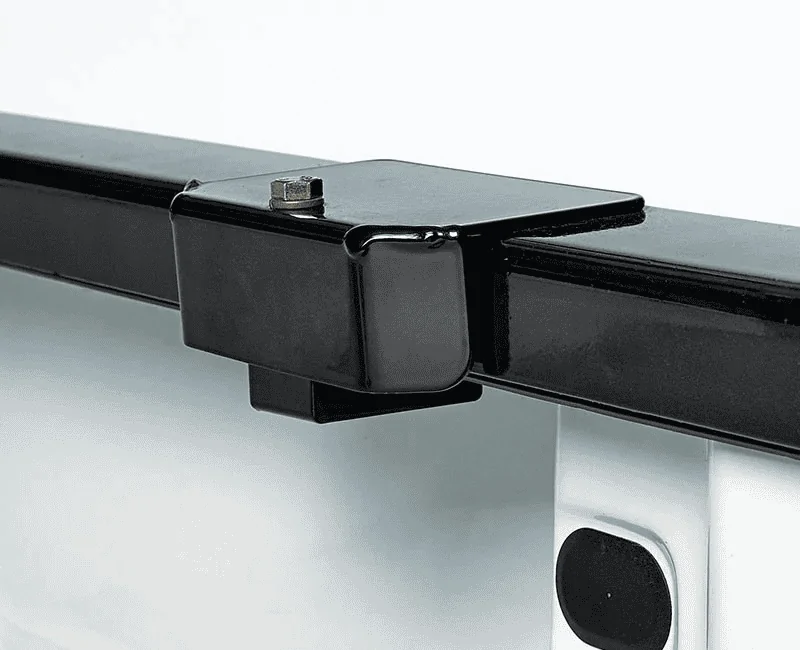

How are you going to mount a lumber rack?
There's no post/pole slots on the top of the bed sidewalls.
Drill??
Someone here got a bid from Rack it. They had just finished design and it was quite expensive at time. They have a bolt on bracket that clamps the bed rail so no drilling is required. They will also make a flat piece of steel that extends over the bed rail far enough to support the uprights so most bed covers will work. Uprights look a little goofy not sitting on bed. It is made to mount on bed for support and be user over a raised bed cover even a tent,!
This is clamp available at Rack-It:
