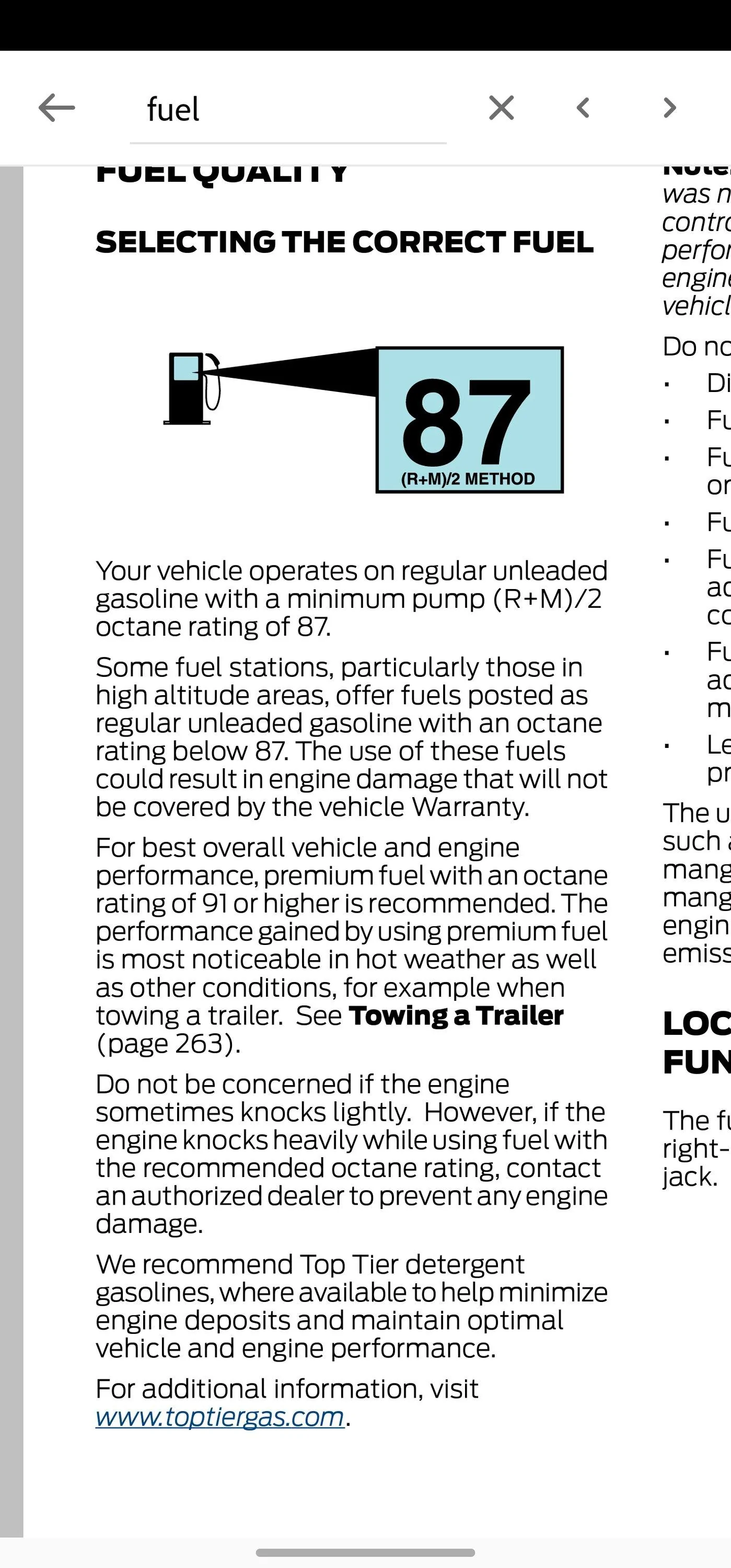

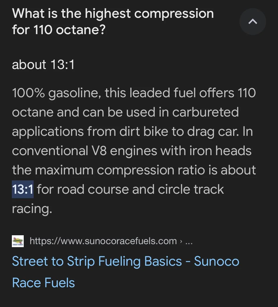

FYI 13:1 compression requires about 110 octane.
There's your hint right there something is different about the Hybrid engine.
Enjoy your truck, on any regular pump gas.

A little more corroboration:
So 87 0ctane works for a compression of about 8.7, if this is correct 91 is appropriate for the hybrid, no?
Well, two things:
1) we don't know the actual compression ratio
2) most octane charts I can find are from 1970's and 80's with carburetors and no electric controls.
Just like a 2.0 liter today outperforms a 6 liter engine from 1970, so do engines today on lower octane.
Octane is a rating based on the behavior of the fuel. But, as the years went along, the behavior of engines changed with more sophisticated controls.
Just like a gallon takes you farther today, lower octane works in a wider range of vehicles today.

Ford knows and they recommend 91. that is good enough for me. Others not so much. This is likely my very last vehicle, so I am going to use 91. It is another example of the "law of unequal consequences". If I am wrong I spent 10%+- too much on fuel; If the 87ers are wrong there may be engine issues. Since I can afford the extra cost of 91, I will use the higher octane. If one wants to use 87 because Ford says it is OK, that is their choice. I have said all I care to say on this issue. Have a great day and enjoy your Mav's.
