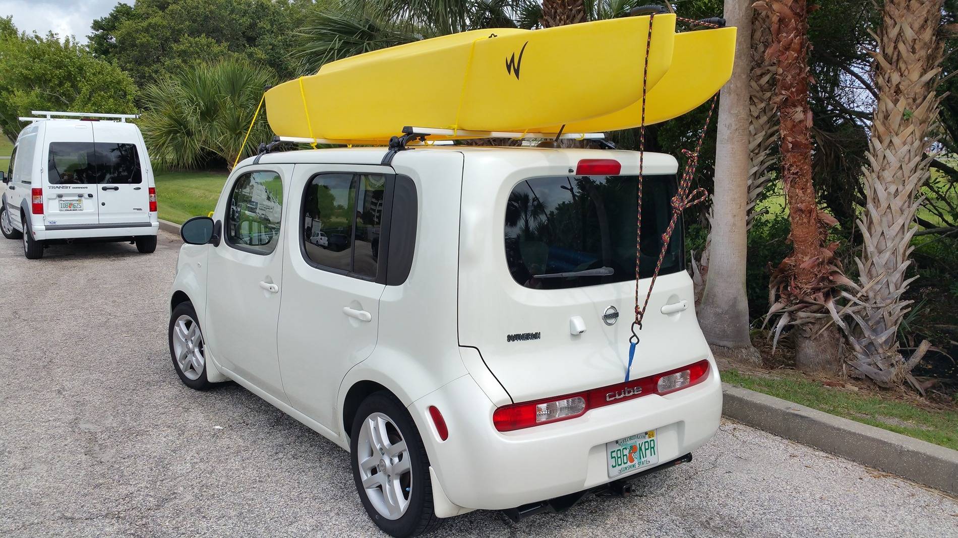

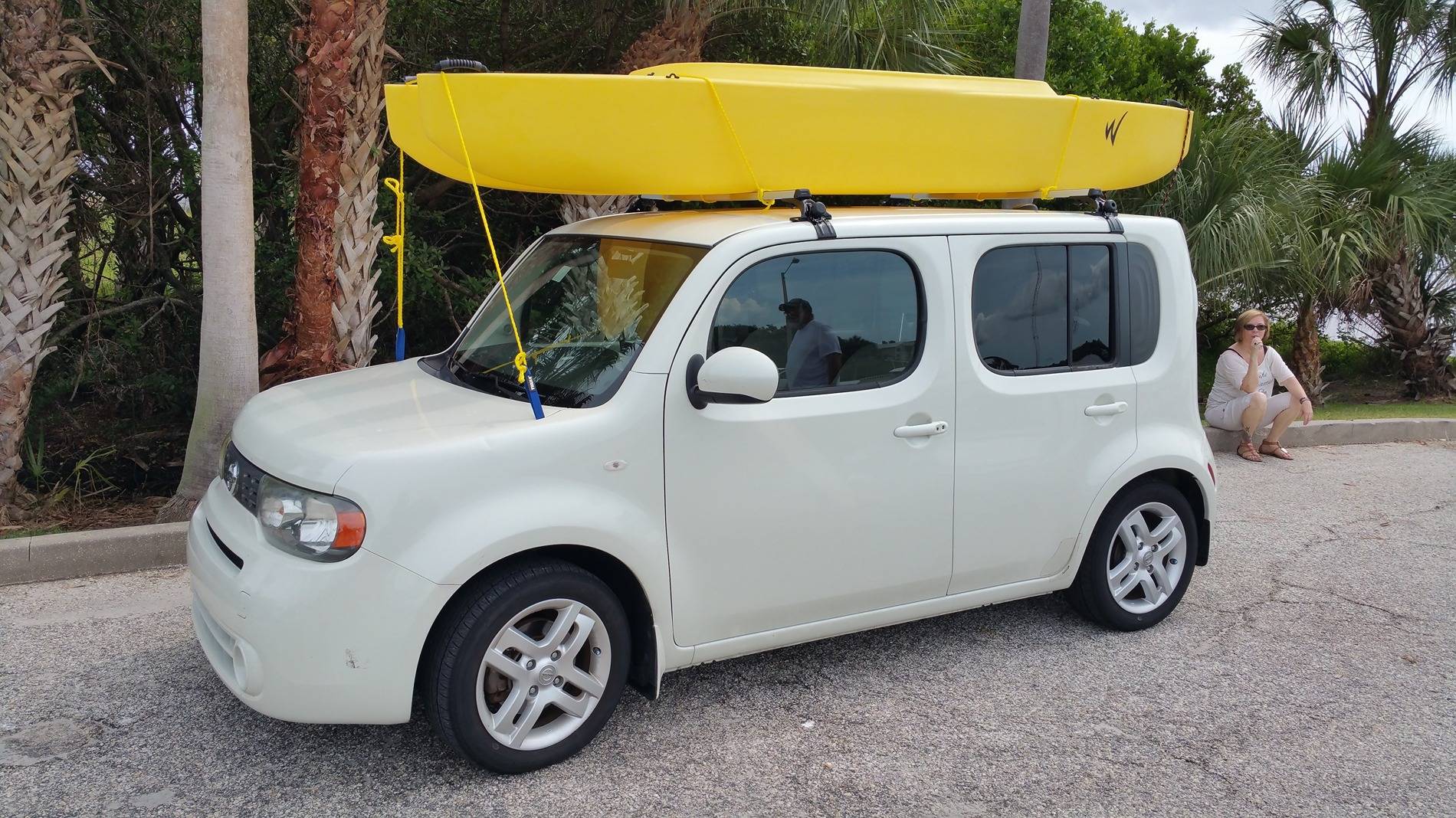

I use under-hood anchor straps on various vehicles. They bolt to the top fender mounting bolts of your choice and get “flipped out” between the gap of the hood and fenders when needed. I have used them for ladders, canoes, etc…. When not in use, they just get flipped back under the hood, out of the way. A great solution when you don’t have any vehicle tie-down points up front and/or don’t want straps running over a hood/grill/bumper.
Ford Maverick Looking to tie down ladder to front of vehicle IMG_7075
