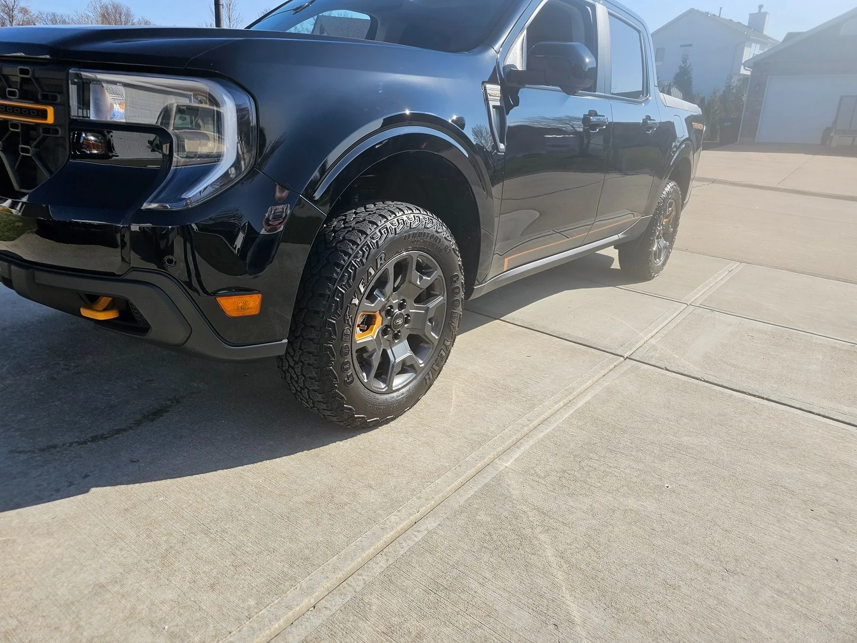

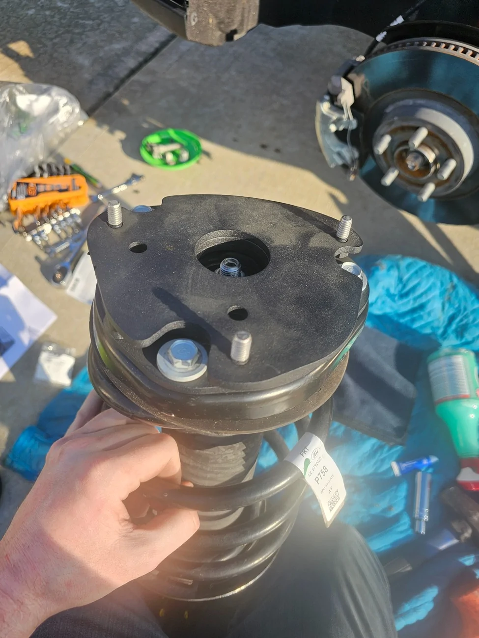

if your just wanting to level it . i would go with a spacer kit , like zone , rough county , hrg . easy install , cheaper no additional parts and gives a solid level ( just get and alinement afterward) vs taking apart the strut assy. and replacing all 4 springs and needing camber bolts ( still needs and alinement ) i went with a zone level kit on my own truck and it did exactly what i was looking for the install took a little over and hour with had tools ( wasn't rushing ) i was originally contemplating springs vs a spacer also
