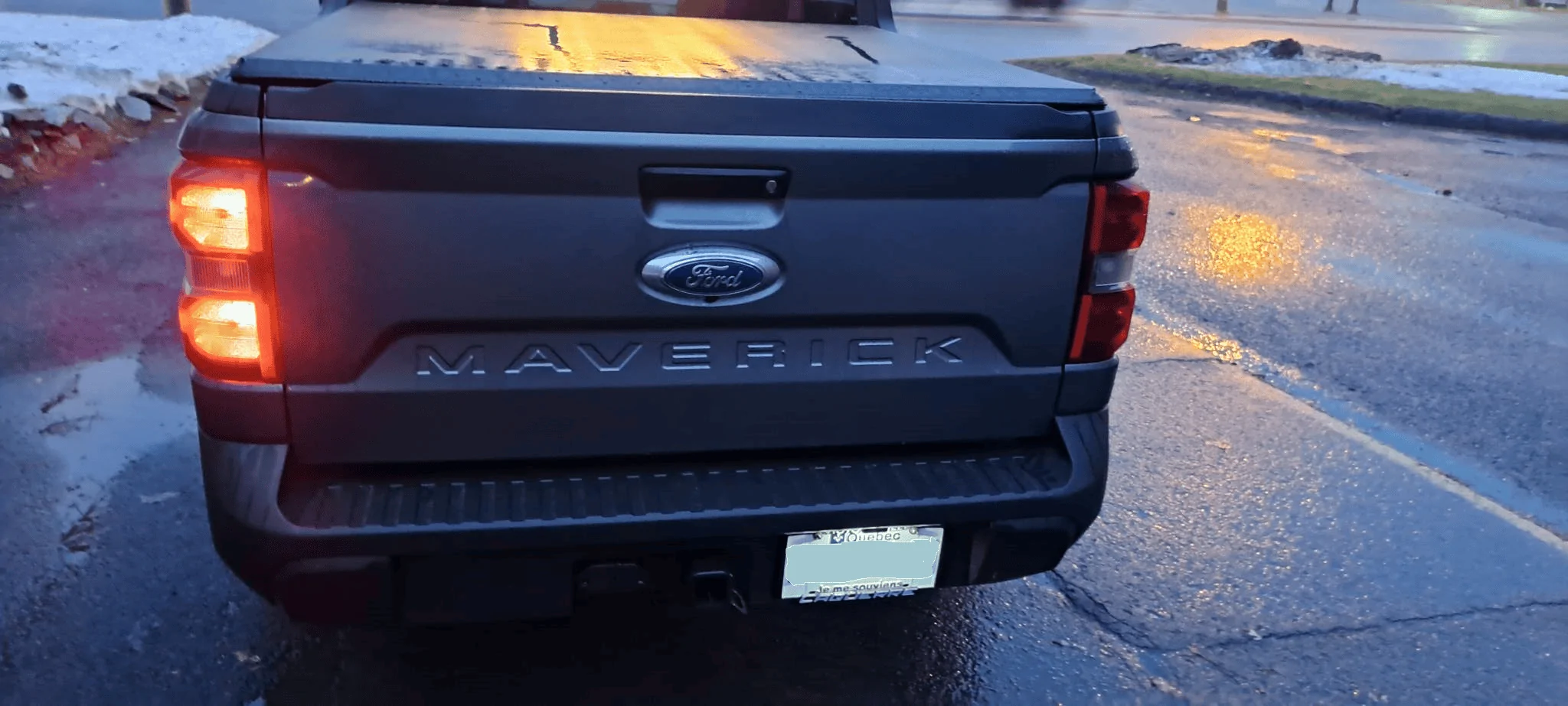

I did put Lasfit reverse bulbs in... but it had been already was acting up.
It is funny this morning I remote started the truck and the left tail light was lite. I unlocked the truck and checked the signal and it worked. I didn't have anyone around to see what happens when I put it in reverse to check the backup lights. Backed out of the driveway and now left is not working again.
I will put the original reverse lamps back in and check to see what happens.

I installed the original backup lamps back in and all is working now..
Thanks for the suggestions.....

I installed the Lasfit rear red turn signal on both sides. The right side works and is on while driving. The left is not. The lights work on left side when unlocking the vehicle. What do you all think?
I have the same problem with the rear right turn signals. This is after the update and after installing the updated Lasfit T3 bulbs. I put my old Lasfits back in but the turn signals still weren't working. Currently, I have one Lasfit T3 bulb installed and one original bulb installed. This fixed the problem, but the upper turn signal (original bulb) is a lot less bright.

Well that didn't last long..... Not working again. Made another appointment with the dealer.

My fix quit working also. Going to put all original bulbs back in the tail lights and see what happens.

You might want to look into contacting LasFit about sending you new replacement for those back-up bulbs (funny how we still call them "bulbs" when there is no bulb). I'm wondering if your first set are defected.

The dealer picked up my truck and left me with a new 2024 Edge ST-Line.... very nice vehicle. Returned it back and told me replaced a couple of pins in the light harness where the lamp assembly plugs. Two pins making a poor connection. Will say.... Great dealer service.

Well it is acting up again.. I was a good try... made another appointment.
