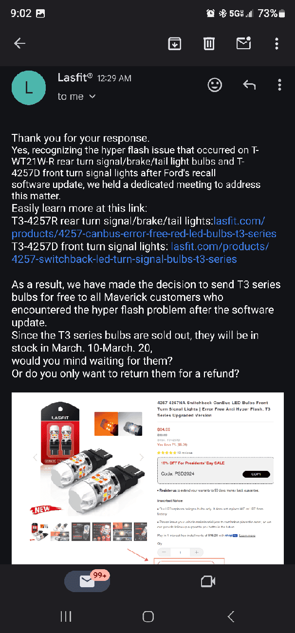

LASFIT is replacing the bulbs for anyone affected by the turn signal update that caused hyperflash. They didn't have to do this as I think it's not their fault, but I sincerely appreciate it. Just email them your order number or reply to the order email. I apologize in advance if this is a duplicate post. The ones I saw talked about discounts etc. But I've found it's free.
See attached screenshot for their reply.
Ford Maverick LASFIT hyperflash after software update - FREE replacement bulbs Screenshot_20240227_090255_Gmail
