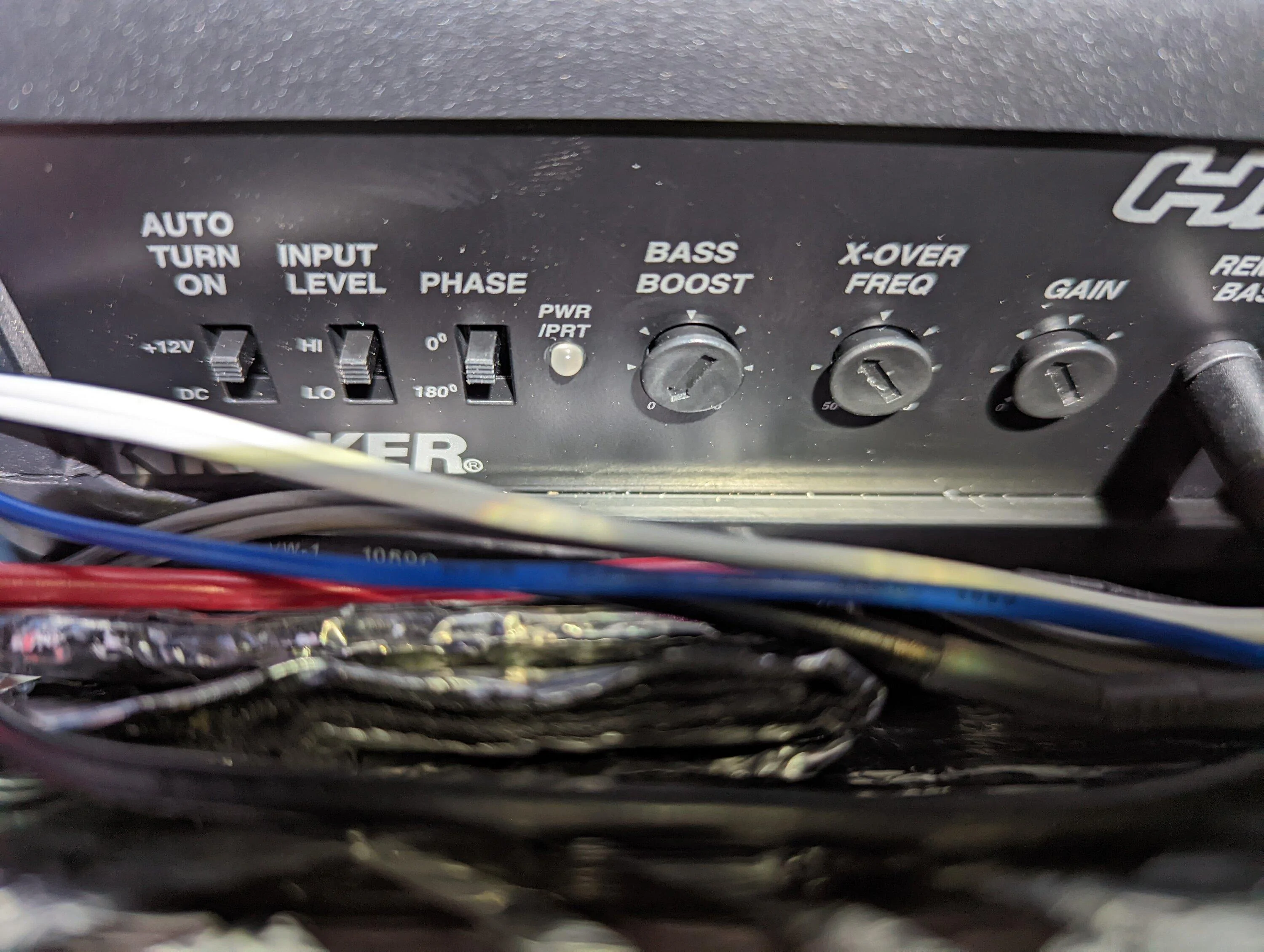

I have the kicker hideaway 8" under my back seat. Sounds great, I was quite impressed coming from two amplified 10-in subs in my last truck.
It blows my B&O 6x9 away. Mine is wired off of the sub speaker inputs to the B&O 6x9.I mounted the bass boost remote knob hidden above the wireless charging pad. I usually have it on about 1/3.
