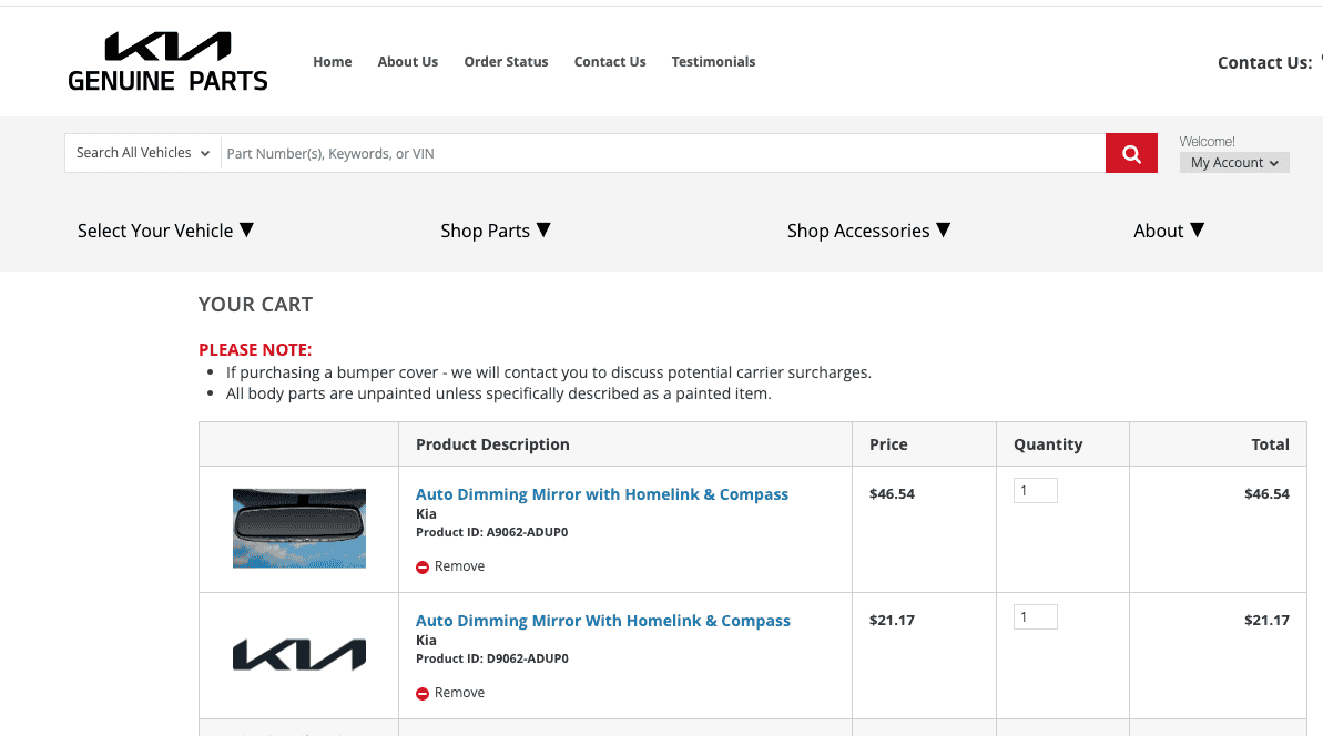

What’s the difference
A9062-ADUP0
D9062-ADUP0
Ones like $21 the other is $46

Thanks for the tip.
It is interesting that at the same site, they have two prices. Is this like Amazon with multiple sellers?
Shipping added $$10.97 to the price.
They have 2 different part numbers. Not sure the difference.
